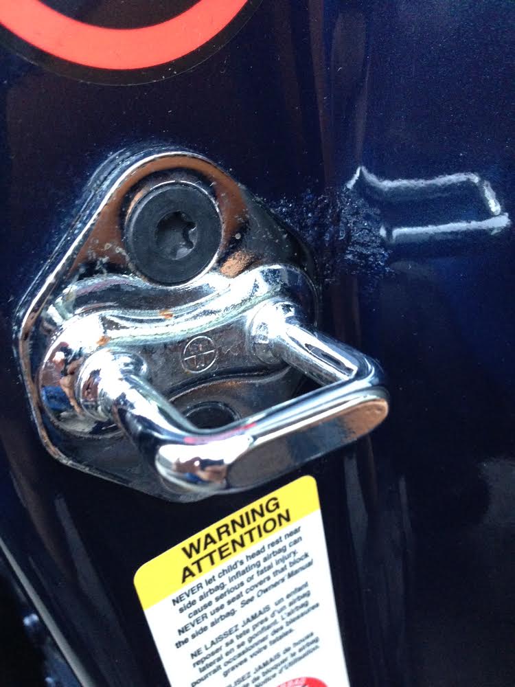

So I've finally got around to hand washing my XJL and I just noticed that there is bubbling on all four inside door posts where the steel door hinge attaches to the aluminum.

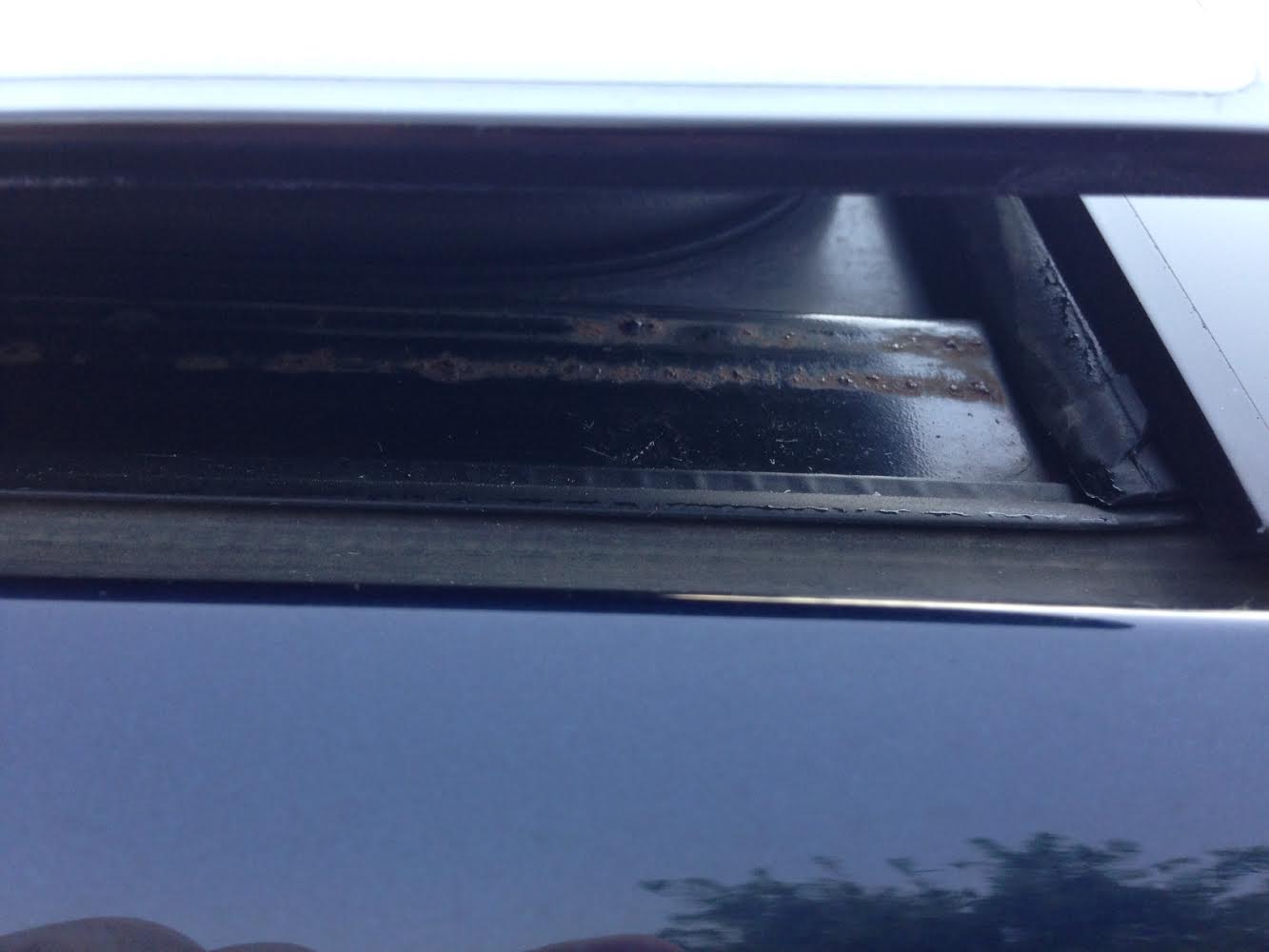

Also, I noticed small bubbling in the inside rails of the glass panoramic roof.

Hmm.... It all depends on how much salt spray your car is subject to and how much rain and industrial pollution falls on it. The hinge sounds like galvanic corrosion, due to steel being in contact with aluminium. I have to say I am surprised as this is so obvious a potential corrosion site that Jaguar would normally seek to mitigate the effect, usually by use of zinc plating on the steel.
Not having seen these roof rails it could be the same syndrome, steel/aluminium galvanic action. If you could post up a couple of pics further advice can be given. If it were me, I'd be down to the dealer, as you have a corrosion warranty with the car.
Aluminium can corrode quite badly give the right conditions, but is normally much more resistant than steel due to it forming an oxide layer very, very, quickly if the metal is exposed to air. It's where air is excluded, but water and salt is present that it can corrode quite quickly, and I have seen this on my own X350, the previous model to yours.

Here are a couple of iPhone pics I just took. The hinges are pretty much all the same (more or less) so I just took a pic of one. I've also attached a pic of the roof rail beneath the glass panoramic roof.
Your picture is not a door hinge, but what we Americans call a door striker plate. FYI, my 2011 XJL, which originally came from Florida, and which I purchased 10 months ago in North Carolina, has zero corrosion in these areas, or anywhere else. All in all, my impression is that Jaguar engineers did a superior job in preventing corrosion than in any other car I have owned (and I have easily owned 25 cars over the last 58 years). I can remember one large Mercedes V-8 sedan I owned where the hood hinges totally rusted away from the inner fenders where they were attached; which caused me to swear to never buy another Mercedes automobile for the rest of my life. Fortunately your covered by a strong warranty. Let us know how things work out. Good luck.

The strike plate! That's what it is! I was trying to think of the name of that part. Thanks for the clarification.

That bubbling on the sunroof part looks like steel corrosion and due to very bad metal preparation and painting, frankly.
The striker plate corrosion looks like classic crevice corrosion initiated by a paint defect or hole, and subject to damp retention and absence, (or little of), atmospheric oxygen. The corrosion site creeps along under the paint, drawing water in through the paint by osmosis. The only way to cure it to remove all corrosion produce then refinish, and make sure damp cannot get in when replacing the striker. I have nothing like this on my car, (the previous model to the X351), in this location, so I suspect it is a production error by Jaguar.
Thanks for the detailed reply, Fraser! I'm just baffled that the corrosion on the striker plates is happening on all 4 plates and no one else on this board has even heard of it!

I don't check this forum very often, but my 2011 XJ is going in to the dealers this week for two jobs, one of which is the same roof rails corrosion problem.

I also have the same corrosion problem on the side tracks of my sun roof.

Chaps, My rails were sorted by my dealer yesterday whilst sorting my roof noises, the components were refinished by their body shop and back to a nice satin black finish.
Hopefully will not happen again.
