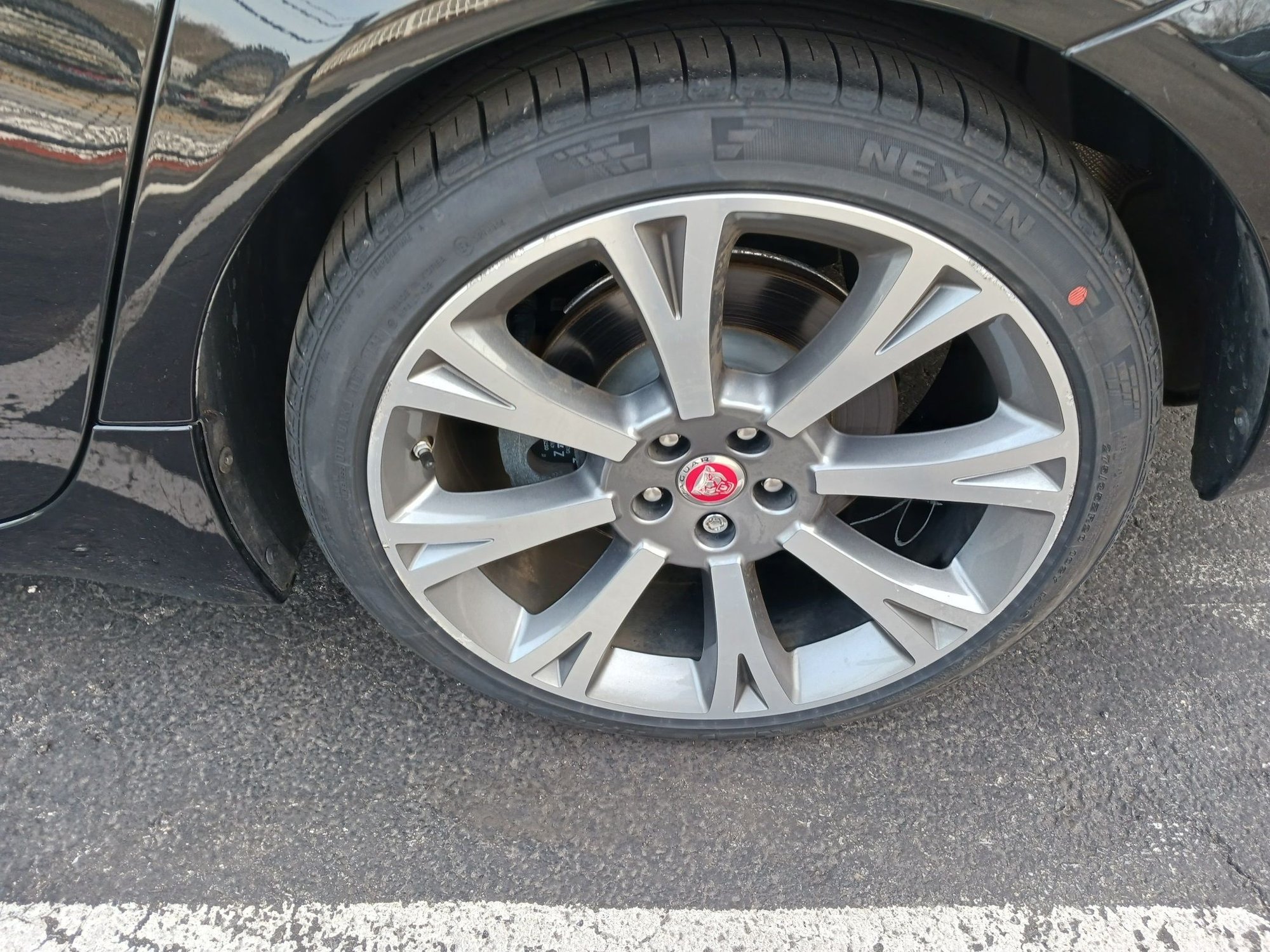

Cars with 20" wheels have a harder ride than 19" wheels.
This shows a 20".
