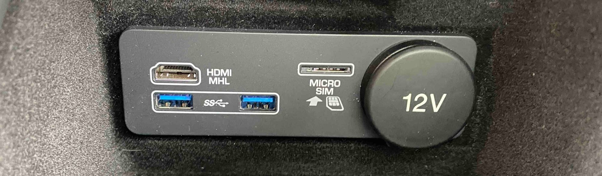

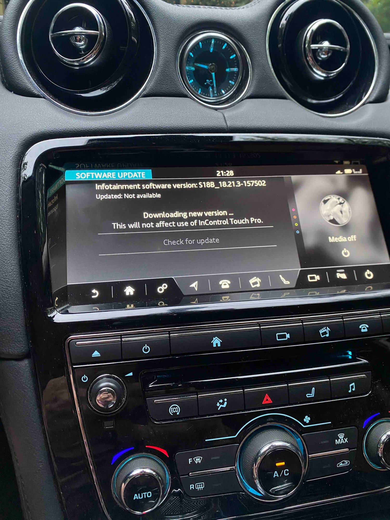

Sorry to use hyperbole, but, speaking as a newbie, my 2018 XJ seems to be the cursed in-betweener as far as its Incontrol Touch Pro software is concerned. I brought my car into my local Jaguar dealer here in the Netherlands to update the Incontrol Touch Pro software. It is currently on version S18B_18.21.3-157502. It has all the necessary hardware (see picture attached of the hardware inputs), plus it has the 10.2 screen with Meridian audio so it should update. Like many others, I particularly want the update so I can then install the smartphone package (for Carplay). And yet the dealer said that the car might not accept the update and the smartphone package because it was made in April 2018, while all XJs need to be from June 2018 onwards to accept it without damage. They're worried about bricking the TCU (‘telematics control unit’). Is that truly likely? At the moment the software thinks its updating via SOTA (update over the air), and is stuck is some limbo without being able to install. Why on earth would Jaguar fit an updatable software where the updates might kill the machine? (No need to answer that one!)
