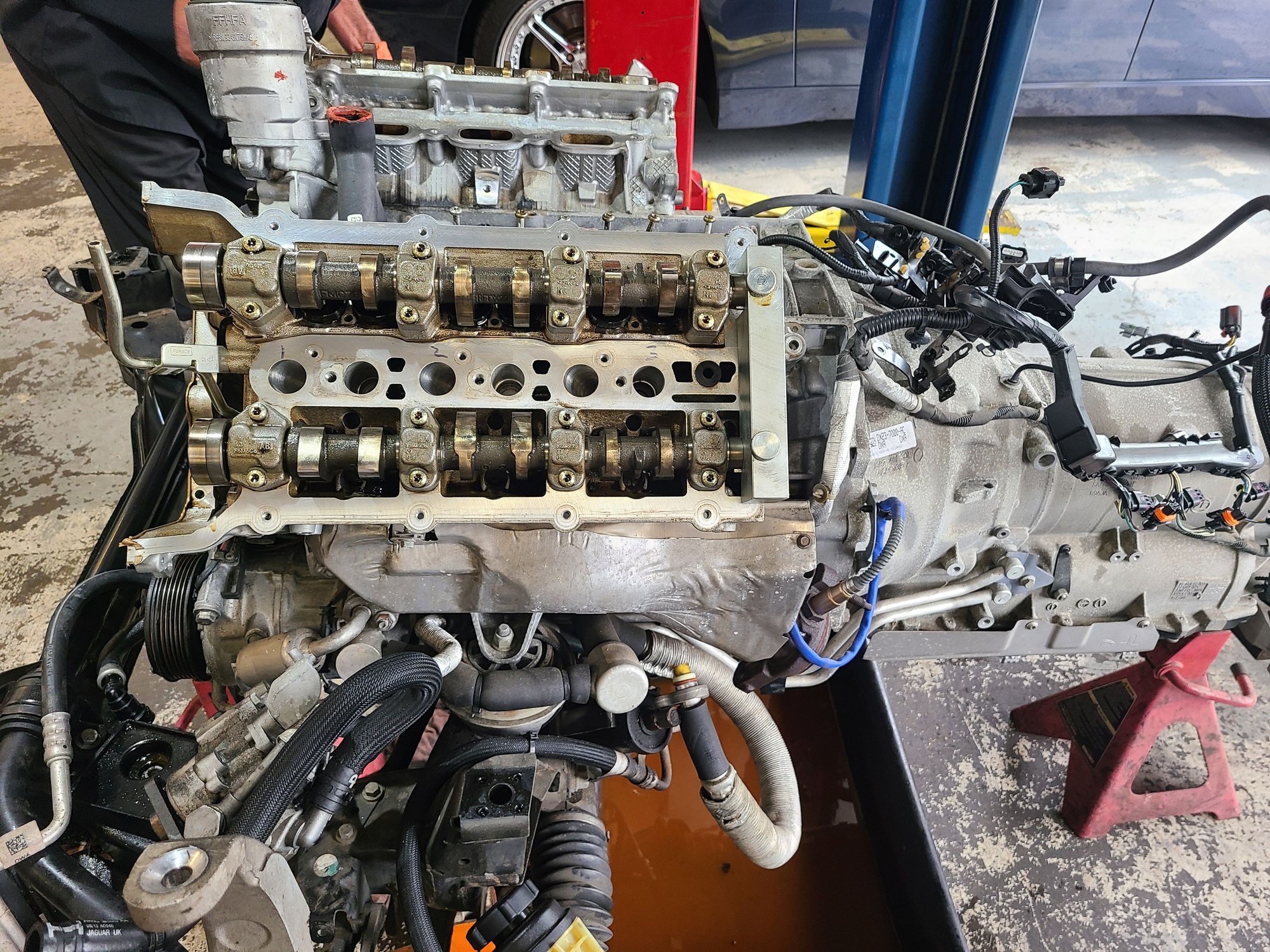

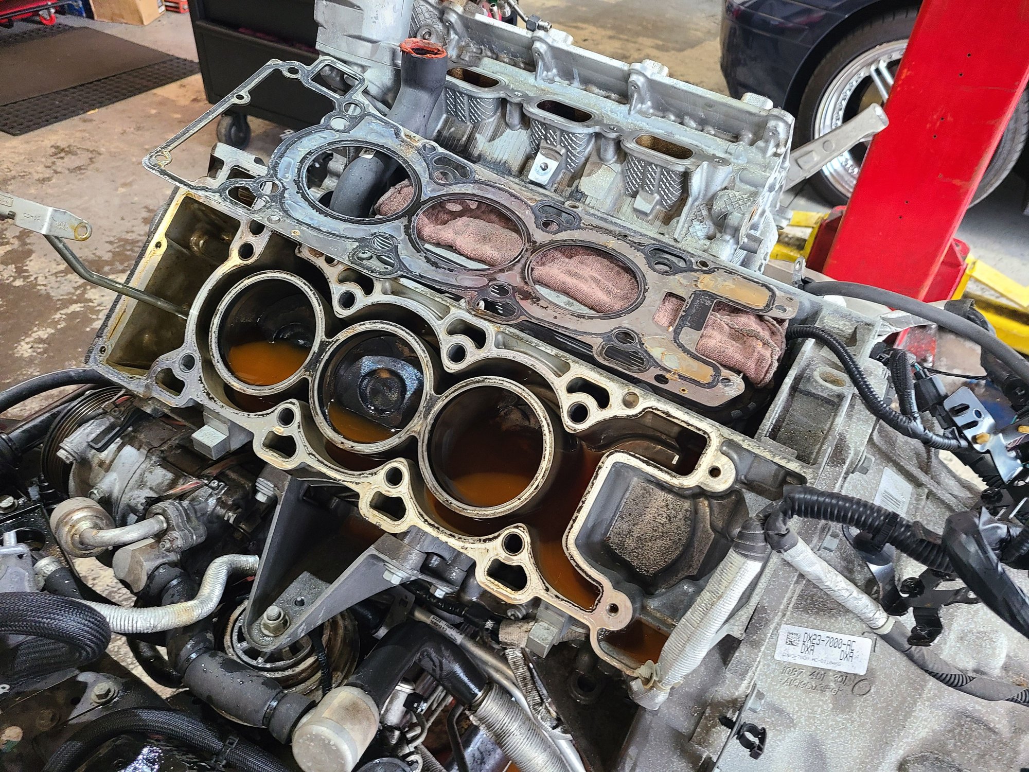

Here is what's involved with repairing an X351 with an overheated AJ126, cost 11,700$US. The AJ133 involves the same procedure:

In the pictures above, note the area on the head gasket for cylinder 6 where the head distorted allowing the gasket to fail. The reason this engine was able to be repaired is the cylinder walls didn't break apart at the top, and the block wasn't warped. The heads were machined, valves cleaned and lapped, new timing chain assemblies, and the aluminium water outlet was installed.

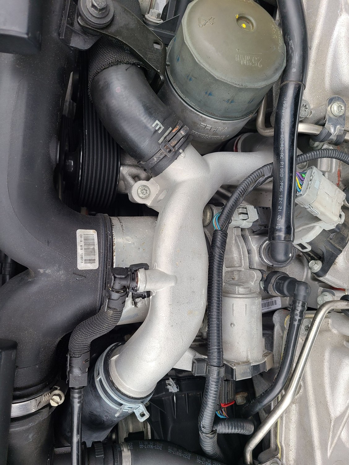

Here is the engine back in the car with the aftermarket aluminium water outlet fitted.

Yea I like the red neck RTV slathered all over the "Y" cooling pipe! Really shows the level of repairs that poor car had. Putting RTV on an O-ring connection.
