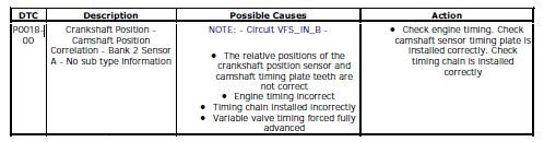

Code P0018 on the 5.0 litre is:
There are no extended codes (sub types) for this DTC.
It isn't something that is going to disappear for more than 2 "trips" with a code clear so I'd first suspect any of the following:
1. an out-of-range signal triggering the event
2. your code reader inaccurately reporting the DTC
3. partially discharged battery when the vehicle was started
