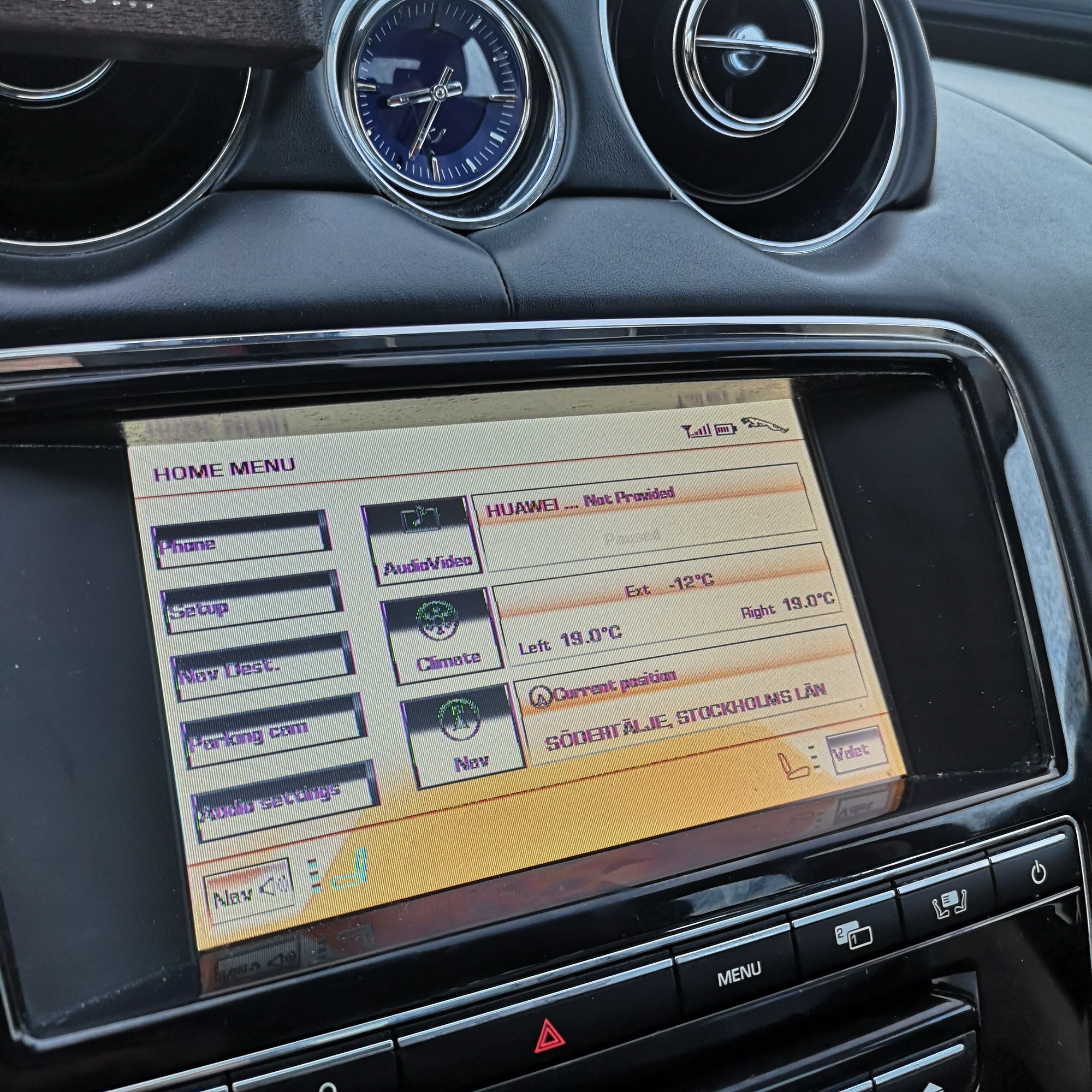

[size=16px]Hi![/size]
[size=16px]I'm experiencing a problem with my XJ 2010 screen the colors are pale when I start it in the morning when it's cold after 10-15 minutes it goes back to the normal colors has anyone in the group experienced this kind of problem or has hear about it before?[/size]

Humii: Incorrect colour on TFT display comes mostly that some signals between display controller and display are missing, or worst case an buffer chip inside of TFT panel have been failed.
You can try to remove the units from dash and dismount them for checking the wires/connectors of the display and IAM2.1 units. (IAM 2.1 unit are the DVD/HDD player under display)
If it dosent help check the model numbers and source used replacement units from eBay.
