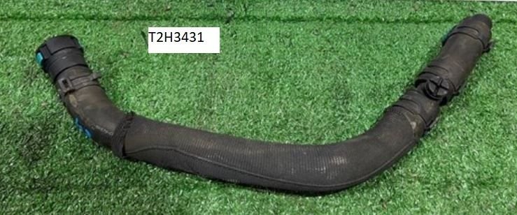

Did you replace the rear water manifold with the metal version?
I did when I removed all that ridiculous Symposer crap at the back of the engine.
Not exactly what you asked but there is a better rear heater hose assembly that connects to the rear water manifold. Simpler and cheaper as well.
This is the XJ factory hose with the terrible hard to get to attaching bolt. This bolt threads in straight from the back of the engine. I removed and installed it twice with the SC on and I hope to never do it again! It's a bit hard to see but this is the hose that has the bleeder screw in it on the passenger side of the engine.
This one was suggested by someone on the F-Pace forum as his mechanic for some reason figured it out and now installs it regularly on all the Jaguar's that go thru his shop. No bracket or bolt! Plus it's about $30-$50 instead of $140 for the big crappy one with the metal bracket. It's what should have been installed from the beginning too.
But Jaguar never goes back so no parts manual will show this hose to fit anything earlier than about a 2017 F-Pace.
Looks like you got the correct thread with that brass one. M14-1.50. Only problem I see is there are not many threads on the brass one so not sure it will reach all the way up to the threads in the radiator? The factory plastic drain plug is flush after it's screwed in.
