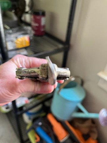

Got it loose. Mine was so tight it bent my nickel! But better than breaking out the plastic on the plug!

Holy crap! Who would've believed that rubber could bend a nickel???!!! I'm glad you got it sorted, though! Good luck with the rest.
