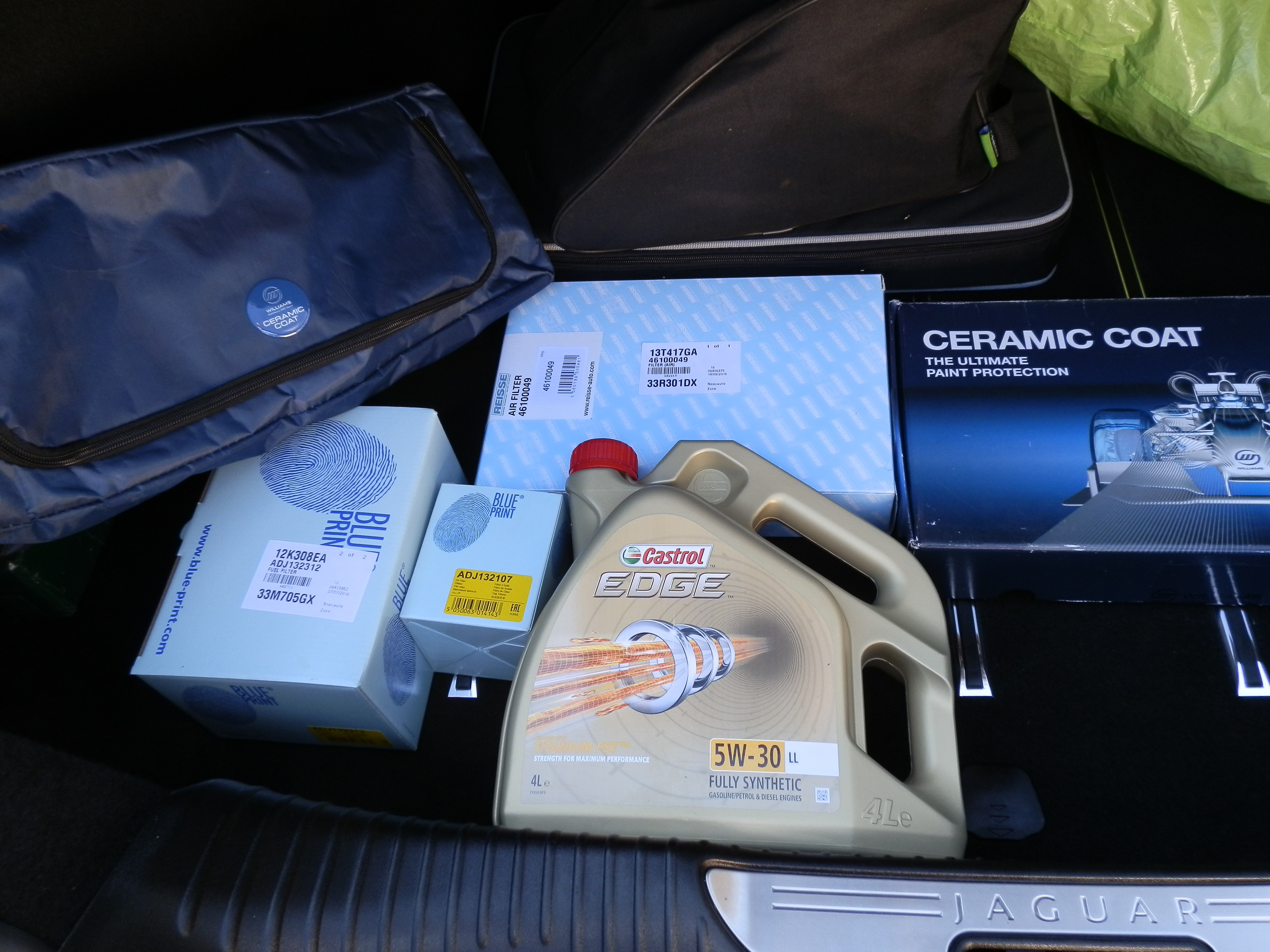

Hi again, I am in the motor trade and bought the oil,air and fuel filters for my new addition and the oil also which is Castrol Edge C1 with fluid strength technology. Oil was £60 and the filter were £37. Not bad considering the main dealer charged the P.O £105 + vat for the oil alone. Any comments about the oil or the filters? Any advice much appreciated as the service is not until Friday and I can change anything you see in the boot.

ArtyH, I would ask the Indie which way they plan on changing the oil. I know this sounds like a strange question, but there are actually 2 different ways to change the oil in this car. You have the traditional way which is pulling the plug on the bottom of the engine. The trick with this is that to get to the plug, you have to pull the aerodynamic skid plate off the bottom of the car. This plate is roughly 1.2M x 2M in size. It comes off with about 15 fasteners. Not impossible, but may not be something that they are familiar with. The second way is if you remove the oil cap on the top of the engine, you will see a small tube sticking up inside the engine. This tube runs all the way down to the bottom of the oil pan. You can connect a vacuum pump to suck out all the oil and then put in the new without ever having to get under the car.
You can get the OEM oil filter on a place like E-bay for much cheaper. I recently got the OEM filter for $18 USD delivered to my house. It can be even less if you are willing to get say 6 filters at a time.
One question I do have about the oil though, I only see 5 liters of oil. The car is rated to take 6.5L of oil with the filter replacement. hate to see you be a little short on the oil. I find when I do the oil changes on my car, I put in 7 quarts (6.5L) and it takes the oil level right to the Max mark by the dash indicator.

Chris,
You're in the USA and are describing your XJ with the 5.0L gasoline-powered V8. Note that ArtyH is in England and his XJ has the 3.0L diesel engine, which was not sold in the USA. I think your comments about the oil capacity and filter don't apply to his car.

Stuart, I keep forgetting that we have cars from around the world here and that some have the perferred (to me) 3.0L diesel engine.
Granted, looking at the shop manual for the 3.0L engine (2010 model), it does have the vacuum tube so both methods of oil removal are still applicable. Also, the manual states that the oil capacity for the engine is 6.6L for a oil and filter change.

Hi Thermo & Stewart S, thanks for the info! The pic only shows one can of oil, I bought 2x 4ltr cans, the other is a bit further into the boot Thanks for the heads up for the methods of draining the oil, I am sure my guy will remove the aerodynamic skid plate, he is very good at his job. I was thinking of adding some Extralube ZX1 to the engine, anyone else used this before? I had it in my Mercedes 350 CLS and it was very good at making the engine sound quieter.
