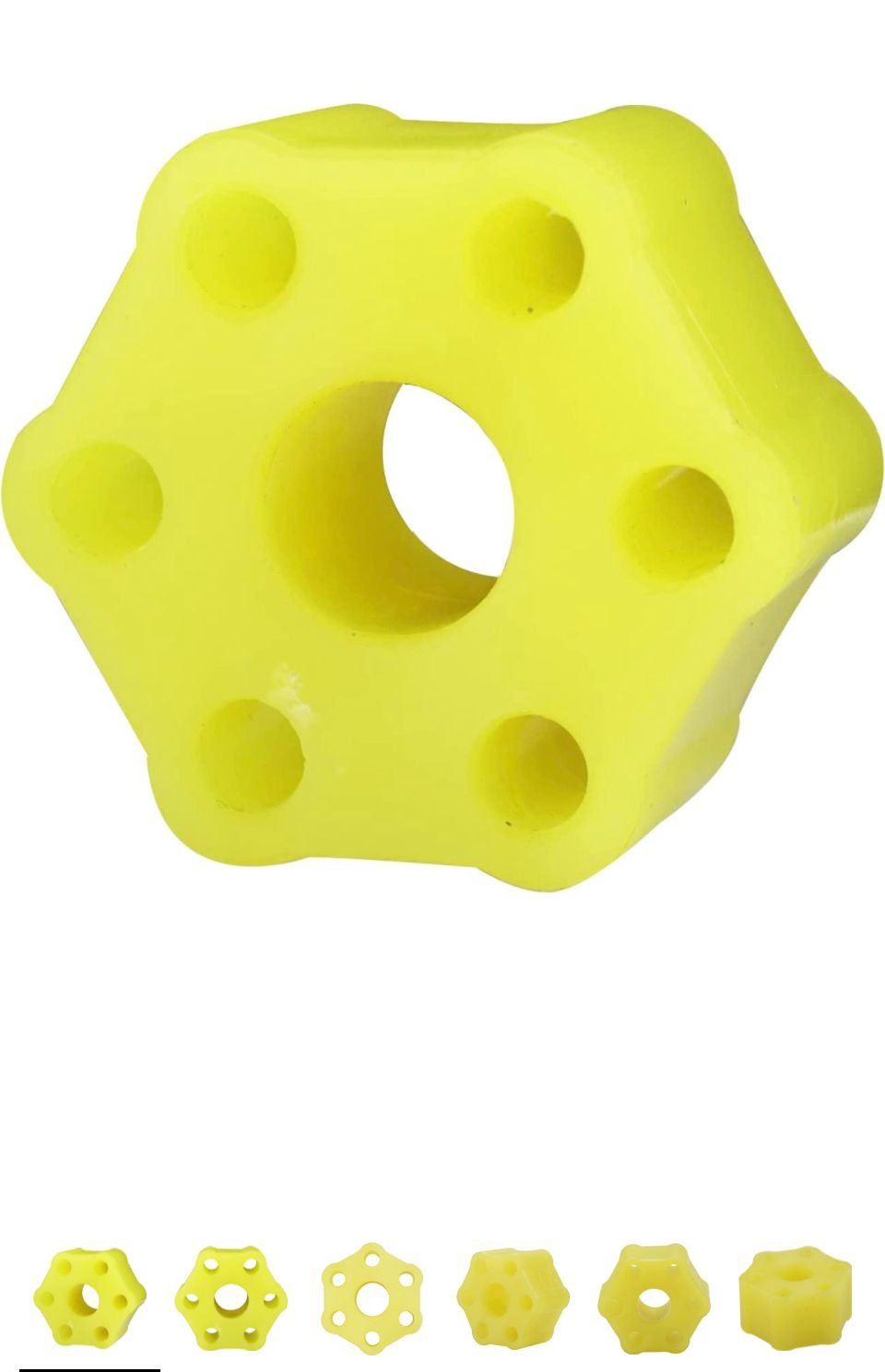

Hi everyone,
I have read some on here about the solid oil-filled nylon supercharger isolator for the 5.0 engine. However, it clearly says that 3.0 Petrol engines require a different part. I found this on Amazon as an alternative to the spring isolator. Has anyone done this modification on the 3.0?

Hi , we're did you read on here that they are "different " I really can't see this being true as they more or less the same engine and the solid plastic one that you show is used on both the 3 litre and 5 litre f type cars same engine as the xj

Hi George,
Actually I went to buy this one getting ready for a SC snout swap this spring. But the item description from multiple sellers says that the darker green with raised circles is only for 5.0 engines.
SUPERCHARGER COUPLER ISOLATOR OIL FILLED NYLON FITS JAGUAR RANGE ROVER LAND 5.0
Condition: New
Type: Coupler
Brand: Aftermarket
Fits : Jaguar Range Rover Land 5.0
Description:
Aftermarket Oil Filled Nylon Isolator (Coupler)
Direct replacement for the spring loaded noisy isolator in your
Land Rover Jaguar 5.0 Engine supercharger
Does not fit 3.0 liter engines
These solid isolator are direct replacements for the original spring isolators

Hi Griff, ok I get it now on the link you provided, to be really sure I would ask over on the f type section the guys and gals over there will definitely know if you can use that on the 3 litre engine as many have replaced it
