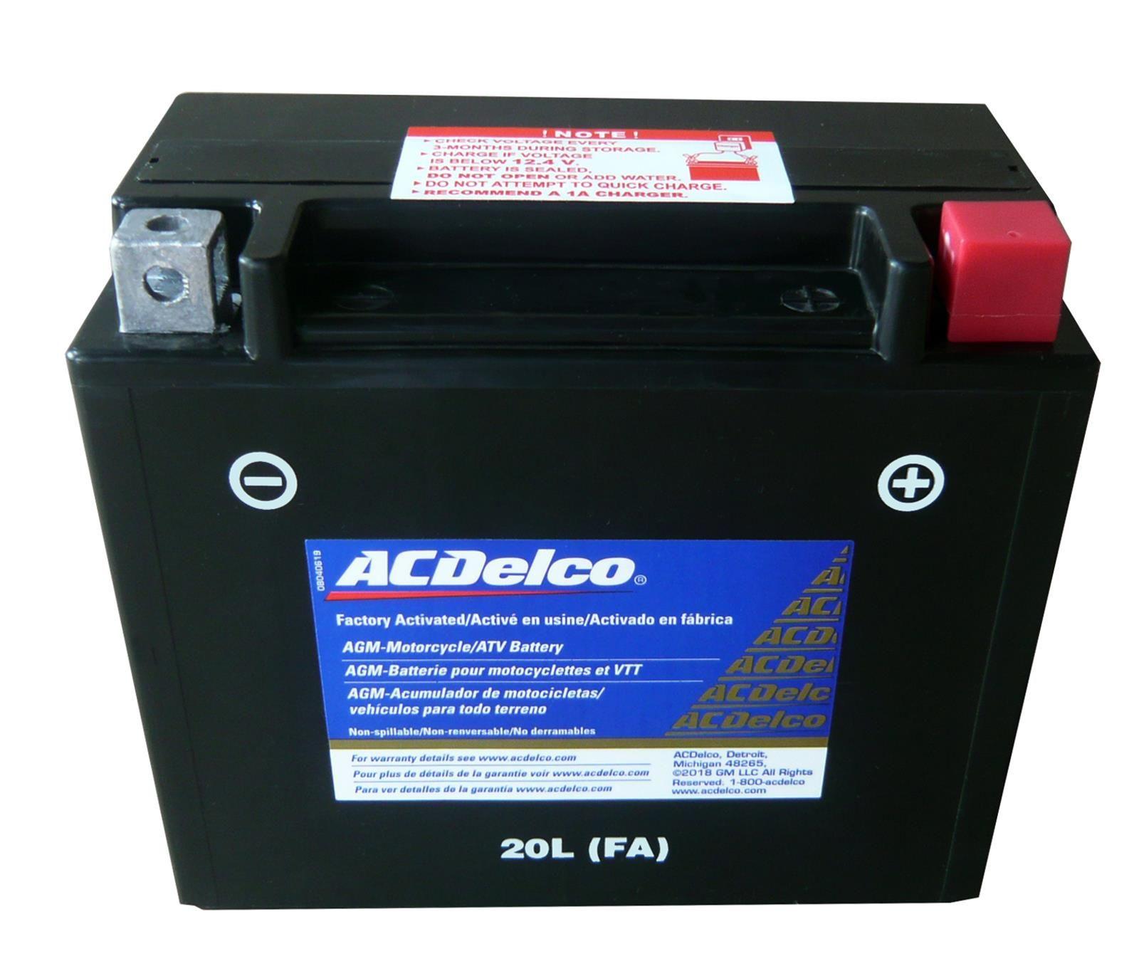

Had a heck of a time trying to find this battery for my son's 2014 Evoque. I ended up using a ACDelco AUX-12 AGM auxillary battery in place. I saved 200 over the price of the Land ROver4 battery. The only thing we had to do to make it fit was cut the cable ends from the vehicle and crimp on eyelets to fit the new battery ( 15 min job eyelets are 1.00 ea.) The AUX12 now has a different style of hook up, threaded hole included on the terminals
