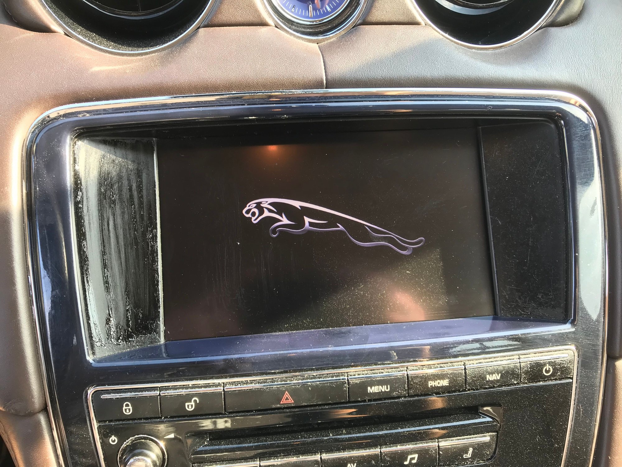

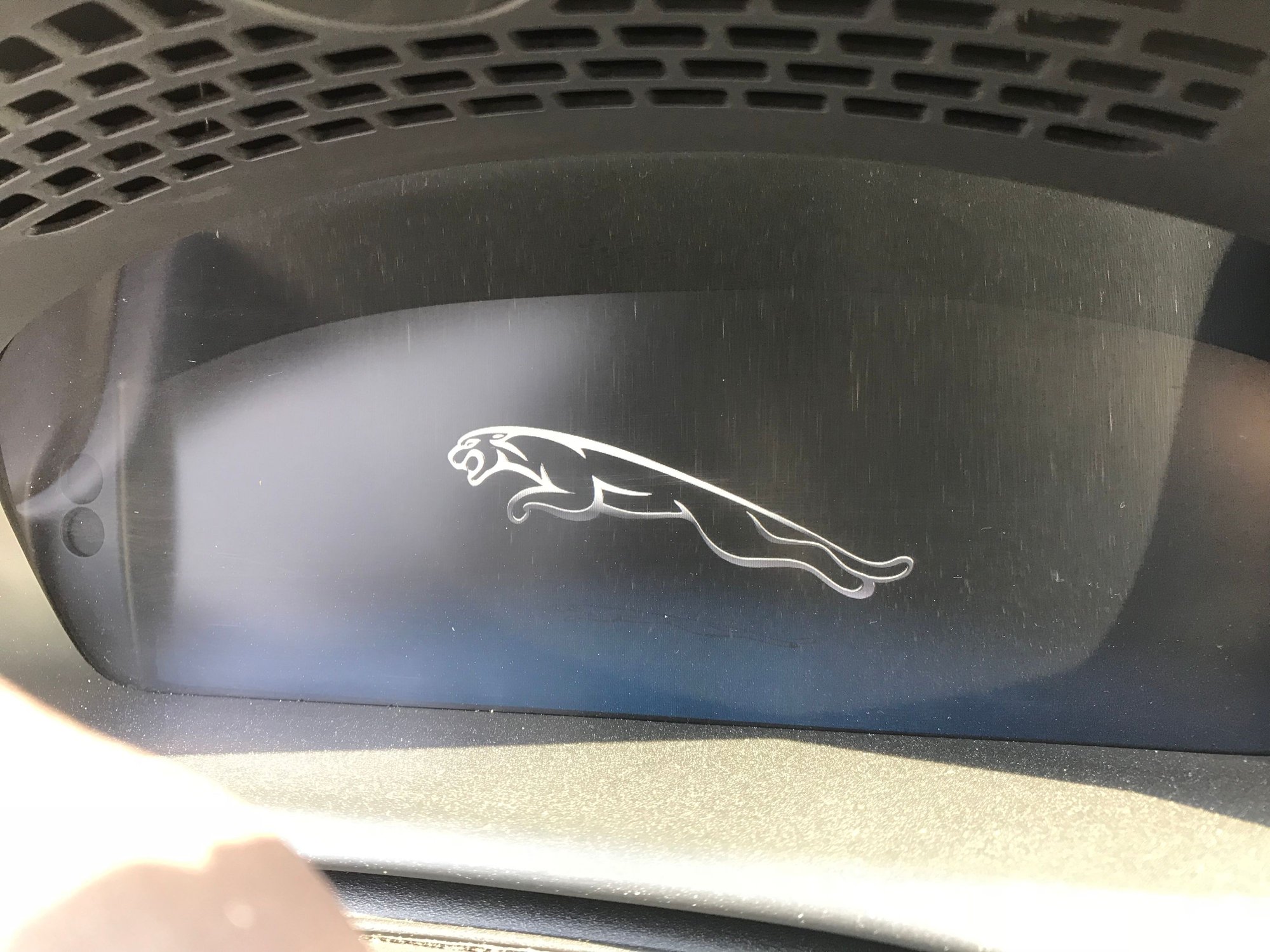

Default Small step in this history 😊
After connection the missing parts I have some good news
