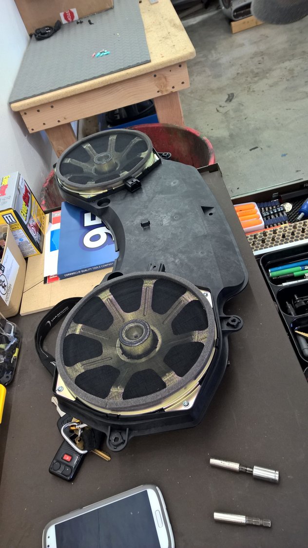

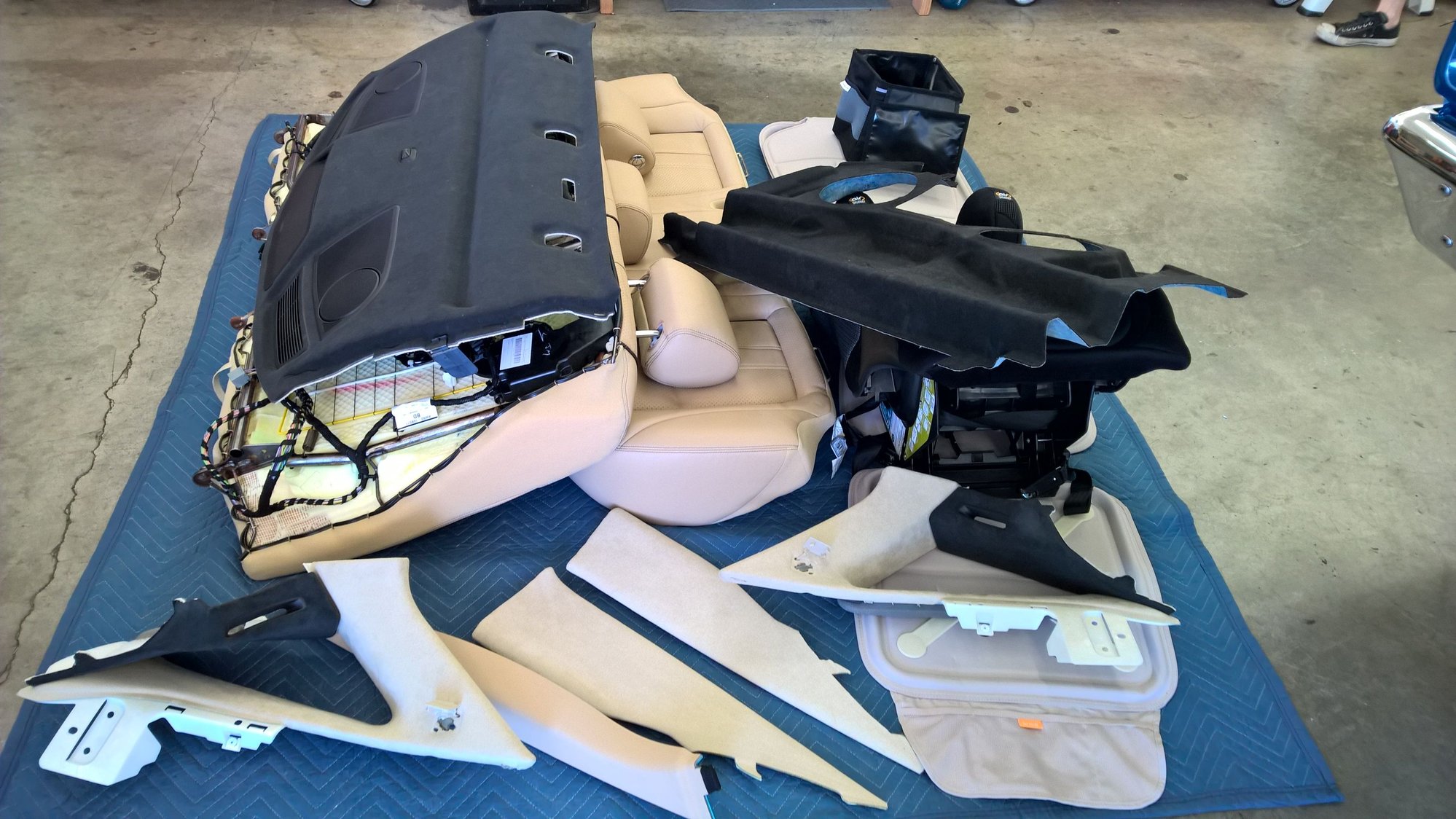

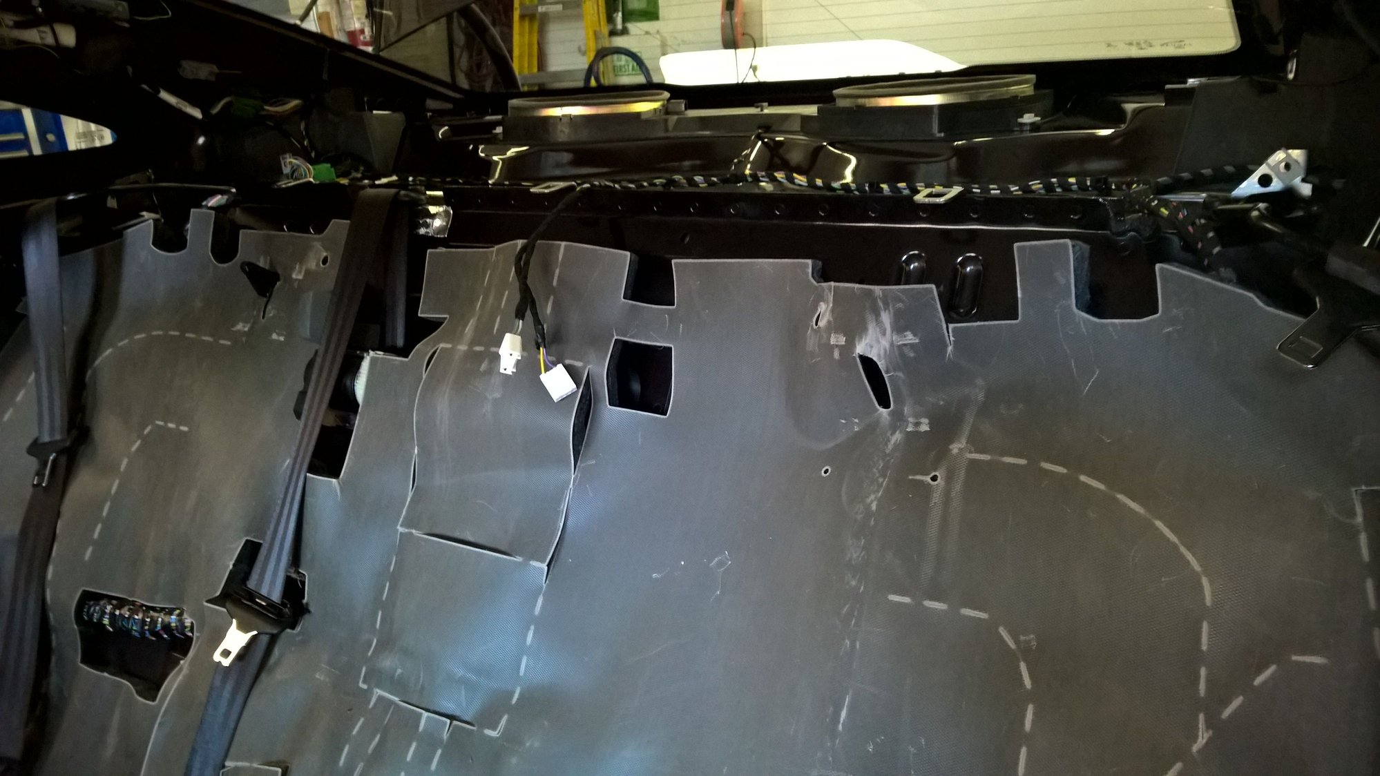

Ok. So I spent the whole day in the shop today. As UH2 said, it is a PITA to get to the factory subs and its opening. it involves removing the back seat, then removing the side panels and two back panels before reaching the shelf and removing the subwoofers.

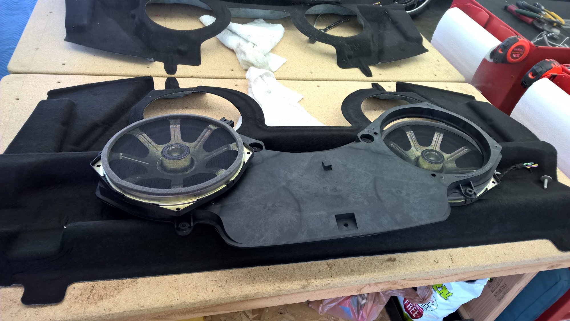

The factory subs are super shallow and light. They are meant for low power applications. We tried to fit in ARC Audio, Kenwood and a Alpine, all of which do not sit into the basket.
Basically none of the readily available subs would sit in that basket so you can just replace it and add amp to it. One exception was german maestro sub, however it is more like the factory sub so its not worth it to replace it.
So here is what I did. I left the subs out, took out the shelf and inner lining so there is nothing to rattle and wired the subwoofer lines to trunk.

Here is everything that has to come out to get to the subs
The back when we got to the subs
The subs. Light weight super shallow. Someone should try earthquake sws cos it may fit better.

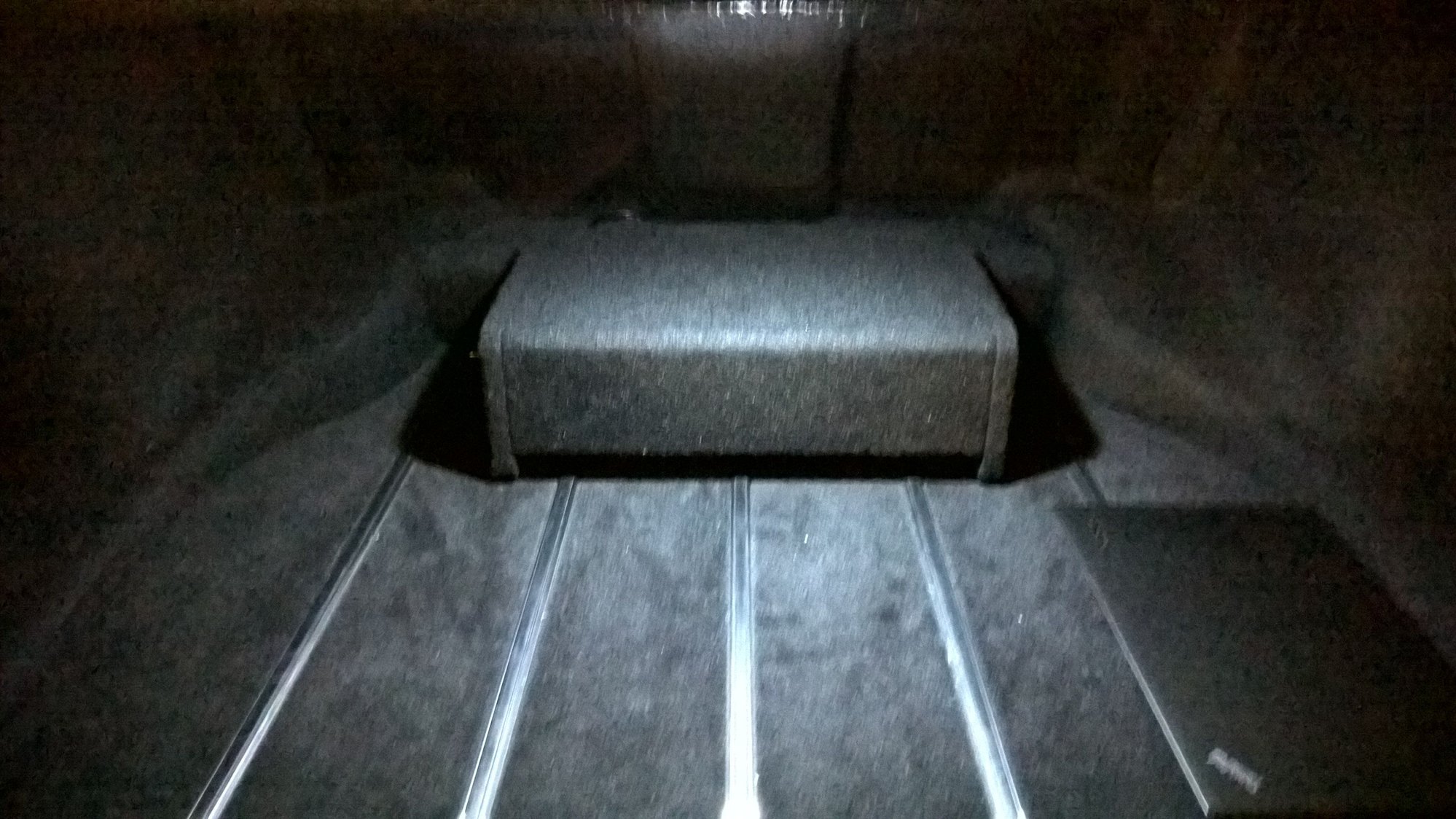

I have two of them. Will post pics this evening. One is a downfiring 10" box with a Rockford P3 Subwoofer and the other is a Kicker Solo Baric Square.
But basically once I ported it, any subwoofer would fire into the cabin just as fine. I did one thing though, I removed all the additional trims underneath that would rattle which makes it clean .
Just a quick note to all. So I tried a few boxes.
1. Sealed - if you use a sealed box, the downfiring is not a good choice lke I have in the picture. The bass gets lost before it comes to cabin, use a side firing.
great if you listen to a lot of rock music
2. ported - best choice IMHO for us, the ported solo baric kicker has a good response range when the filter is set to 125 hz. I listen to a lot of heavy beats so this is a good choice.
