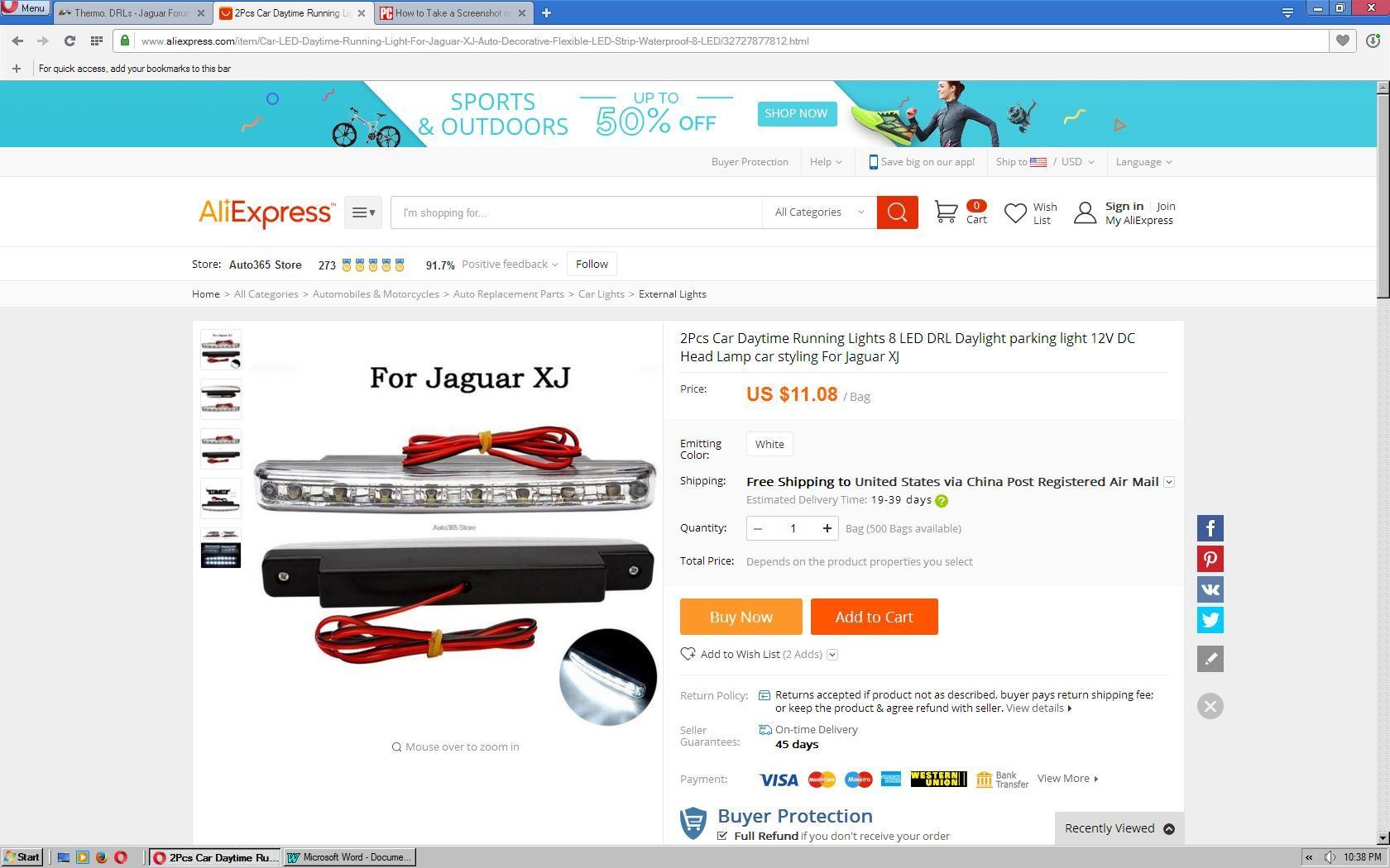

Browsing around AliExpress.com, I found these DRLs. Will they really fit our X351 model XJs? At $11.08 a pair, delivered, they're cheap enough to see if you can modify them to fit.
https://www.aliexpress.com/item/Car-...c-788e86ca8cd0

Stuart, how do you see yourself mounting them to the car? If you are looking at mounting them in the lower brake duct area, that may be a little more involved than some may be willing to do. Not impossible, but once you start modifying, it will be a no return thing.

If I was interested in adding DRLs (which I'm not at this time), I would see if they could be flush mounted inside the horizontal chrome trim in the lower brake ducts. I suspect that trim is plastic and can be easily cut and trimmed with a Dremel tool so that DRL assembly would look factory, with only the LEDs protruding out of the front of that chrome trim.

As for mounting the LEDs, I was looking at the center chrome piece too. You would probably be better off removing the clear plastic off of the front of the DRLs you were looking at and then drilling a series of holes that would match up to the LEDs on those lights. Granted, at that point, it would probably be easier to get some 90KMCD 5MM LEDs and wire up the LEDs yourself. The circuit is simple and if you got some flat top LEDs and painted the back of them silver, you probably wouldn't even know the LEDs were there until you turned them on. This is along the lines of what I was thinking with the 10MM LEDs (mine would be 285K MCD), but I would paint the back of them black to match the black plastic, making them blend in with the vents.

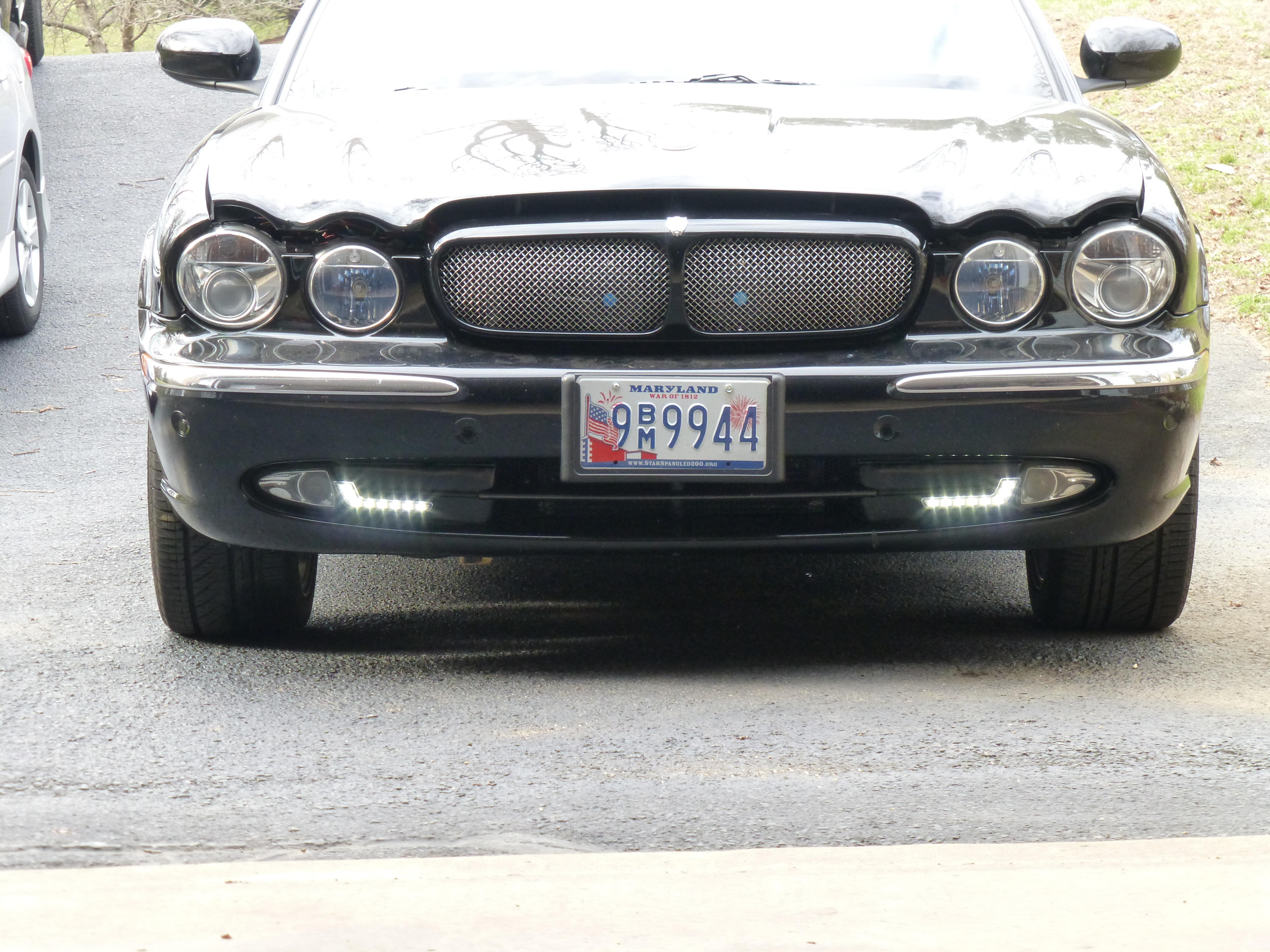

This is what I did on my 2005 XJR.
