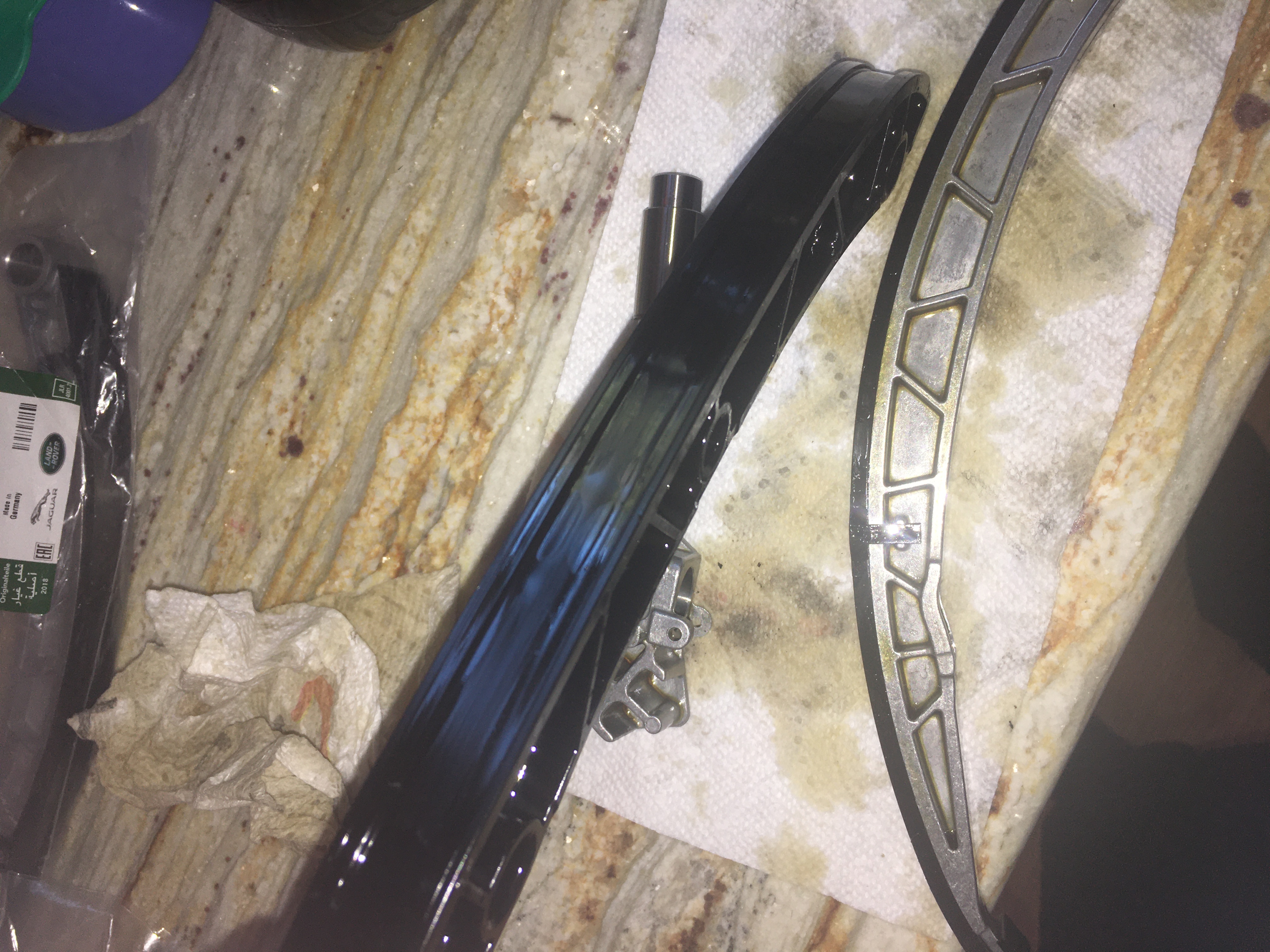

Old piston operation
Old Lever and guide.
Attached Thumbnails Timing chain tensioners and guides, stuck on PS pulley and Crank hub.-1bfe353f-61ef-48b5-a488-3dbd543af3aa.jpeg   Timing chain tensioners and guides, stuck on PS pulley and Crank hub.-56383248-9a32-403a-b085-bf92d5f4a406.jpeg   Timing chain tensioners and guides, stuck on PS pulley and Crank hub.-7834f080-f61e-4cff-a895-d1bf5d7a7989.jpeg

Good deal. It’s for the best to go ahead and change them I suppose. You did have the original tensioners and levers. Yeah, let us know what happens. I had one tech at the dealer try it that way and it didn’t end well. So I just decided to never do it that way.
Also, make sure when you pull the pins on the tensioners, take a flat screwdriver and pry the levers away from the tensioners until you hear a faint click. They had to update the process a few years back because the tensioners weren’t catching the first tooth to keep it from slacking off when oil pressure bleeds off.
