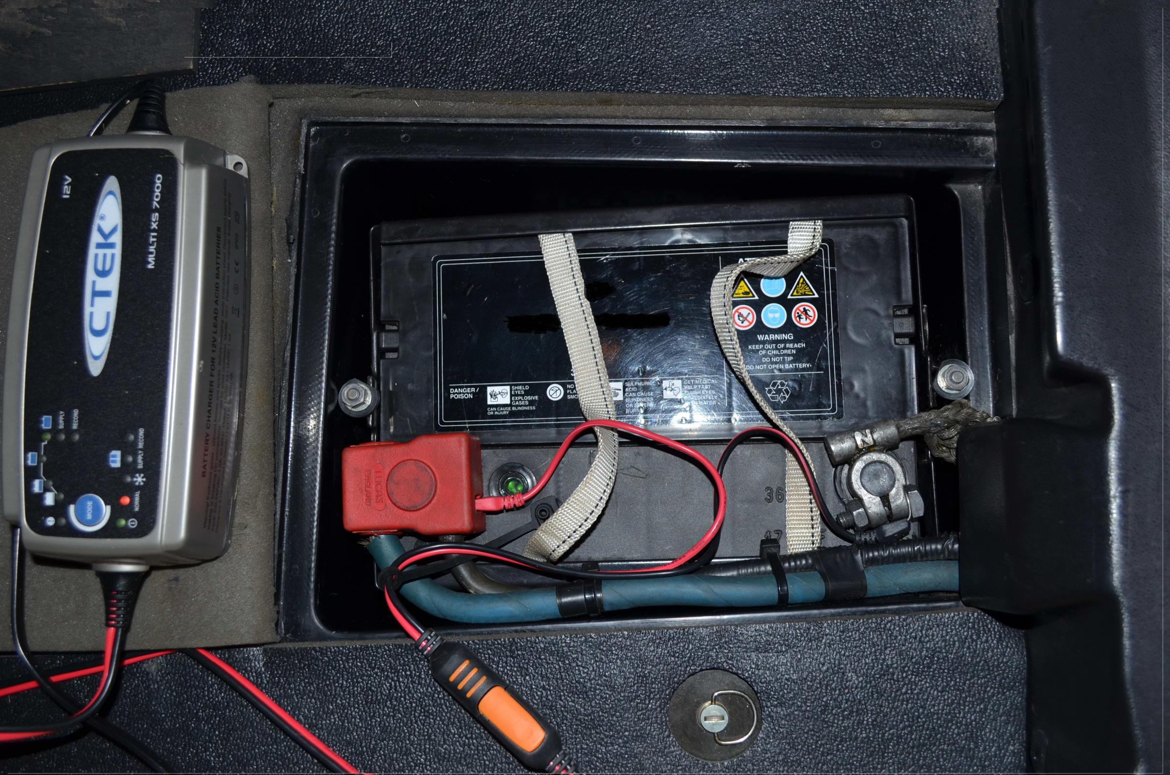

The 2-Pin Connector permanently wired to the battery makes connection/disconnection quick and easy:
Which trickle charger / battery conditioner-ctek_3untitled.jpg
Had no trouble with the CTEK 7000 in over three years and never had a flat battery.

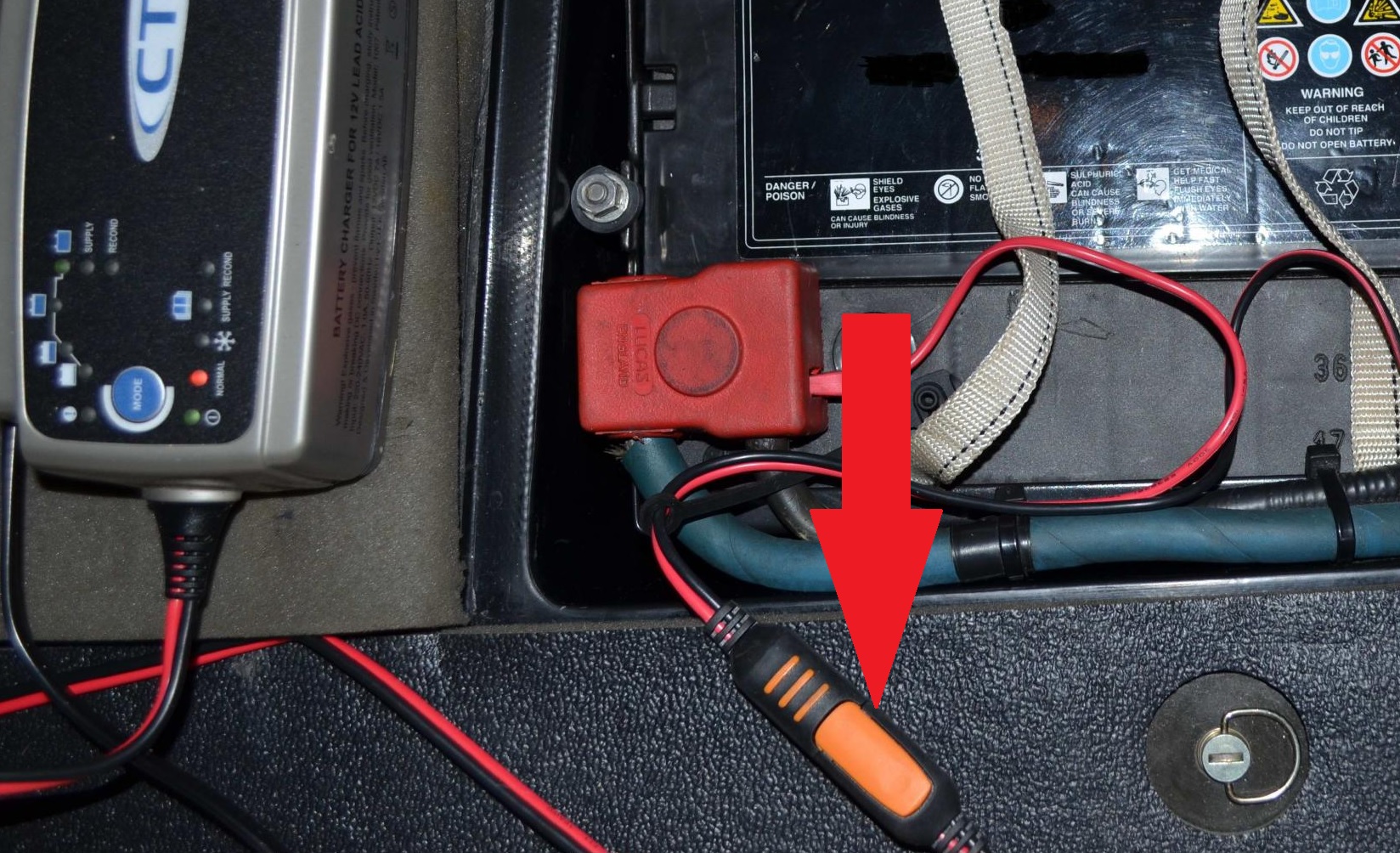

Thanks for the pic, where does it disconnect from? The part in the bottom middle of the picture? The 'chunky' part of the wire?

Yes. The black and orange piece is a two pin connector.
Which trickle charger / battery conditioner-ctek_2.jpg
It comes apart in the middle leaving the end with the flying leads permanently connected to the vehicle.
