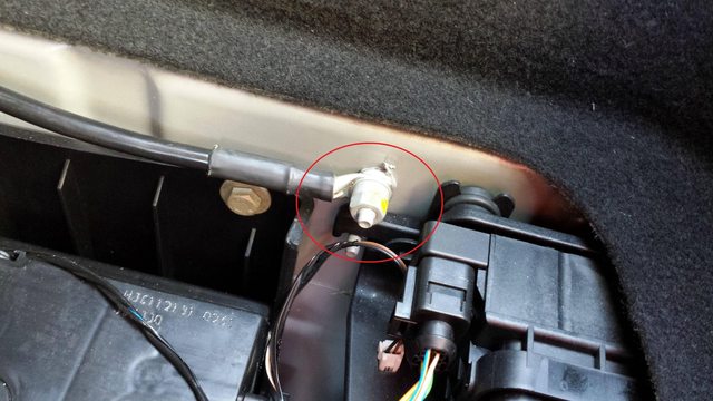

And I've bought the 5.0 and an extension lead for the low-voltage side
Didn't need any terminal adapters as the positive terminal on the battery has a smaller 'sub terminal' attached to it, don't know the technical term
But about the negative, I'm sure I'm right in saying it needs to be earthed to the car... Is this a suitable place? This black cable has 'AC' written on it on a sticker but by looking at it and reading the manual, I'm fairly sure it is an earth point... Just wanted to check. What do you think?
I know I might have issues with that bolt being too big for the crimped terminal, but I'll investigate that once I've got the stuff delivered

You could use that terminal if you wish. I prefer to hook mine up directly to the battery terminals.

I thought you shouldn't do that? Same as when jumpstarting a car?
The Jaguar dealer actually said that previous owner had a similar charger fitted like that but they advised against doing it that way
Old Jul 15, 2013 | 04:07 AM
jimbov8's Avatar
Posts: 2,069
Likes: 666
From: Uk
The cars body is basically an extension of the negative terminal of the battery.
If you choose to use a ground point and that point works loose or is dirty/ corroded, then you could end up drawing more current to charge the battery leading to possible damage in either the battery or charger.
My CTEK is hooked up directly to the battery and I have never had any problems.
You do what you think is right, it works either way.
Old Jul 15, 2013 | 05:39 AM
JAG_XJ's Avatar
Joined: Jun 2013
Posts: 82
From: UK
Alright thanks

Just a point about where to connect the earth wire to, with the new shape XJ there is a battery monitor system, if you connect the earth direct to the battery terminal then the monitor cannot detect the battery is actually having any charge going in, this then causes the Low Battery indicator coming up on the screen.
By connecting the earth to the bodywork of the car the monitor can detect the charge and is then able to monitor the charge going in.
Hope this helps.

I've connected it to a bare metal part of that black 'AC' cable I've posted a pic of, there's a part where it is attached to the car and bare metal is visible so I've connected it there
Tested the charger quickly and it seemed to work, haven't left it on for a while yet as I just want to be around the first time I use it to make sure everything is okay

Spoke to my Jaguar tech yesterday on where to hookup a tender. They suggested one lead on the battery and the other off the spare tire restraint bolt.
May be a little weird to wire in such a Y, but should work.

What I went with in the end was positive on the battery, and the bare metal point you can see in my picture in the previous post (above left hand side of the battery, on top of the Jaguar sticker)
Jaguar list a 'Battery Charger Kit' for the X351 which is a CTEK unit badged as Jaguar. The fitting instructions enclosed with this kit are:
X351 - Battery Charging Kit.pdf
Illustration 3 on Page 5 clearly shows the recommended connection method:
Which trickle charger / battery conditioner-x351-battery-charger-kit.jpg
Whether you purchase your tender from Jaguar or CTEK, the connection locations used should be the same.
