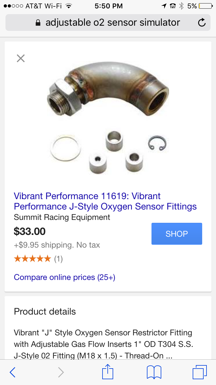

Will this work? This has adjustable gas flow going to the o2 sensor.

You are expelling gas at a higher rate and the rest of your exhaust is not modified. You should really get a tune to work out those bugs. Seems like the Bosch ECU cannot compensate for the extra flow with the stock file.

It's been mentioned many times but i'll put here again, do not put spacers/extenders on your downstream O2 sensors. The downstream sensors are also used to manage fuel trims, attempt to trick the sensors and you will have a heap of trouble...
Like this stack of codes...
P219A Bank 1 Air-Fuel Ratio Imbalance
P219B Bank 2 Air-Fuel Ratio Imbalance
P0137 O2 Sensor Circuit Low Voltage (Bank 1 Sensor 2)
P2096 Post Catalyst Fuel Trim System Too Lean (Bank 1) <<== hello!
P0420 Catalyst System Efficiency Below Threshold (Bank 1)
P0430 Catalyst System Efficiency Below Threshold (Bank 2)
If you just fit cats and do nothing all you get is the P0420 and P0430
As for why the P219A and P219B are still sticking around, you probably need to do a "hard reset" aka leave the battery off for a while, or do the "full vehicle reset" routine with SDD to get rid of them.
