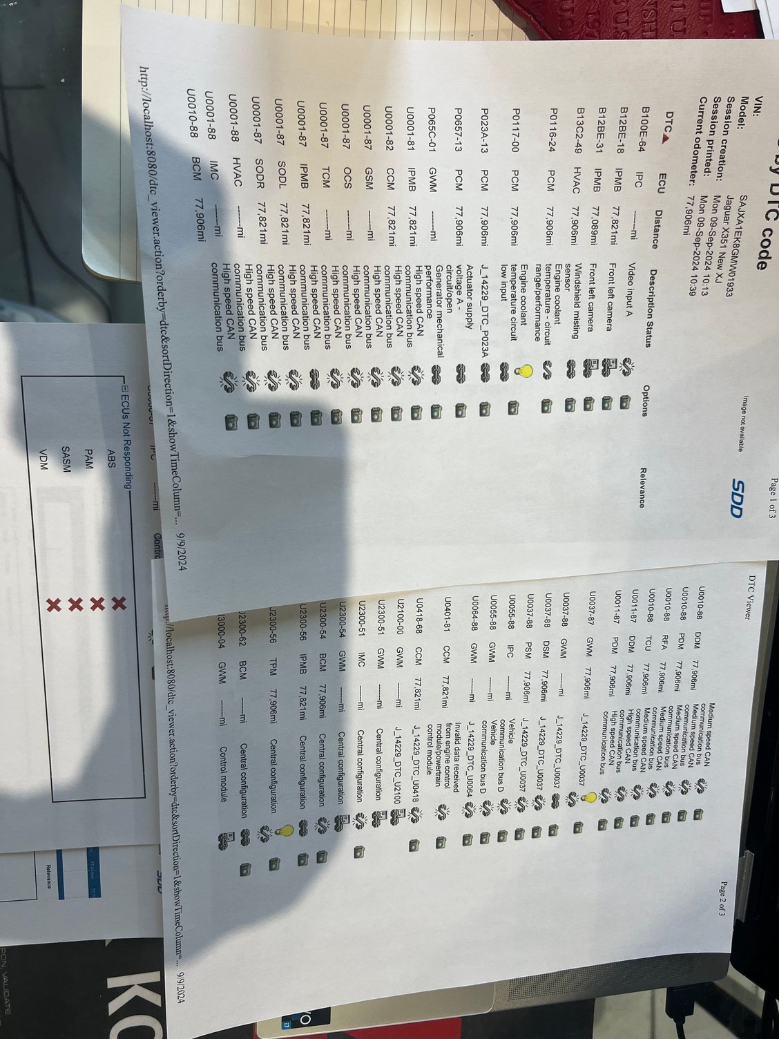

I had zero lights before the coolant line blow up now after I fixed it my abs light is on , stability control etc etc is on. Not to mention the check engine from my coolant line debacle. I says it’s not readings the abs module PAM, SASN, VDM Is there a process I should do in SDD to go in and fix or remedy the issue? Any help would be appreciated.

Do a vehicle reset in SDD and then re-read the codes. How's your battery charge level?
