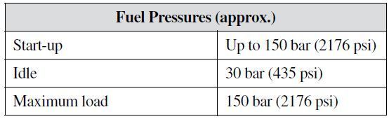

Should be fine for starting.
Here are the fuel pressures from Jaguar 5.0L engine manual.
So nowhere near 250 bar!!
He have an 3.0L Diesel. Totally different pressures.
