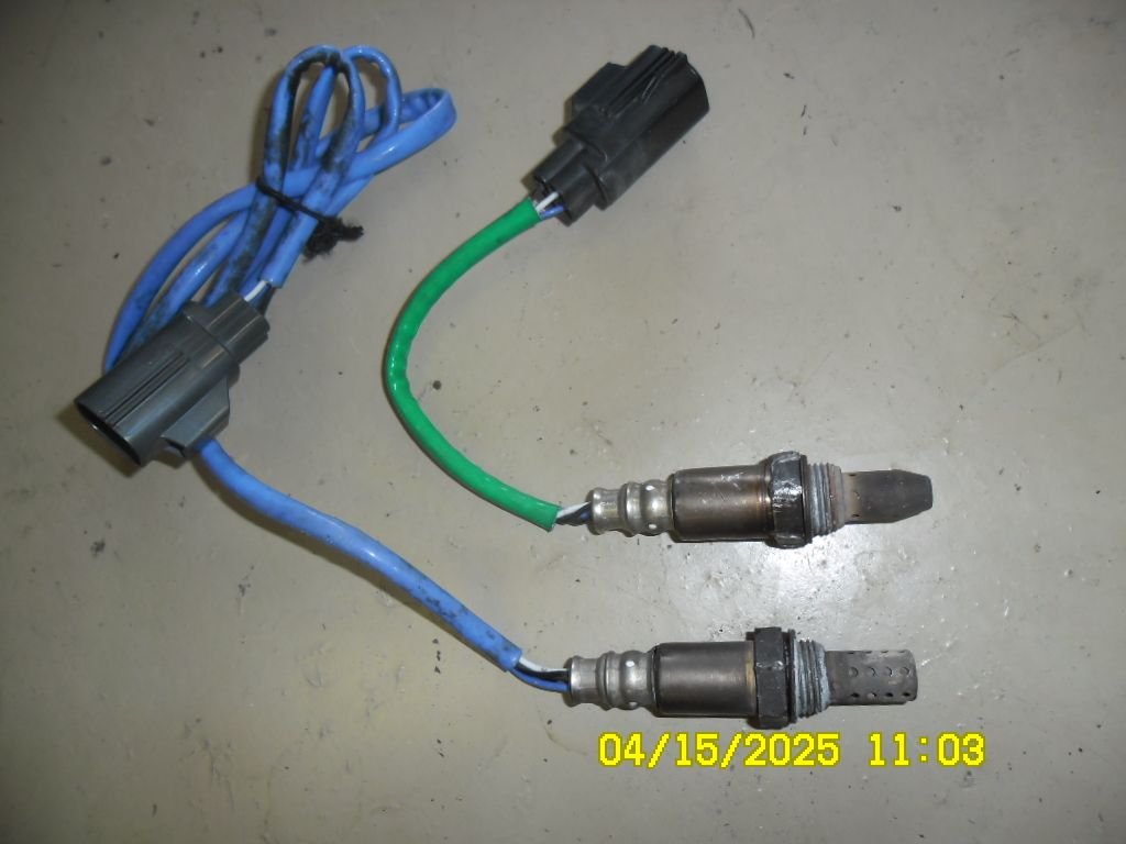

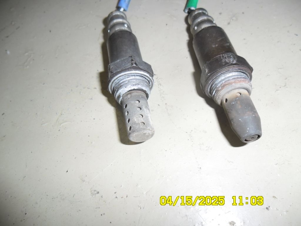

While it's true the side-to-side sensors are identical (at least for those of us with RWD XJs), I did find that the upstream (sensor 1 of each side), mid-stream (in the middle of the cat assembly) and downstream are not all the same with just different cable lengths.
The upstream were shown in Jaaag_drivah's other post where he graciously shared his experience (and custom tool design) in the pic of the upstream sensors he shared.
These are pics of the ones I removed from the AJ133 in my Land Rover, and you can see the shorter cable & different sensor on the upstream and the longer cable and different sensor probe on the one from the middle of the cat.
As far as with the AWD configuration, I think you might have the best luck talking to the parts counter at your local dealership.
