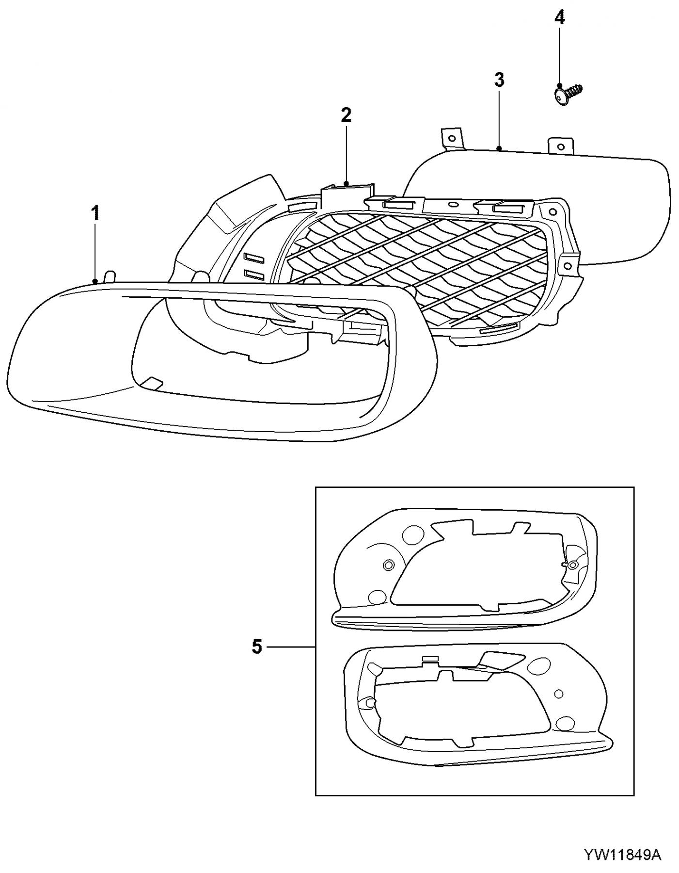

According to the parts catalogue, the XJR lower grilles are in separate pieces
Left side
Chrome finish moulding C2D25658 (1)
Black mesh C2D25655 (2)
Blanking Panel C2D25656 (3)
Right side
Chrome finish moulding C2D25657
Black mesh C2D25653
Blanking panel C2D25654
There is also something called a Template Kit C2D27986 (5) not sure if you need that or not, probably because there is some cutting of the bumper?
Click on the pic to enlarge
EDIT
The Ultimate Edition inserts are the same part numbers as the XJR
There is also a "Front Bumper Aero Splitter VMAX" listed in there, which is a 3-piece front splitter / bumper extension, the central part is gloss black and the outer pieces are painted body colour, also from the XJR?

Thanks Cambo351! Time to google these parts, shame they are in 3 separate sections, I'll try to find out from my local dealer if they can just remove the chrome bit on mine and only replace the front chrome piece

Perhaps items 2, 3 &/or 4 are shared with XJ models, so one could re-use these parts. Just a thought.
