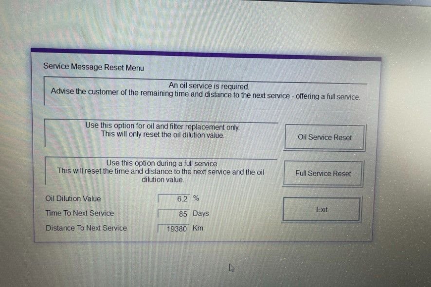

Yes if you want to reset the service light there are a number of factory and aftermarket scanners that will do it.
I use SDD but that is a pain. The cheapest I have found is an Autel HT200. Very surprised a $50 item could do it too!
Reset Service Light on XJ
I don't see it for sale anymore so must have been updated? Yes it's now the Autel AP200 and the price has risen to about $70 which I think is still the cheapest scanner that can do the reset.
Autel AP200 Autel AP200
