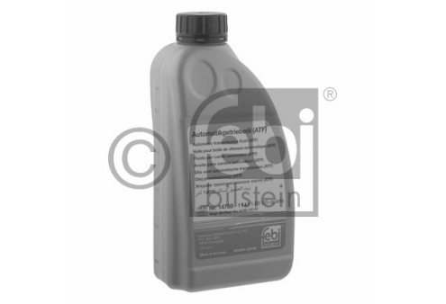

i found febi oil for bmw.
can any one tell me if this is good?
  • מפרט :
    VW LT 71141, MB 236.11, Toyota PSF EH, BMW LA 2634, ZF Lifeguardfluid 5, BMW ATF 4, Honda PSF-S, Hyundai PSF-3, KIA PSF-III, VW TL 521 62
  • מקט יצרן רכב :
    SKODA: G 052 162 A2, SEAT: G 052 162 A2, PORSCHE: 000 043 207 00, PEUGEOT: Z 000169756, OPEL: 19 40 707, MERCEDESZ: A001 989 22 03, JAGUAR: JLM 20238, CITROEN: Z 000169756, BMW: 83 22 0 002 121, AUDI: G 052 162 A2
or this one:
TRANSMISSION OIL ATF2 FEBI 2 1L ZF 6HP YELLOW 34608
  • מפרט :
    Ford WSS-M2C938-A, Jaguar Fluid 8432, BMW ATF 2, ATF M-1375.4, Mercon SP
  • מקט יצרן רכב :
    AUDI: G055005A6, LAND ROVER: TYK5000050, ASTON MARTIN: 4G4319A509, ROLLS-ROYCE: M-1375.4, HYUNDAI: o40000C90SG, VW: G 055 005 A1, PORSCHE: M-1375.4,

The only oil we know that is approved is Lifeguard6 and Mercon SP. Can you find any Mercon SP? It much cheaper and easier to find in the US than the special Lifeguard6 oil.
You can take your chances with those other oils and they may work fine but the two I mentioned are a sure fit. I see you do have one that mentions Mercon SP and I would feel safe using that one.
