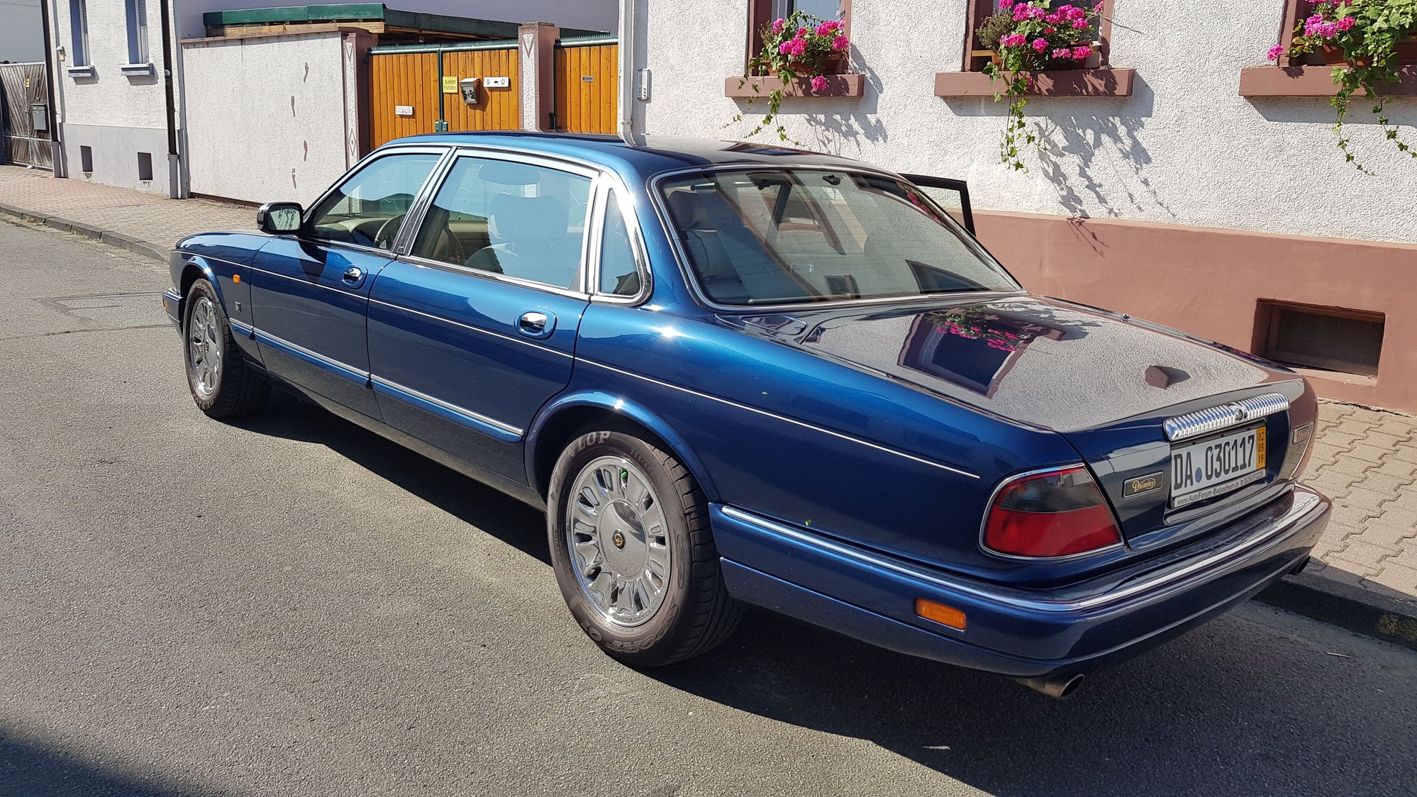

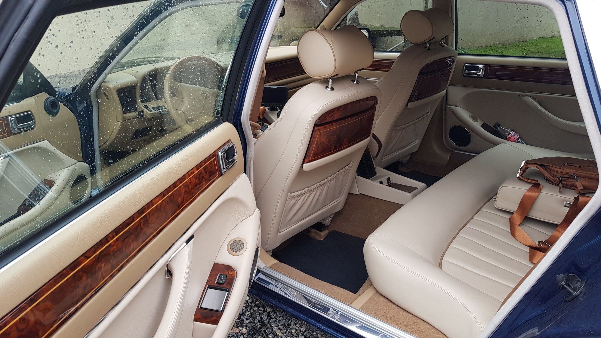

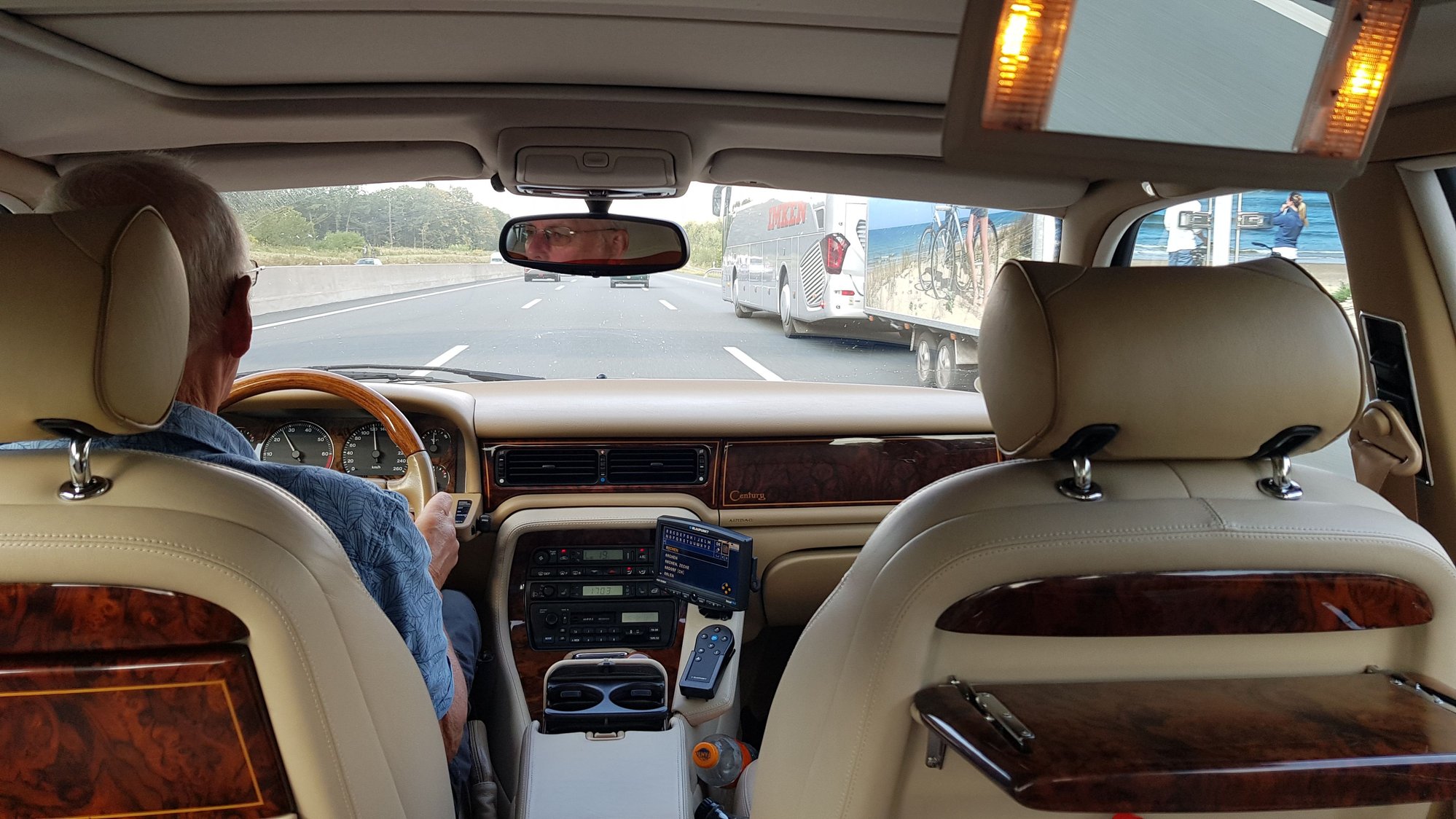

we bought it. Had a fantastic 17 hour journey from Germany back home to Norway. Such an effortless engine and an amazing ride and comfort. way better than my own sovereign..

Looks great!

Welcome to our addiction. She's a beauty.

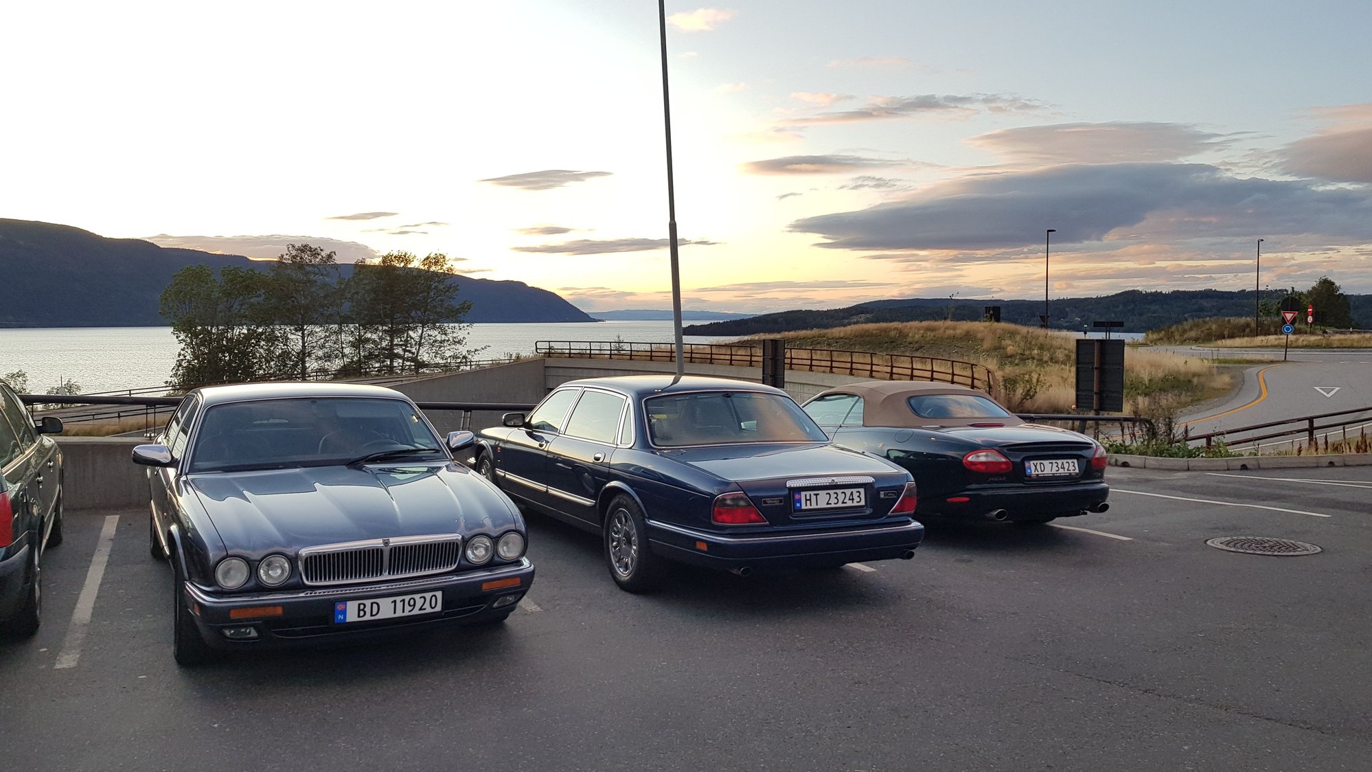

went for a nice drive today with the Century and my Sovereign. We have just discovered something odd about the radio though. Sometimes the radio freeze completely. If the radio is already on, there is no way to shut it off, turn the volume or operate any other buttons. Next day it just read "code " when we turned the ignition on. Topped up the battery after this and then it worked. for an hour.. and everything froze again.

My goodness.... it is gorgeous.
I see you took advantage of the extra rear seat space along the journey! I'm pretty sure your dad (?) doesn't mind acting as chauffeur at all. Actually I'm sure he has a big grin on his face!
Rear sun visors! Rear couch! Chromed turbine wheels! Sapphire blue! And of course, the mighty 6.0L V12. Simply Stunning. I'm enjoying his new car immensely!
