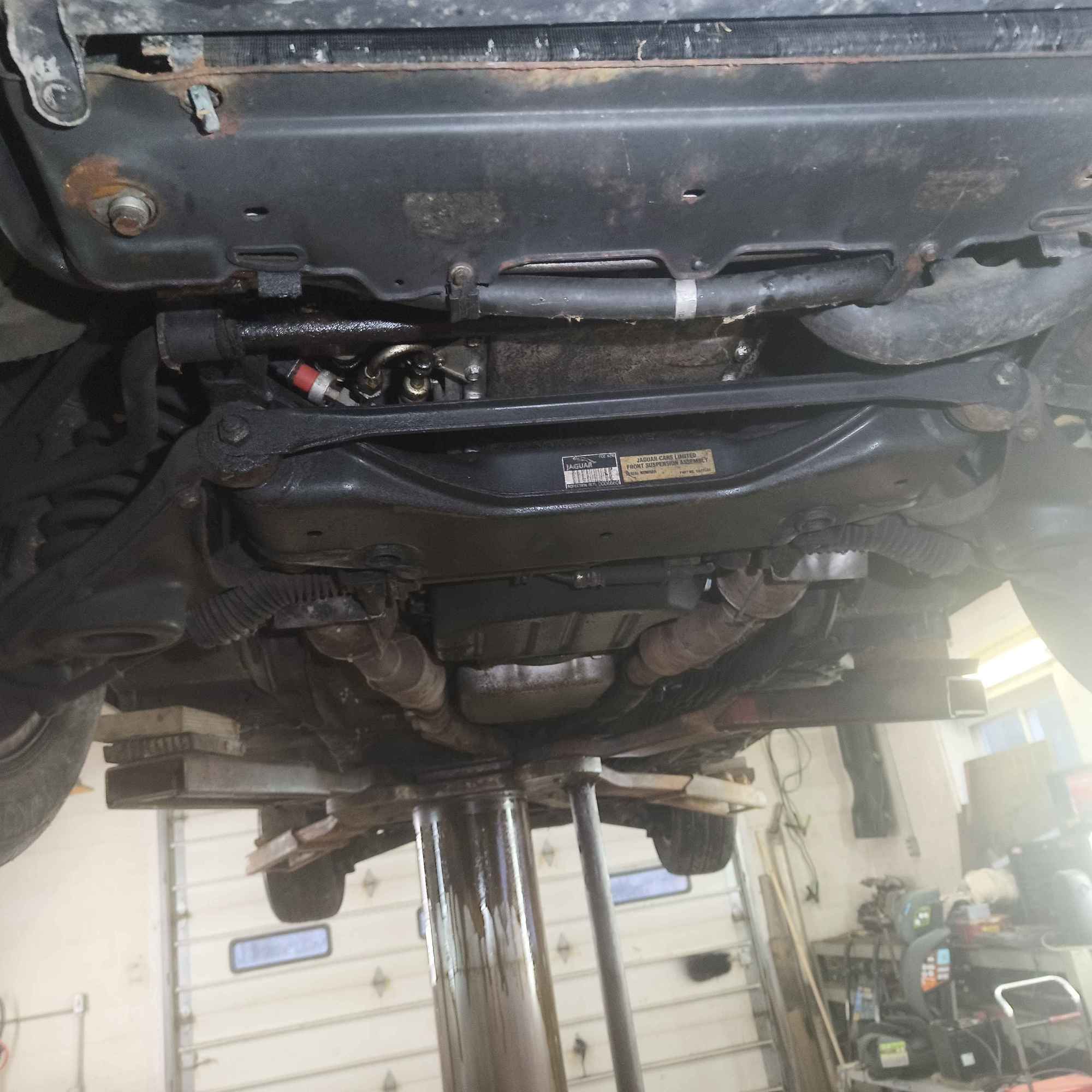

I recently acquired a 96 XJ12, after I've been looking for one for ages, my first non-5.3HE V12. Just got it up and running a few days ago, and had a few questions.

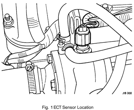

  1. Where is the coolant sensor on the 6.0? I ran it for a while to get it up to temp and check for leaks and the gauge never moved, so presumably I either have a dead sensor or a bad connection.
  2. I redid the o-rings inside of the oil cooler hose fittings (looked like someone had been in there before and used the wrong size o-rings so it was spraying pretty good), and now have no leaks. The hoses themselves look good, and are still nice and pliable, but I was wondering what's the actual difficulty level for removing them? I was debating on taking them off and doing it as a preventative, but I'm not sure if it's possible to do without a subframe drop.
    1. Is there supposed to be an aero shield/undertray? My car doesn't have one, but it seems like the longer oil cooler line would be pretty exposed to road debris without one, and I swear it looks like there are clip holes for one in the bottom of the bumper.
  3. I would like to get a second key fob and/or a new shell for the existing one that's falling apart... Anyone know of where to get either? I haven't owned an X300 in several years, but they're the same as a Saab 900 of the era if I'm remembering correctly?
  4. The steering wheel has a little up and down play, almost like a worn column bushing on an XJ40... Any insight into this? Maybe something just needs tightened?
  5. My oil pressure gauge dropped to zero randomly several times once I got it up and running. I removed and cleaned the connector for the sensor and the issue didn't return, but I was thinking about replacing the switch/sender as a preventative... I saw a few threads referencing some JLM PN#'s but that it turns the gauge into a dummy light of sorts... Is there a PN# or an aftermarket switch that works that retains the correct oil pressure reading?
  6. Throttle bushings? I can 3D print some polyurethane ones as a temporary solution, but saw some mentions about a shouldered brass bushing or perhaps some delrin ones being available.
    1. How much spring tension should there be on the center throttle capstan assembly? I can't tell if my spring is either just weak, or maybe broken/disconnected on one end.
  7. For those that have rebuilt your own alternator, how difficult is it to remove the slip ring? I opened up my alternator because it wasn't working, cleaned everything internally (decades of oil leak/grease buildup on the brushes), and it actually works now. The slip ring looks fairly worn though, so I was thinking of replacing it before reinstalling it this weekend.
  8. I would like to keep the car 100% stock, and although the factory radio works, the display seems to have died... Is there anyone who refurbs these and/or are the parts available like they are for the clock displays/ribbons?
Some pictures of the new purchase for you all as well:

1. B bank water rail.

2.1. There should be a little baby undertray. The center rear protrusion gets ziptied to the swaybar, IIRC.
https://parts.jaguarlandroverclassic...undertray.html

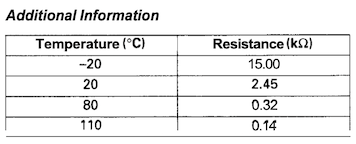

Just to clarify a little, there are two coolant temp sensors on the V12, one on each bank thermostat housing.
The one on B bank sends coolant temp info to the ECU and the one on the A bank sends the coolant temp info to the temp guage in the instrument cluster. This temp guage is programmed to read midrange most of the time so it really is only a glorified idiot light.
A scan tool will read the ECU temp info and give you an accurate idea of the engine operating temperature.

Thanks for the information everyone, just had some free time to get back to the car over the weekend. I was able to find both temp sensors, gave them a clean, and the gauge started working again, so that's good. Still haven't checked to see what the ECU is seeing for the engine, but I will later this week.

I got mine from a wrecking yard, same as on an x300, needed a bit of plastic welding

  1. I redid the o-rings inside of the oil cooler hose fittings (looked like someone had been in there before and used the wrong size o-rings so it was spraying pretty good), and now have no leaks. The hoses themselves look good, and are still nice and pliable, but I was wondering what's the actual difficulty level for removing them? I was debating on taking them off and doing it as a preventative, but I'm not sure if it's possible to do without a subframe drop.
  1. I've done this and recommend hose replacement, it is easiest to drop the subframe which isn't as a bad as it sounds. The hoses typically split right up by the oil filter housing, Be aware the motor mounts are unobtanium and may fall apart when you drop the subframe though. Also easy to replace the starter motor while the frame is out, bit of a nightmare with it in place.
  2. Here's a photo album: pictures speak louder than words.

Looks like the oil cooler lines will just have to be what it is for the time being. My garage space is being taken up by my XJS, and I only have a weird angled and heavily sloped driveway to work in... and I'd have to buy an engine support brace, and there'd be a lot of "while you're in there's" I foresee. Maybe in the summer if I could borrow my brother's lift for a week.
