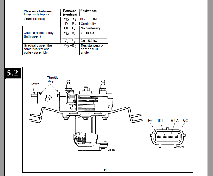

It could be a problem with the idle switch, which is part of the throttle position sensor. That might set a code. Tests can be made at the TPS plug. I will have to look up which pins to test for the switch and operation of the TPS. Stand by.
Next I would check the idle air control valves at each side. They are known to get dirty inside. 4 small bolts hold the top part on. I think there is a small coolant line attached too but it won't spill much.

Idle switch is closed at idle, with continuity between IDL and E2 pins. Then it opens shortly after throttle opening. This may or may not be related to your issue but good checks to make anyway. The TPS and the idle speed control valves are OBD monitored so a major test fail should give a code.
