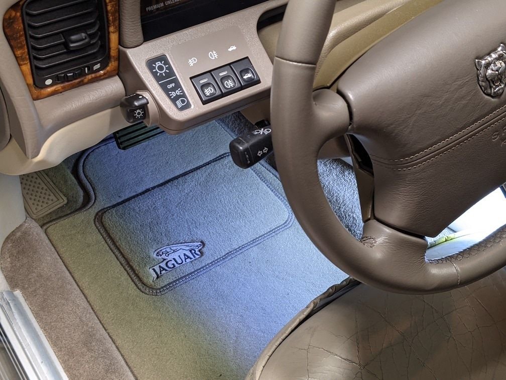

New floormats and new old stock X308 steering wheel are in.
Turns out the lambswool mats that came with my car are for LWB application. Anybody with a LWB of interior color code AGD want them? The driver mat is worn but the rest are ok....

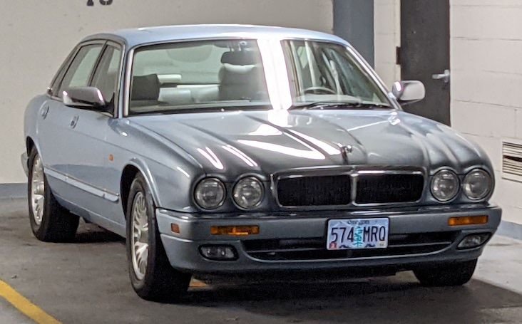

Plates and registration have finally arrived after four months' wait. I am irrationally enthused about having the last exterior accoutrement the car needed.

Congratulations I guess? Four months... a delay due to Covid? I see you got one for the front too. Will you be known as Mr. Q now? Lol

I would normally be ambivalent about a front plate, but the bumper has holes drilled into it.
My Miata, which I bought in one-plate New Mexico, never wore a number plate up front.
My 944 had vanity plates; I paid for both so it wore them both.
OR DMV's covid-blamed delays were well covered in local media, but I figured that they applied mostly to in-person office visits which is why I mailed in my paperwork.
