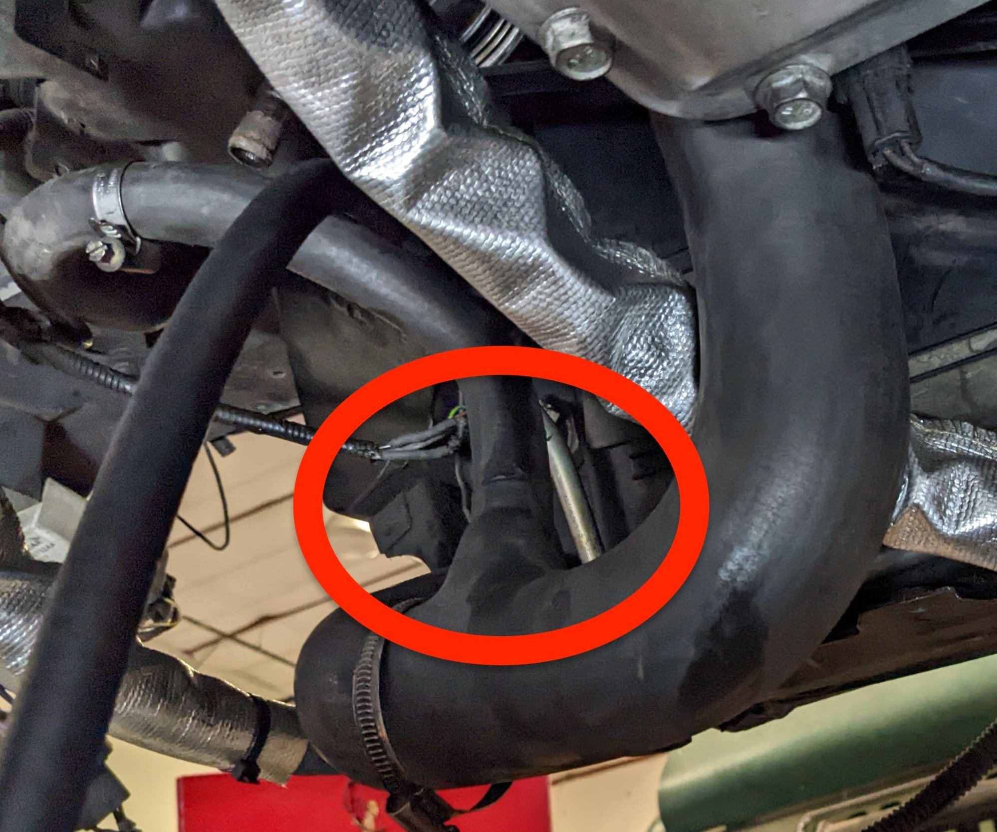

I opened the bonnet and after things had cooled off a bit I flushed all the spilt coolant from the front of the engine area and restarted my car. A leak was immediately evident from the lower radiator hose at the join to the vertical hose. As the car warmed up the leak got worse of course.

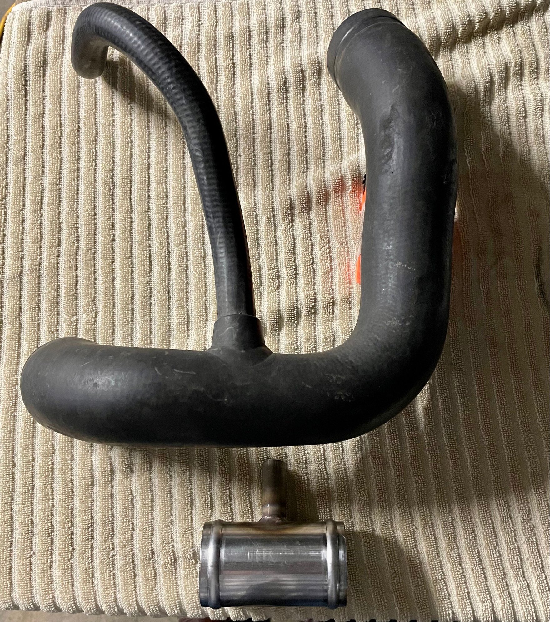

Well it appears that my comment in my last post was prophetic as my new hose started leaking from the T join after only a few months and although it was well within the warranty period with the cost of returning it to the UK and with no guarantee that the replacement wouldn't leak I decided to have a metal T piece made.
I tried a couple of radiator repair workshops and none were interested when a friend suggested I try an exhaust workshop. So off I went with my dodgy hose and explained my problem and proposed solution and the exhaust tech said no problem and to leave it with them. They called the next day to say job done.
See pix.

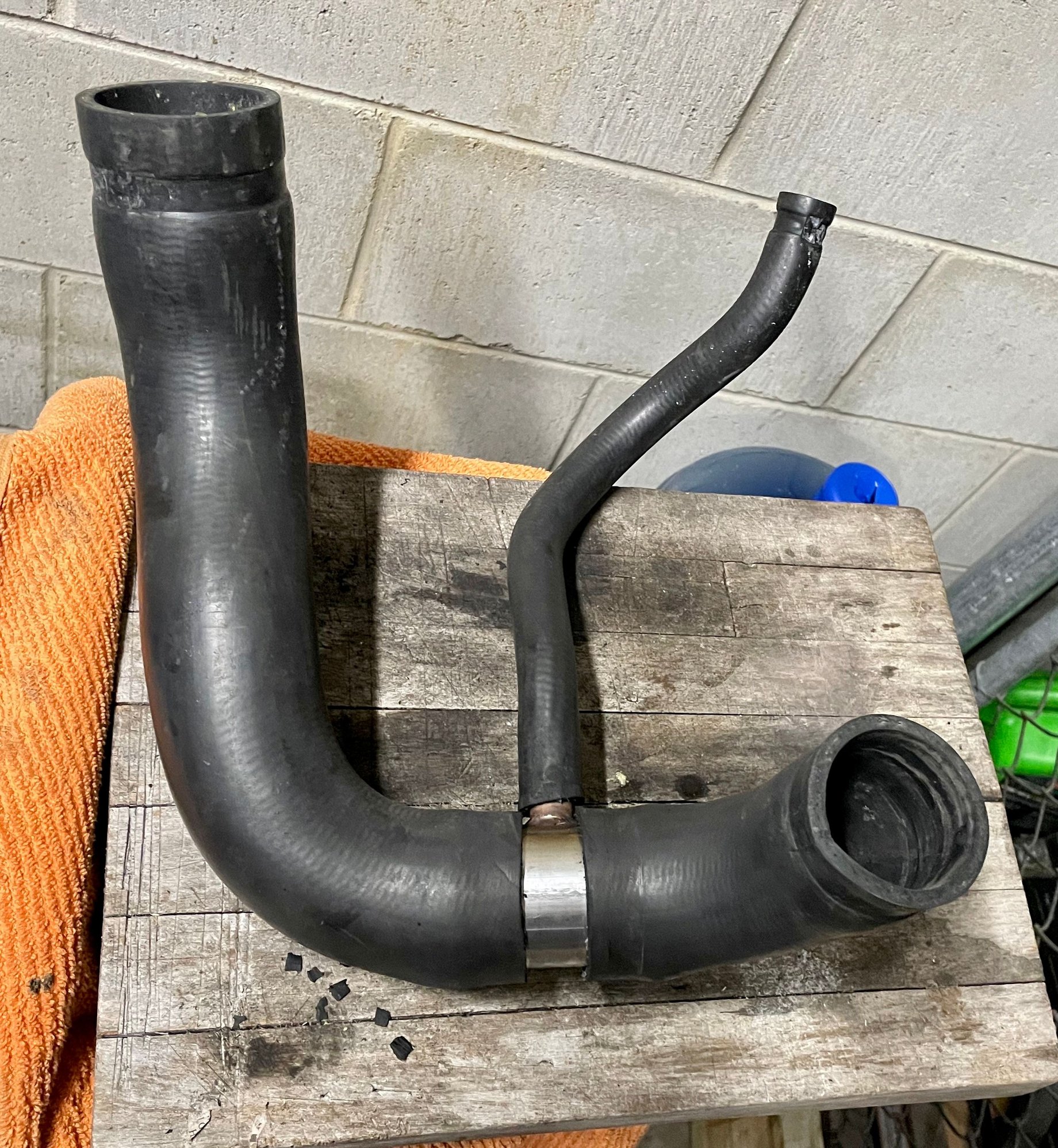

Firstly, the dodgy hose and metal T piece, which is a 90mm piece of steel tube 51mm OD with a 15mm OD piece of steel tube welded to it.
Secondly, the dodgy hose with the T piece inserted all I need to do now is source a couple of hose clamps and fit it to the car. I will leave the clamps a bit loose until it is all in position and then tighten it up.

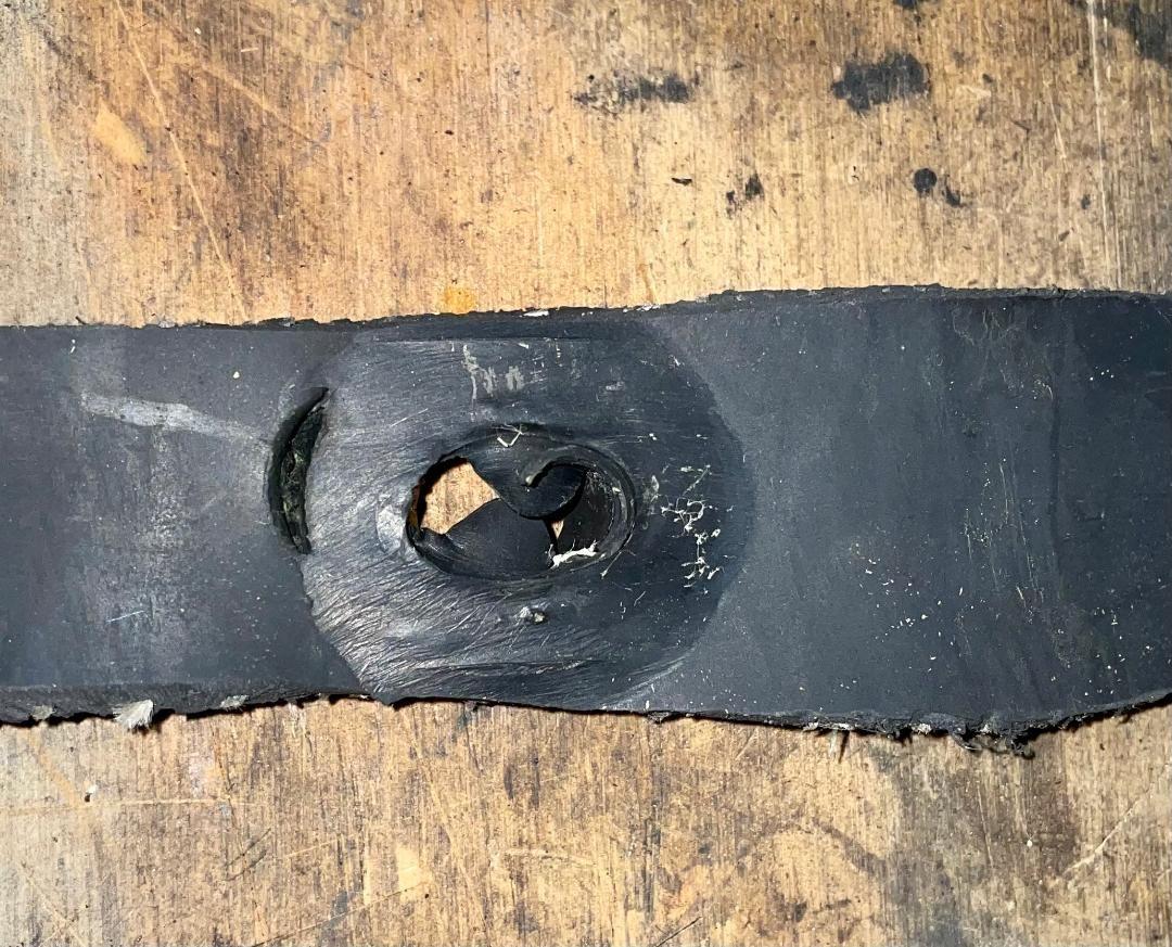

The attached pic is of the T piece join which I cut from the faulty hose and you can clearly see the split on the upper left side of the welded join. You can also see that the small hose, which goes to the heater, is partially blocked by flaps of rubber.
A further symptom of my faulty hose was green coolant seeping from the fabric material hose reinforcement at the ends of the smaller pipe. The coolant must have entered the body of the hose and travelled through the cloth material until it exited at the hose end.
