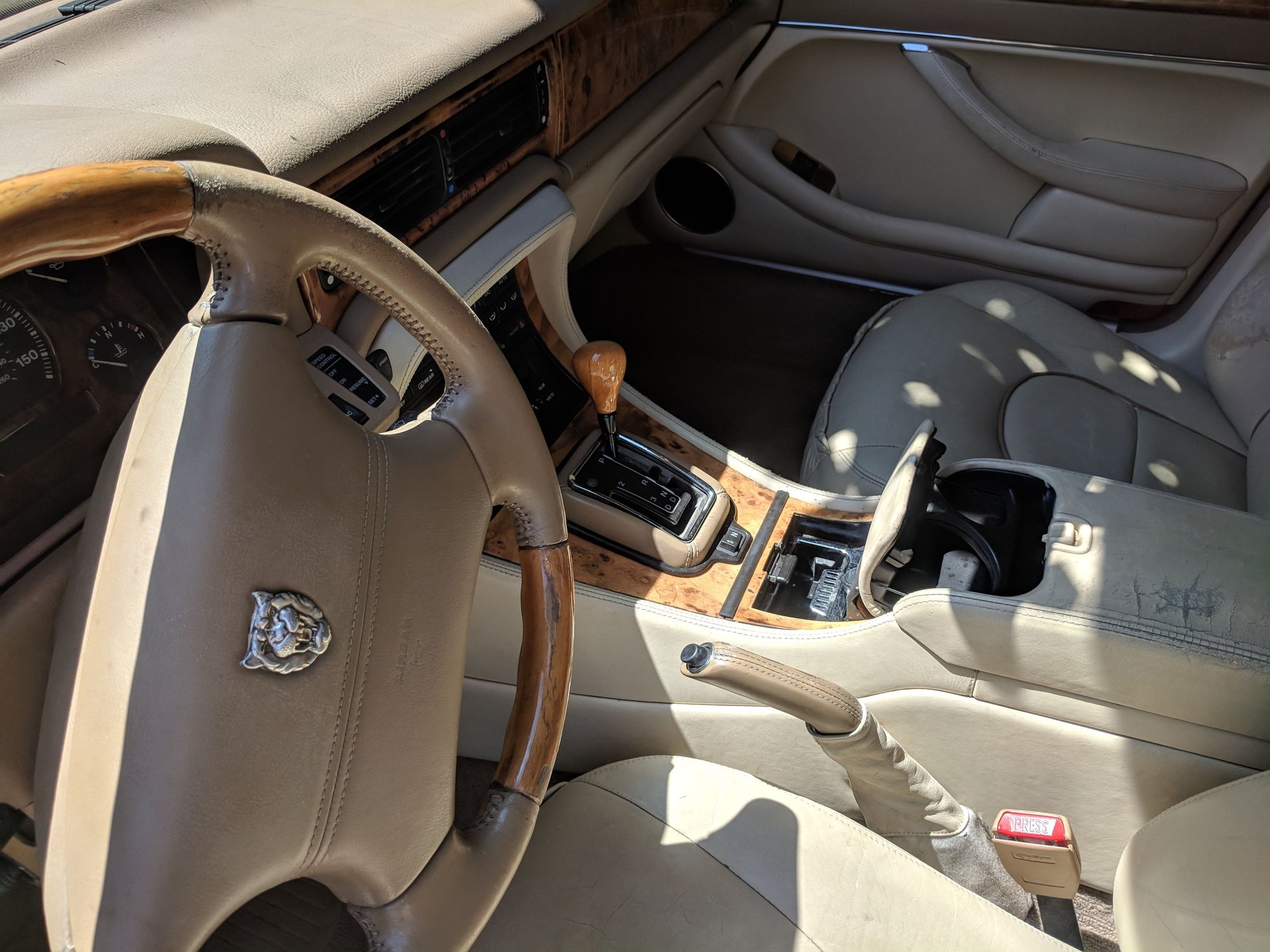

Roof has issues
Steering wheel, center console and seat wear
A couple of in-progress pictures after a day of inspection, gathering up random bits before vacuuming, a lot of interior and paint cleaning. I'll condition the leather in next few days, got it clean enough now.
There was some kind of weird very sticky coating on the entire roof which I wound up taking off with 'goo gone', followed by a lot of washing, scrubbing and trials with cutting compound. I'm going to wind up painting it to get an even finish and clearing it, so it's going to need some sanding. The other areas of the car that are dulled can probably be cleaned up with a touch up gun where needed for dings, scrapes and rear parking rash, and a lot of clearing over scuffed dulled clear.
Does anyone have the paint code - there are lots of blacks, would be good to know the match.
I've retrieved the rear section of the sunroof which looks as though it needs cables which aren't there, does anyone know where the sunroof drains are I'd like to test them to make sure they run through.
I've had a good look a the engine but haven't touched anything yet, next up is hoses and a good cleaning from above looking for leaks and issues, will follow this up with a good look from below of the entire car this week.
