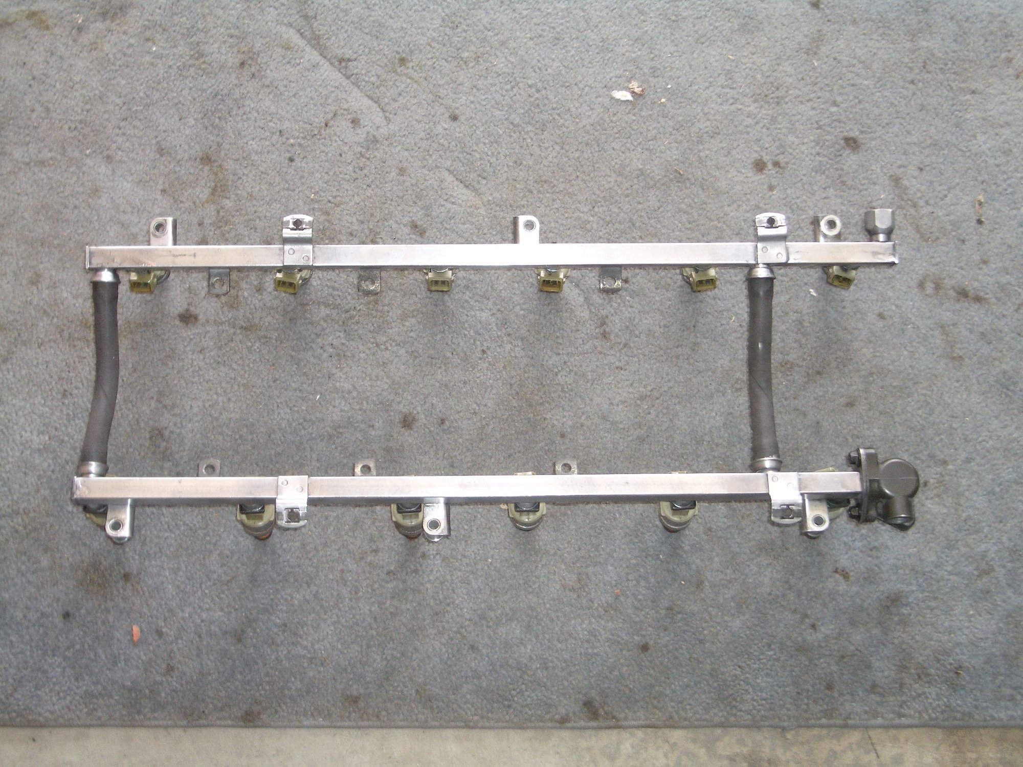

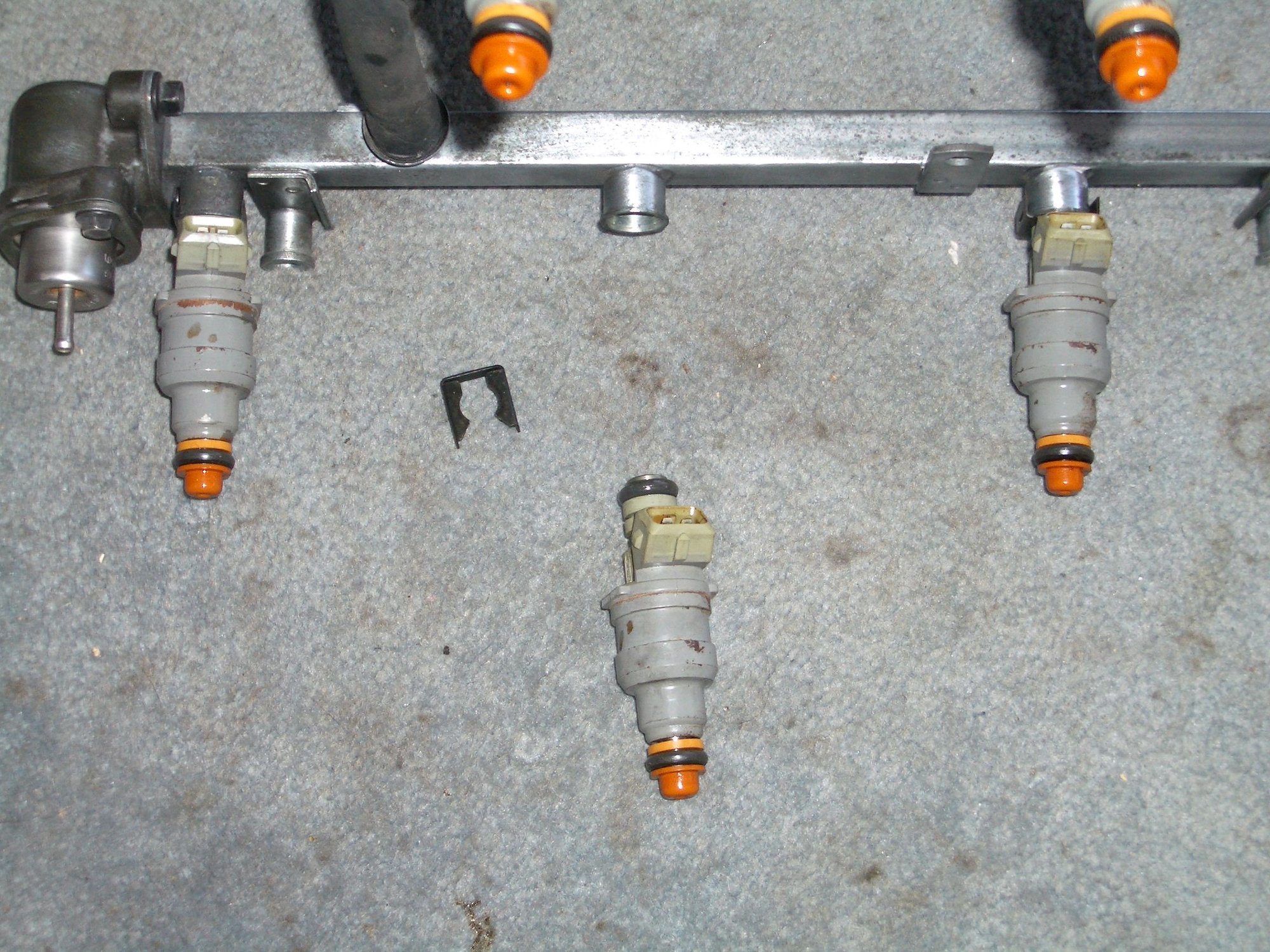

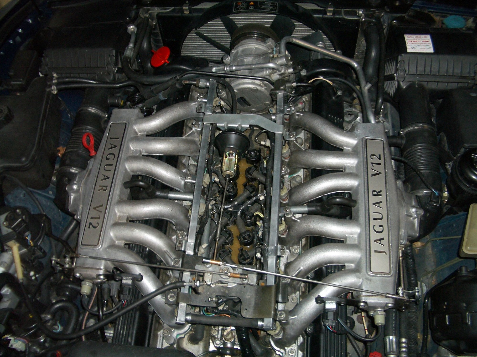

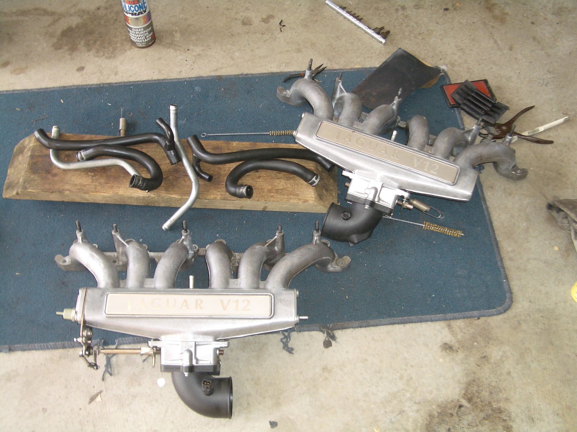

G'day Oliver,
My setup is a little simpler than yours as it doesn't have the air injection system on it and I didn't remove the coil packs I just cleaned around them. Everything came off cleanly and went back on without a problem and as I said it started right up and ran smoothly.
The reason I did all this cleanup was that nearly everything under the bonnet was covered in some sort of corrosion inhibitor, probably from when the car was shipped from the UK to Oz, which I couldn't move with any solvent I tried so I had to wire brush most things.
I have some pix if you're interested.
Cheers,
Jeff.
P.S. In the interest of getting my engine to idle really smoothly I thought that I would track down air leaks in the system and apart from all the usual areas I found a couple of obscure ones which were an easy fix, firstly the engine dipstick "O" rings had perished and air was leaking into the engine through the dipstick tube, I replaced them with Viton parts and secondly at the rear of the LH head is a vacuum fitting, for the brake booster, and again the "O" ring had perished and air was leaking into the manifold, another Viton part fixed it.
