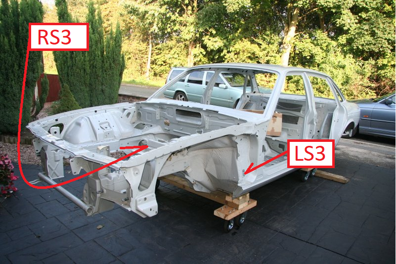

There are 4 connectors under the car in the corners that the lights run through that get corroded
They can be cleaned or replaced
They are the same as the Papa Indy 1 connectors in the engine bay
The bulbs in the sockets have a tabs that can be bent out for better contact
They changed the wiring on the lights between 95 and 96 so there was a fuse size upgrade i think on this circuit
