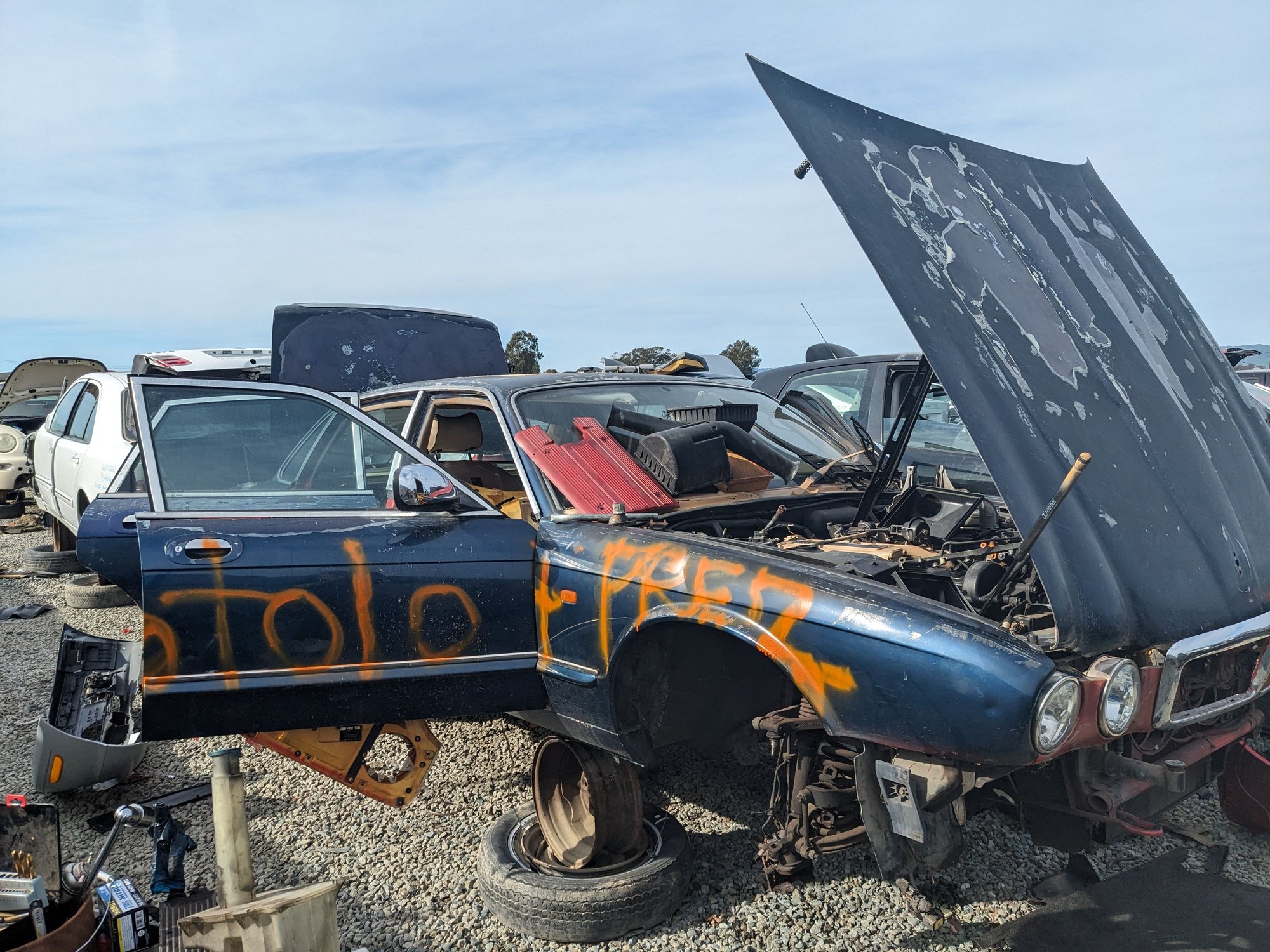

Amazingly there is a very grotty 95 xj12 in a bay area breakers yard and I've got the ECU, body control module, densu fuel injection square electronic thingies, oil cooler, smog pump, screen wash reservoir, failed to get the steering rack off (may go back for it...)
The cats are cut off by the yard annoyingly. The fuel injection rail and everything in the trunk were gone by the time I got there. The interior is completely trashed on this one.
What else is unique to these cars that are worth looking out for? Might be worth getting a list together for when these opportunities arise.
Are the AC and power steering pums unique? Is it worth getting the oil pump?
Separately I have no idea how to get the door glass out, anyone done this?

Just in that photo, I see the engine cover, airboxes, and wiper motor which I believe are X305-specific.
Looks like it has X308 headlights.
This hulk was seen in a recent XJ Jesse video (6:58 in).

I was being polite about the interior

The video explains why the engine cover in the photo is painted red. Its a theme. Louis Vuitton headliner?? Baller out of control!
Radiator, A/C condenser, fan & clutch, MAP sensors, T-stat housings, Cruise control vacuum bellow, Transmission ECU. Traction control device sounds like a good idea to grab. If you go into the doors, get the latches. Also the door upper chrome strips if any good. How about the wood door trim under the fake wood stickers?
