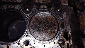

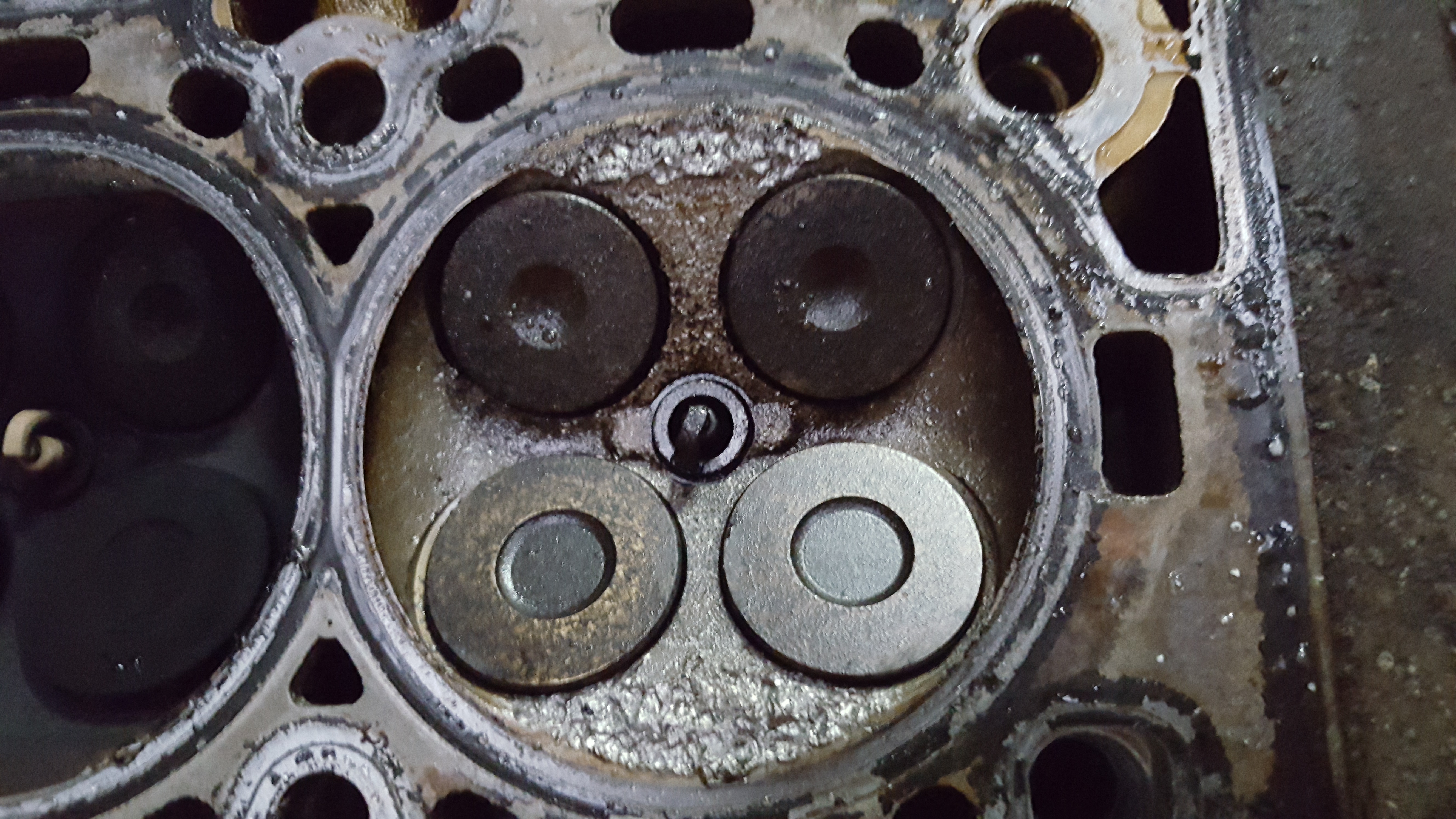

I lost the engine in my Vauxhall Zafira, when the Manicat cracked, couldn't get the old one off, had to break it up, and a little piece must have slipped down past the valve and into the combustion chamber, made a real nasty rattle, and when i stripped the head off, I found this...20170630_051959[1].jpg 20170630_052022[1].jpg
