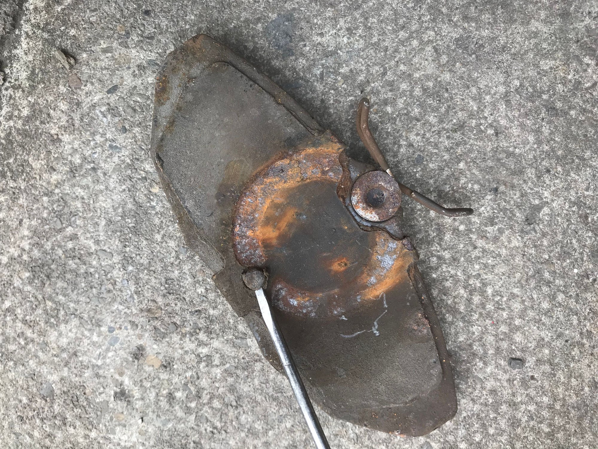

Did you remember to line up the little metal dot on the inside pad with the slot in the piston? If not, the caliper won't sit back properly. The reason I know this is because just this morning I replaced the rear pads on my 03 and came across the same issue and figured out the problem quickly enough.

Here is one of the old pads. The pad with the metal dot has to fit on the piston side of the caliper. You can see the mark of the piston on the pad, with one of the open ends of the piston lined up on the dot.
