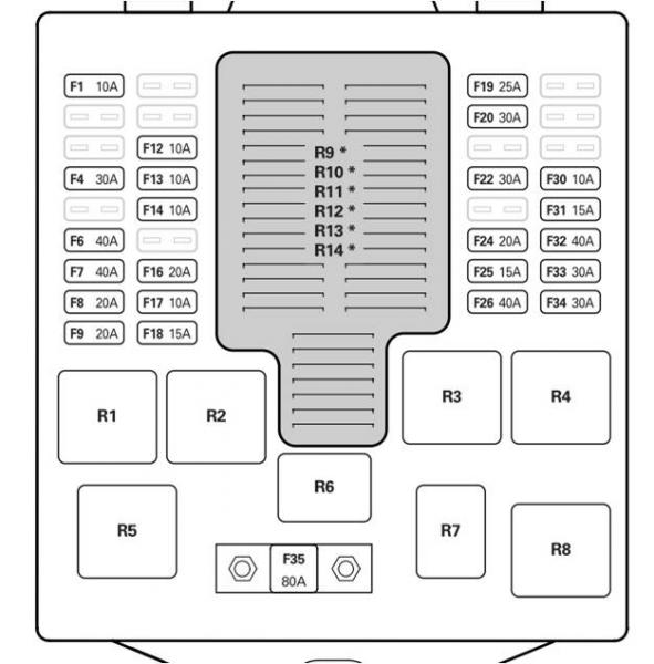

2004 XJ8, All lights are working with the exception of the main beams, or main headlamps.
I checked the fuses and they looked good, but I did not replace. Should I replace fuses? Is there a relay of some sort i should replace?
Any help would be appreciated. I'm on a budget this month and need to drive tonight. THANKS!!

Check you have volts at the fuse, then at the lamp. There will no doubt be a relay due to the amperage drawn by the bulbs. Owner Handbook has the fuse box layouts, and I think the relays are described as well.

This should assist with locating the Relay.
R2 = Main Beam

Fuses and relays checked good. Changed both bulbs and problem fixed. Both bulbs burned out at the same time. Weird.
