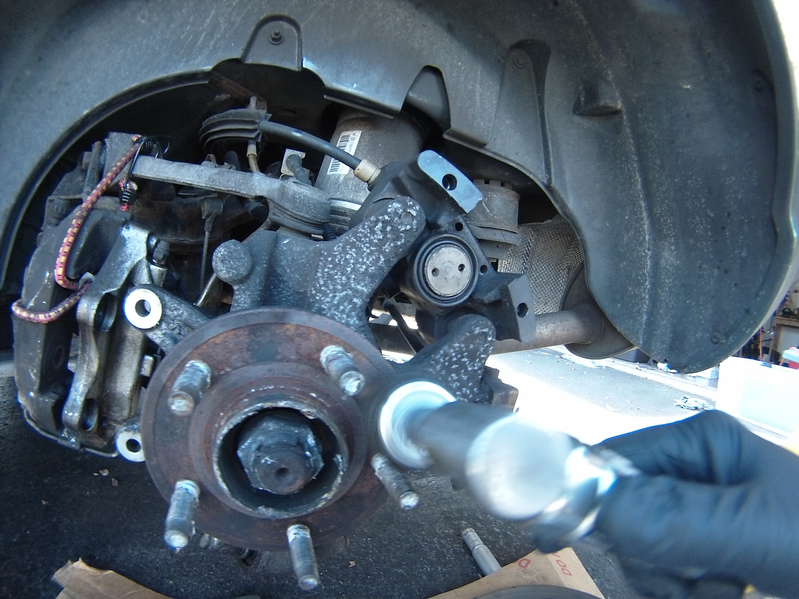

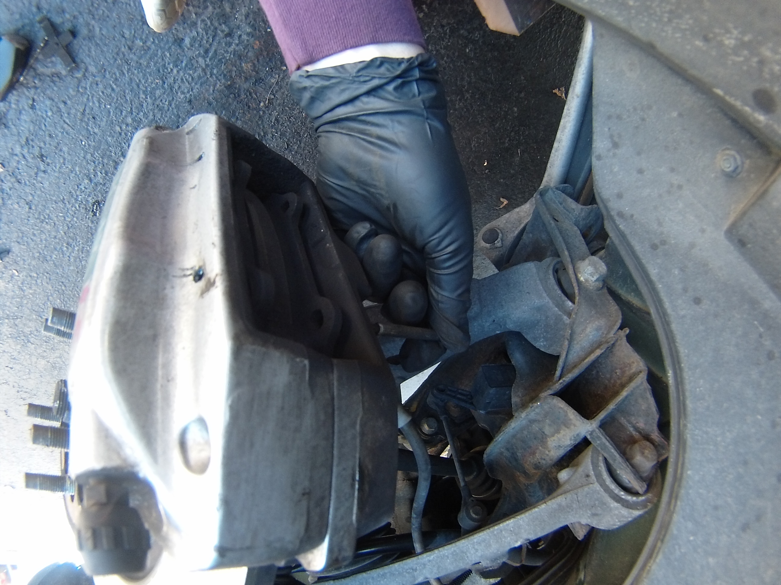

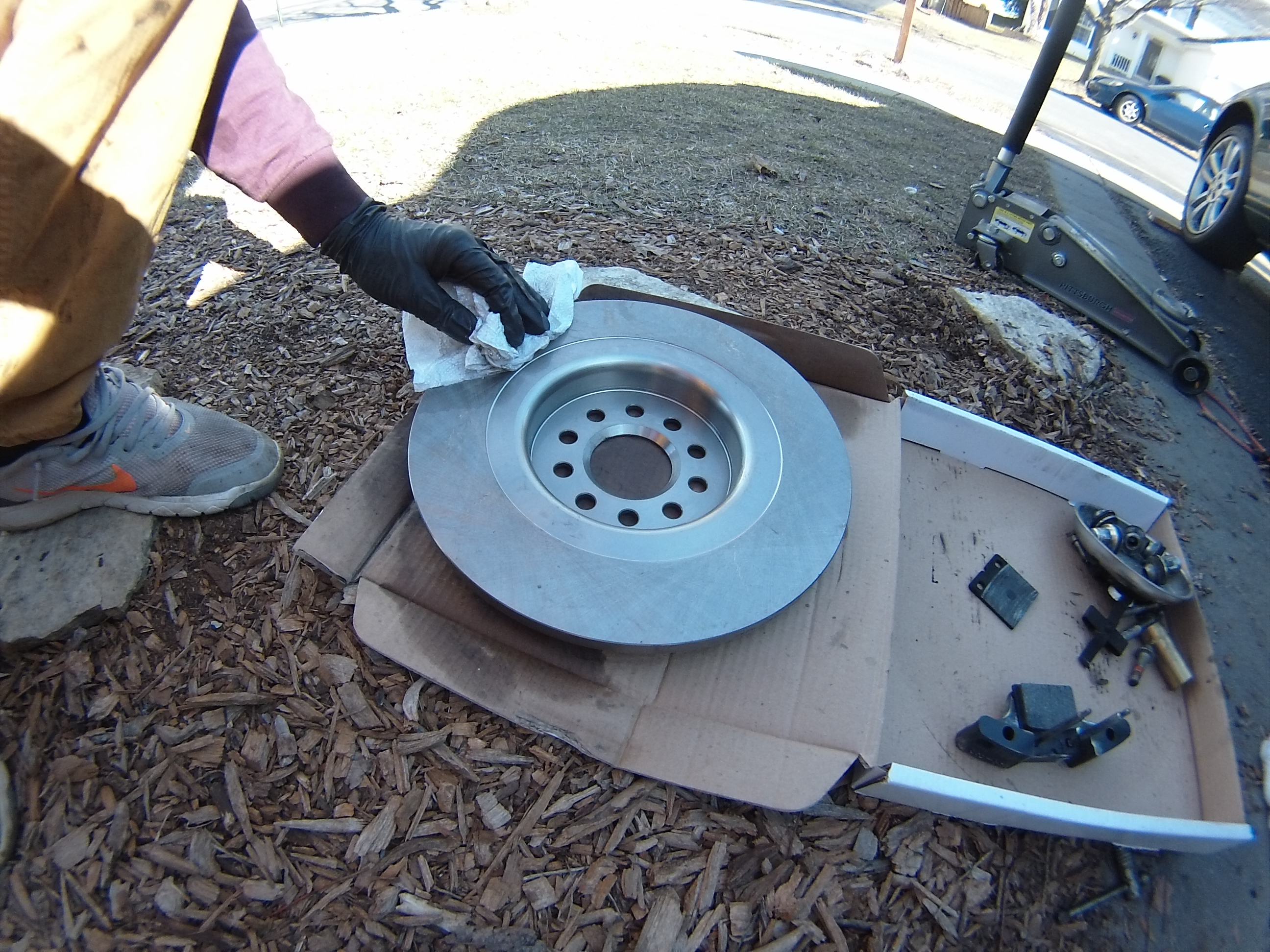

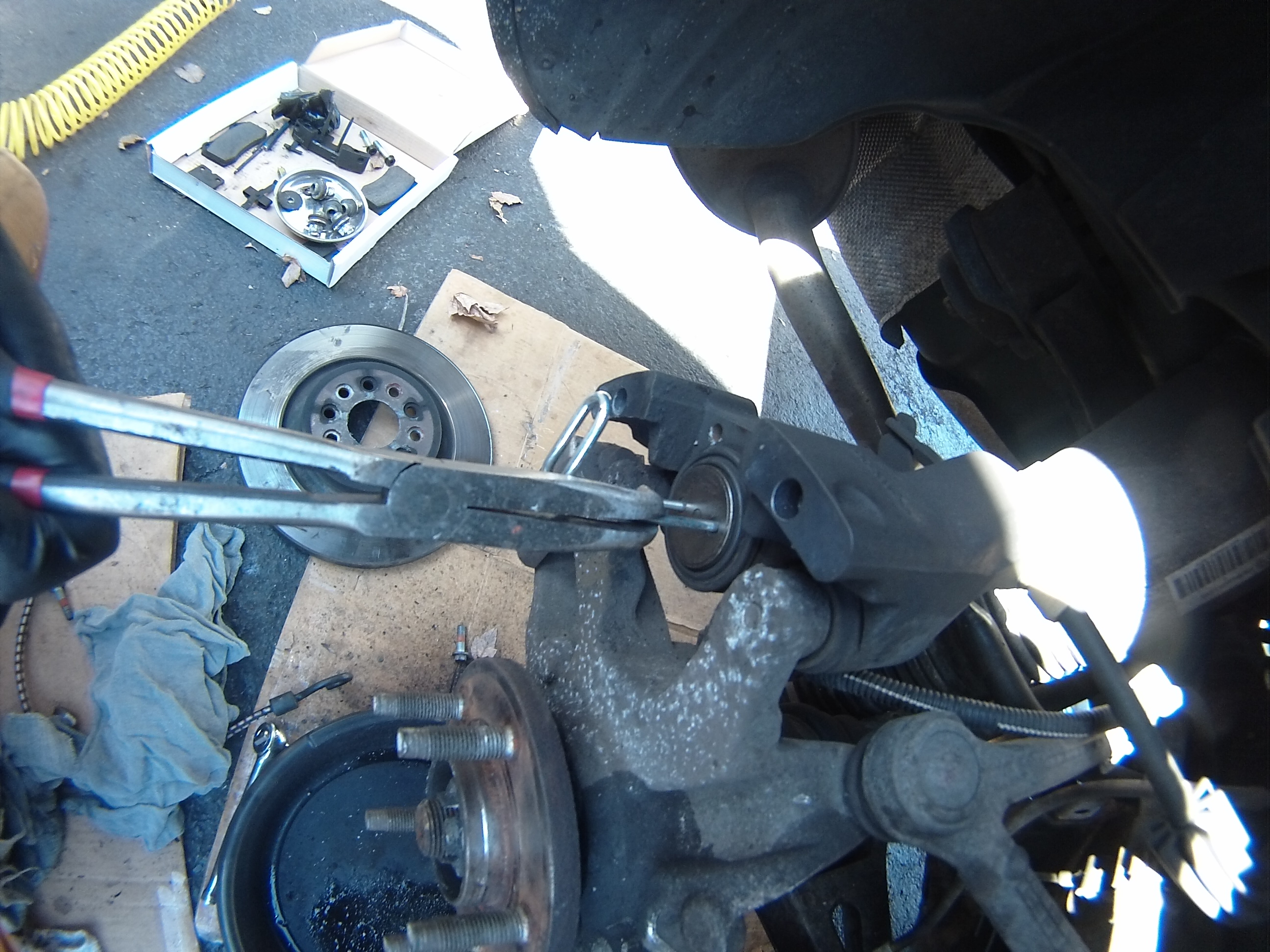

I just thought I would post a few pictures of my progress for anyone that's interested. Actually, the job was fairly straightforward thanks to this forum. I think everyone for that.

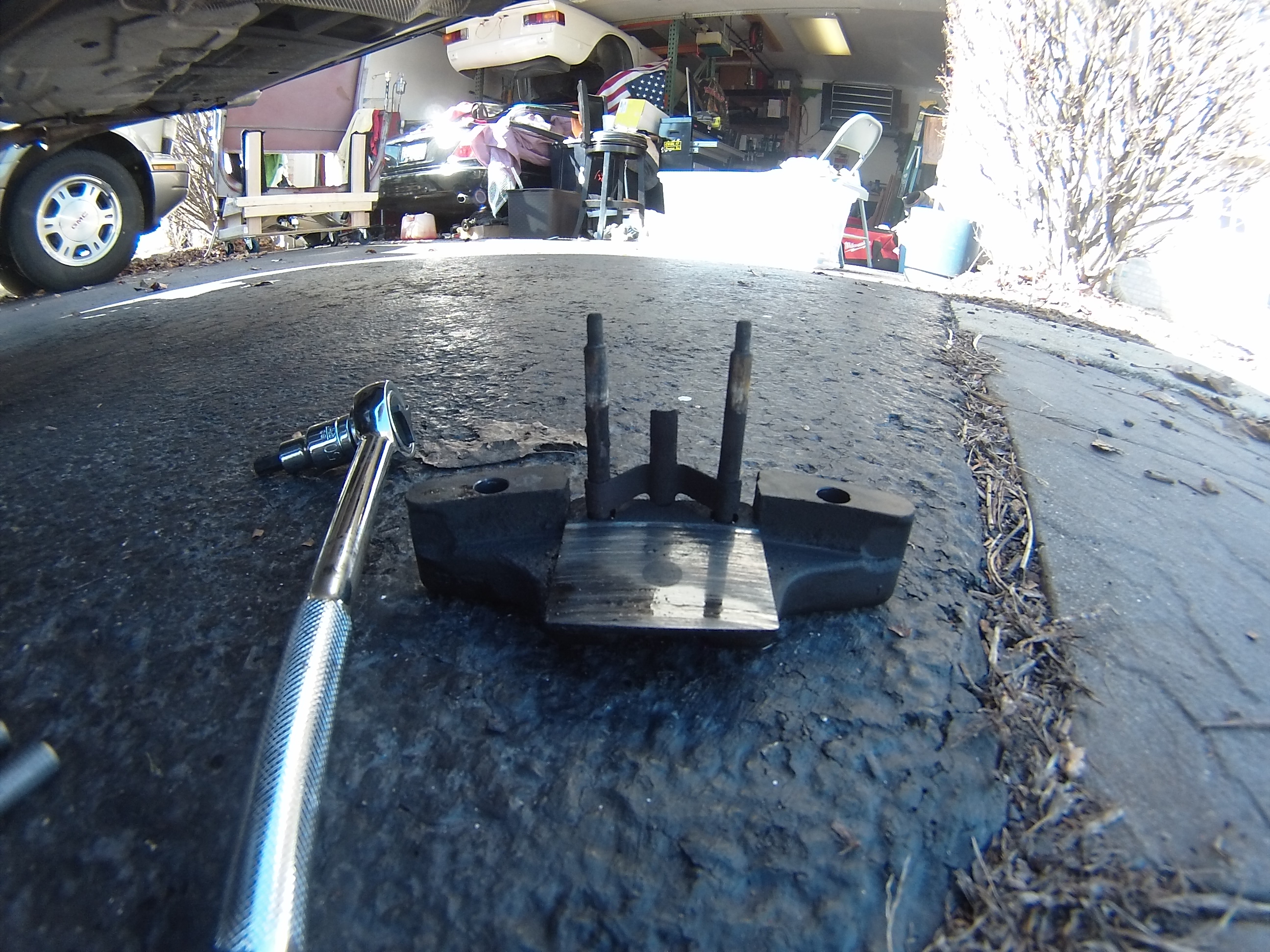

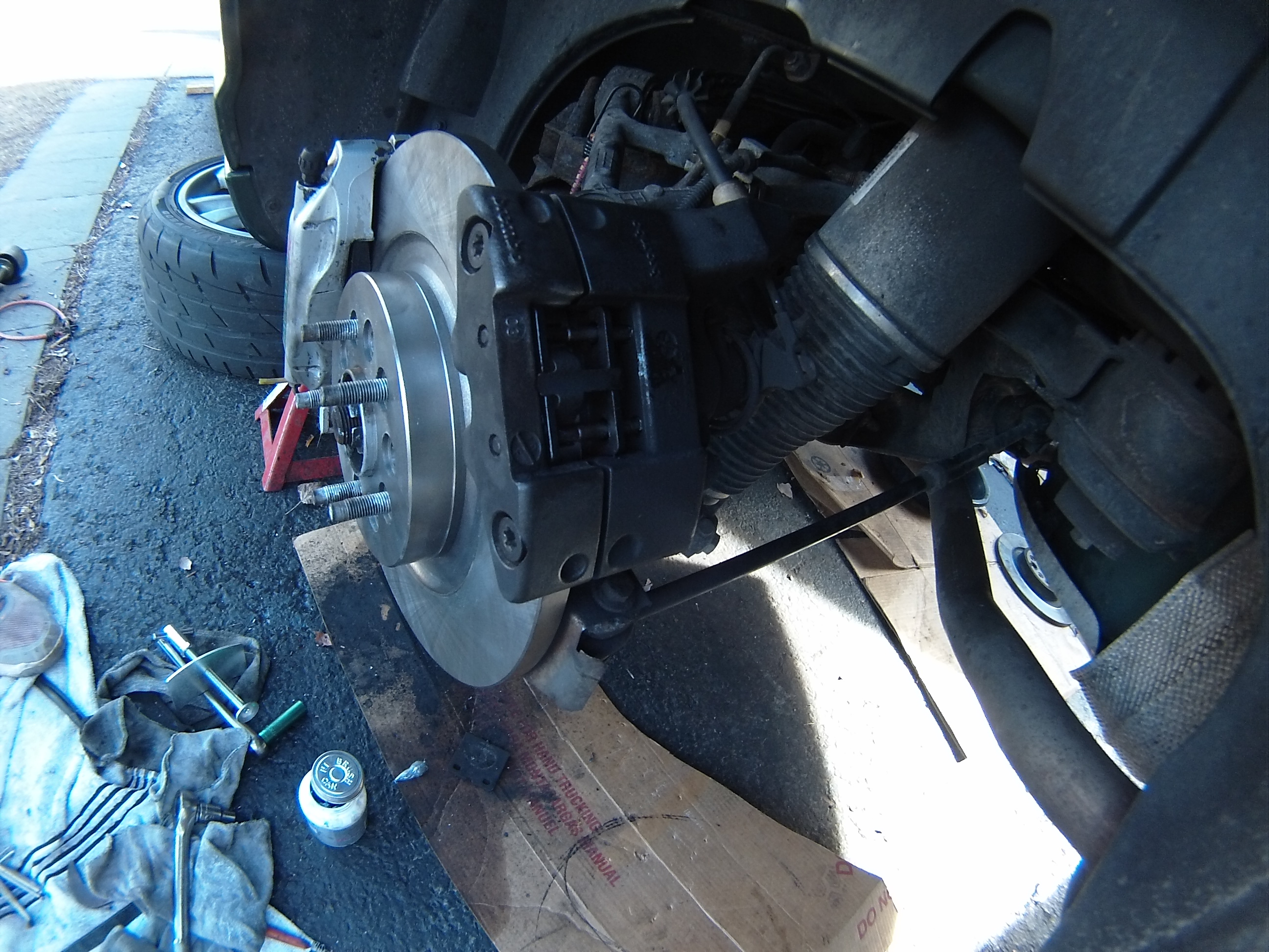

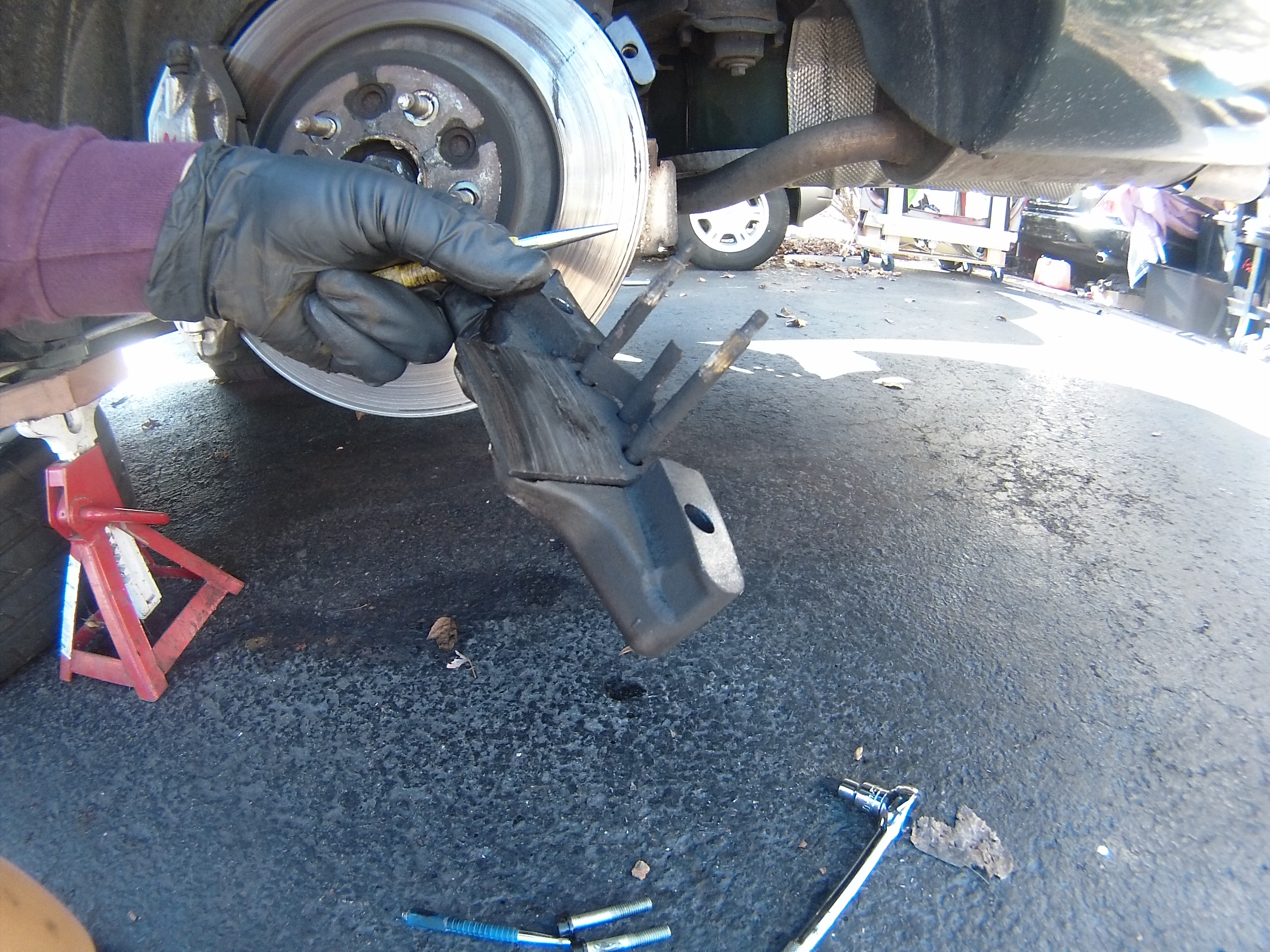

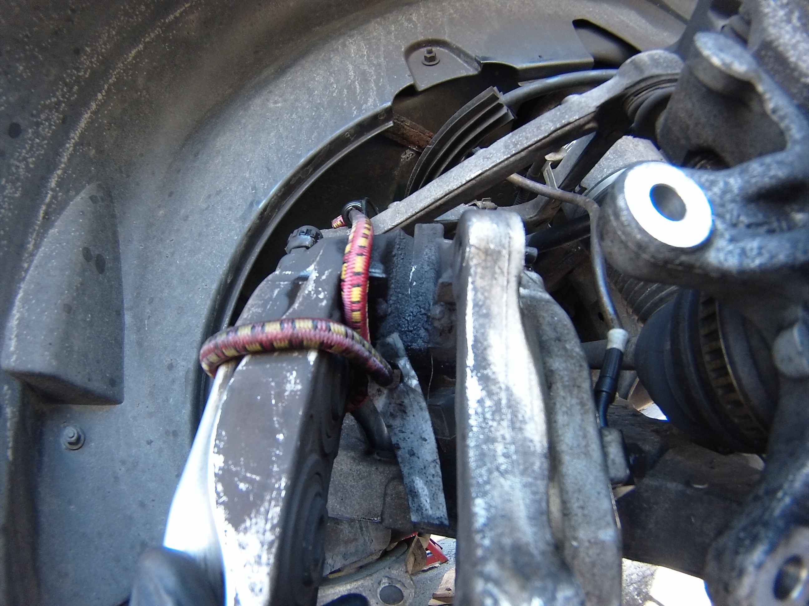

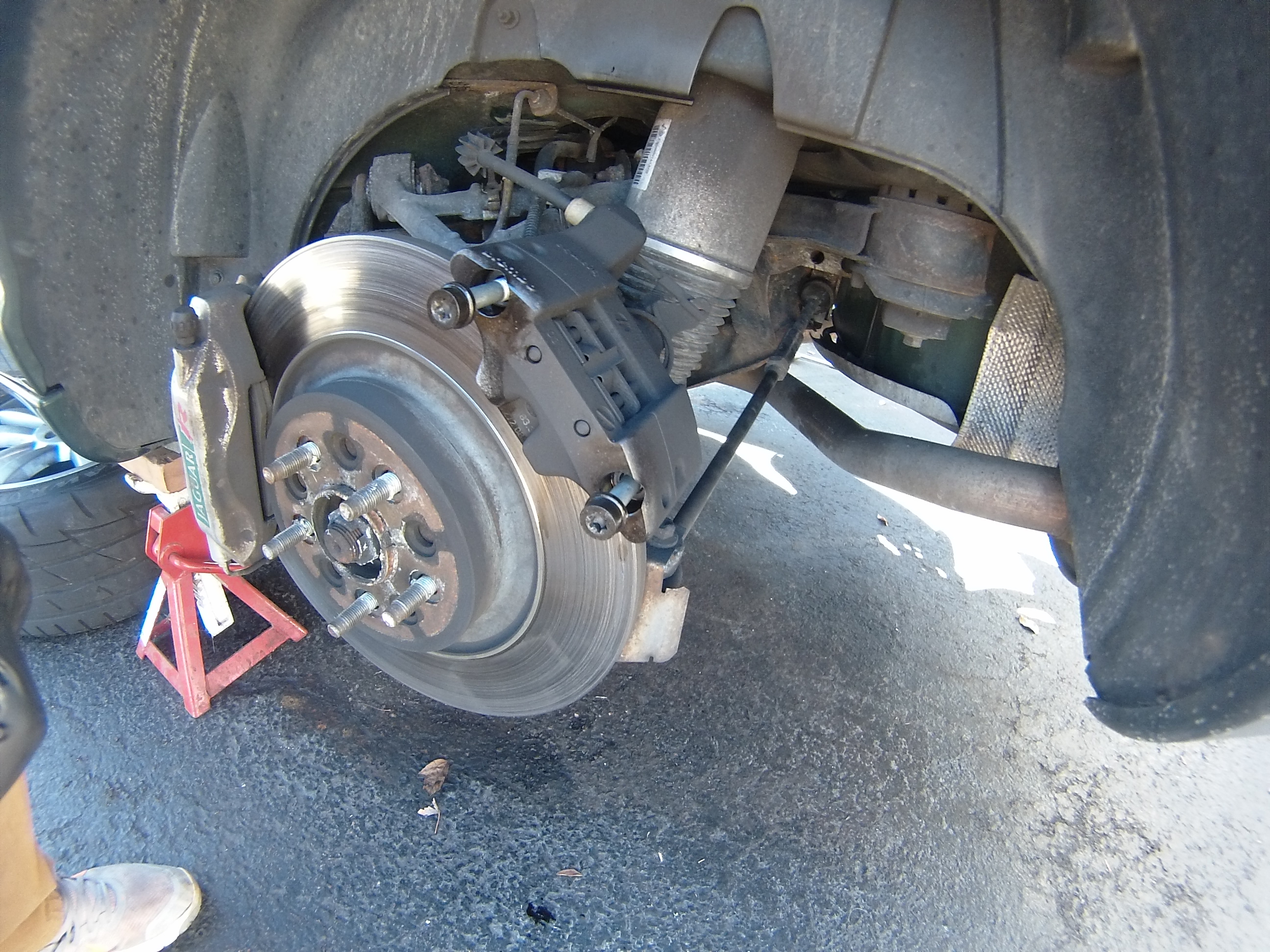

The next few pictures show the piston on the EPB protracted (all the way out)secondary to complete pad destruction. Also, the calipers were extremely dirty and the pins were unable to "slip and slide" secondary to grit buildup. The calipers were cleaned thoroughly and replaced. I did have a gap problem in the EPB originally. I turned the EPB piston all the way in, but thought in my ultimate wisdom, that I should turn it out a little more to decrease the number of cycles I would have to go through for recalibration. Now I know, thanks to this group, that you have to turn the piston all the way in for the outer portion of the caliper to fit correctly. Once complete, it took only three cycles to recalibrate the EPB and the ride is silky smooth!
Next weekend, front rotors and pads:-)
