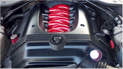

Ever since I did the vinegar radiator trick in May the car has been running great and has not stalled once. Problem was overheating without indication from the tamp gage. That's why it would start again after hours of sitting or the next morning. Felt great to get this issue behind us. I went ahead and painted the intake manifold and matched the breather elements to it. She's looking pretty and running smooth!
