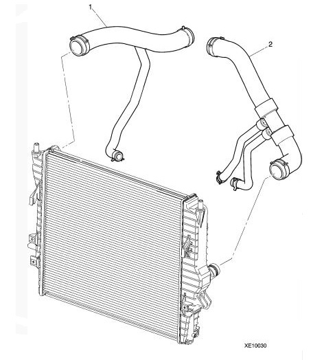

Welcome to the forum JagXJ8Bled,
If it's not coming from the radiator, there's a few branches on the top and bottom hoses of the N/A X350 V8 could be the source of the leak:
