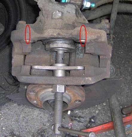

These are the tools that I have for Calipers. I use the Tool Set for the rear calipers and the Clamp on the front. The Tool Set clamp applies pressure and turns the piston at the same time.
The third photo shows how the Tool Set Clamp is positioned. (Photo is of Passat so it is a different caliper.)
