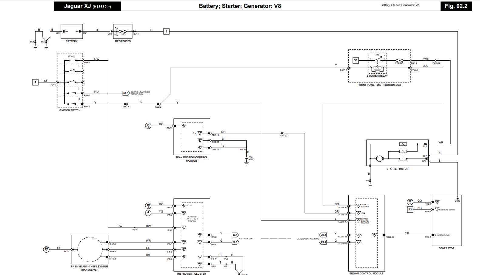

Most probably the alternator is causing the problem. But to rule out other possible issues it is recommended to measure the charging current directly at the output of the alternator. On the V8s this is a green/orange cable on pin 2 of the black four-pin connector on the alternator, measured against ground at idle, should be at least 14 V.

There is something that I would also like to bring up here. I mean, one just can't take for granted that the alternator is indeed at fault as some of the control signals to the alternator may not be present. In fact, to be on the safe side, it may be advisable to bring that alternator to an alternator repair shop to have that alternator checked out first.
