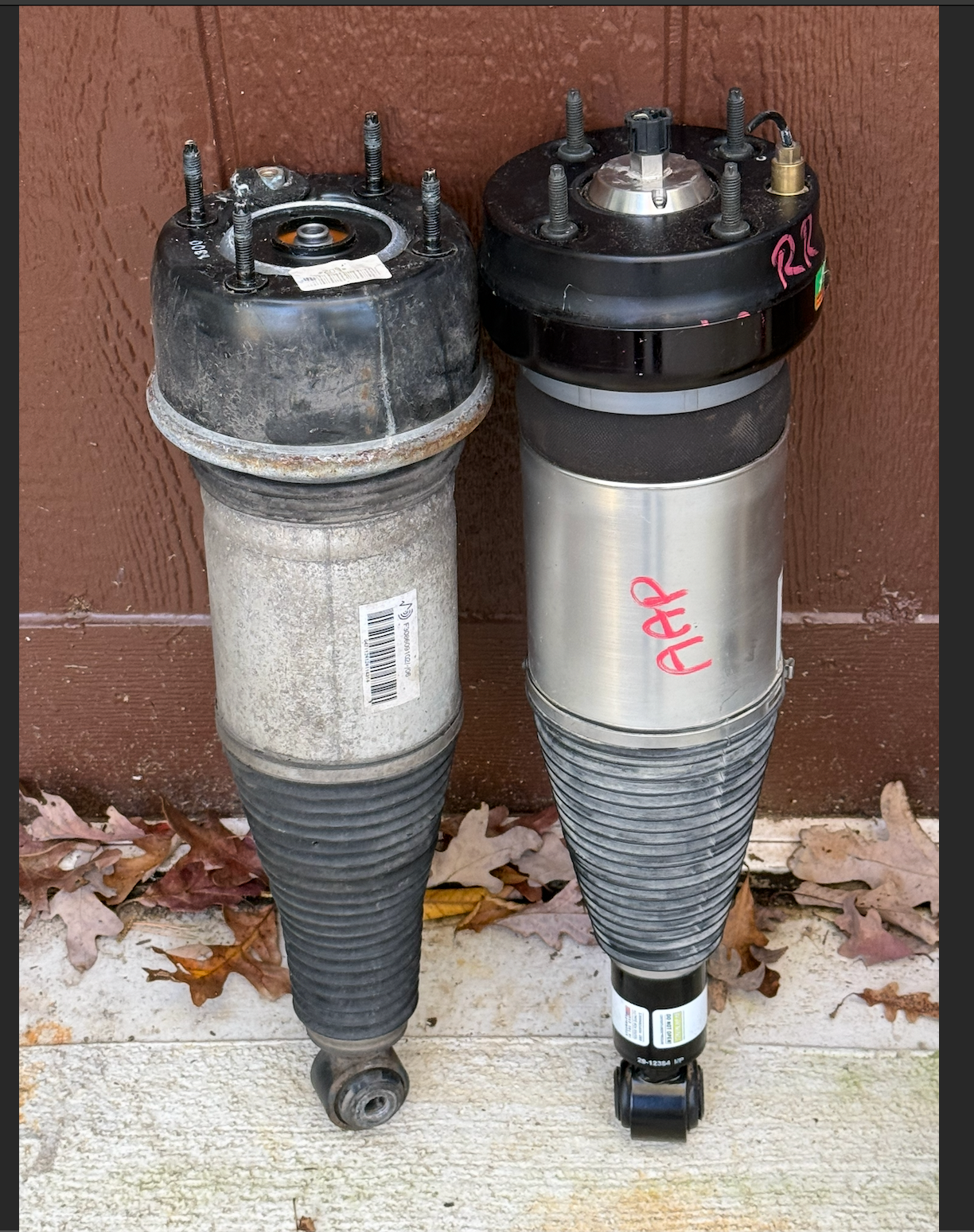

There is a new twist in the story. I took the car for alignment and wheel balancing, and the mechanic told me that the Arnott strut was taller than the OEM one. The difference was not huge, but it was there and would create problems later. I must add that on a levelled surface, both sides seemed even, probably because the auto levelling system was doing its job.
Based on that and the fact that struts should be changed in pairs, I also decided to change the rear right strut. Today I received the strut and compared it with the one I had taken out earlier. It seems that the mechanic was right. The Arnott strut is at least 1 or 1.5 cm taller than the OEM strut. I thought I would share this here as someone might find it useful. Thanks.
Maybe, maybe not.
We would have to compare two brand-new struts, and at the same retained-pressure condition.
Lest we forget, there is a valve just below the air-line fitting that closes the line when pressure drops to its preset.
If/as/when a strut has failed by leakage, the loss below retention target can no longer be controlled. So a(ny) NEW airstrut should be longer at-rest before being plumbed-in... than an old one....IF
A) the maker shipped it pre-charged. Highly probable as that preset minimum is to protect the bladder from a specific type of overstress.
AND
B) the removed one had been leaking. Also highly probable as they don't generally get involved in politics or other kinky fornickry that rates termination.
ELSE NOT. EG: We can't be sure on casual observation.
