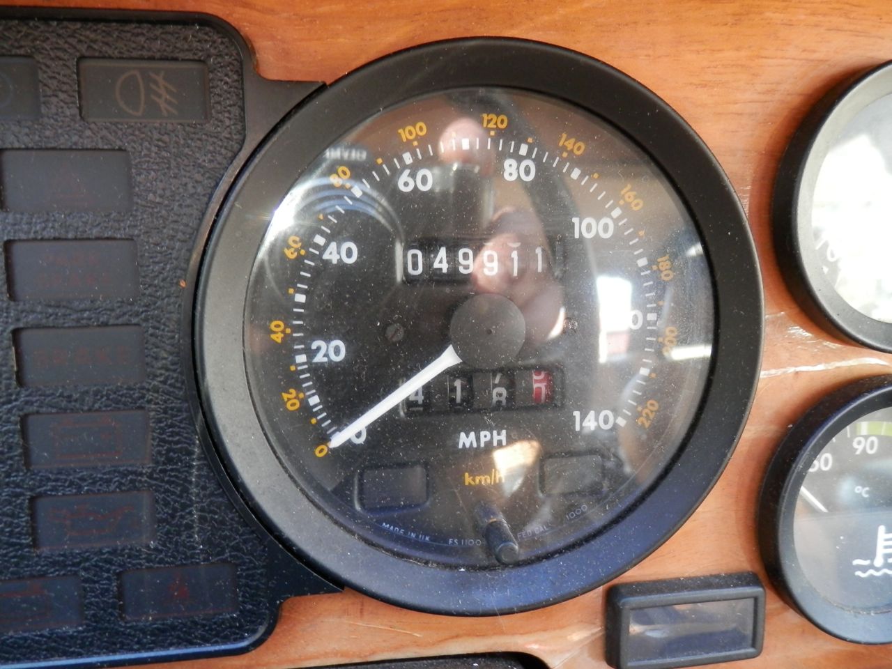

Now, on these cars the transmission transducer goes out and mileage quits being recorded on the odometer. So 50,000 miles may not be the accurate account of its use.
