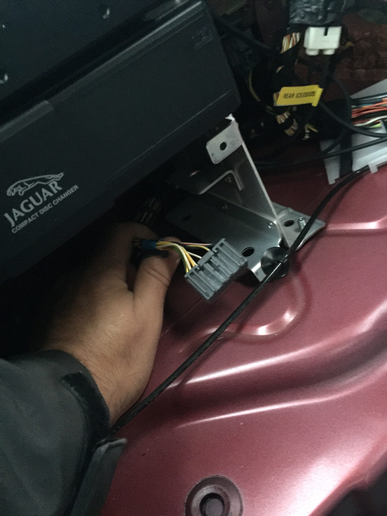

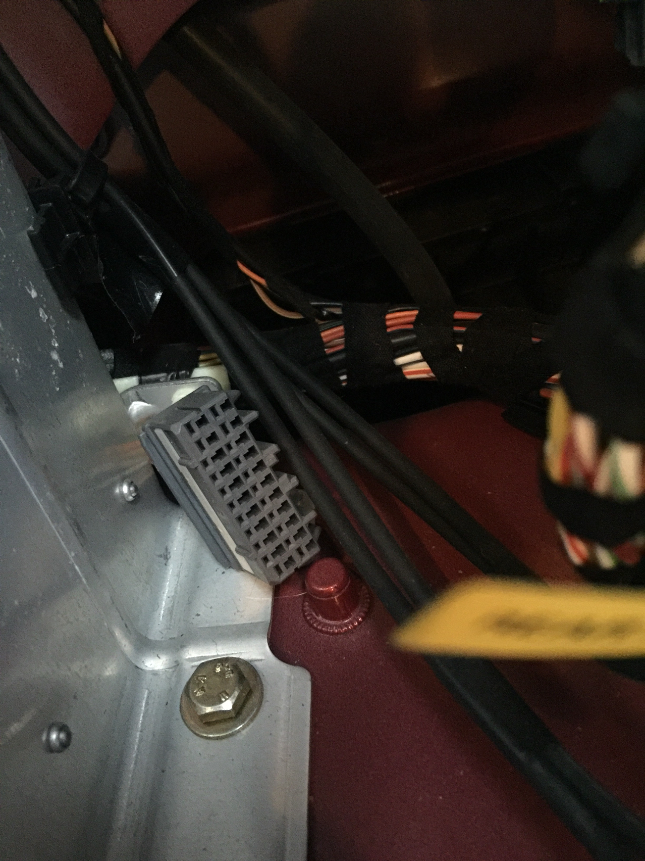

Please enjoy photos of Jag Voice and newer-style Bluetooth telephone.
First steps: locate existing connections in car and remove factory wraps (electrical and fiber tape(s).
Thanks
Mag

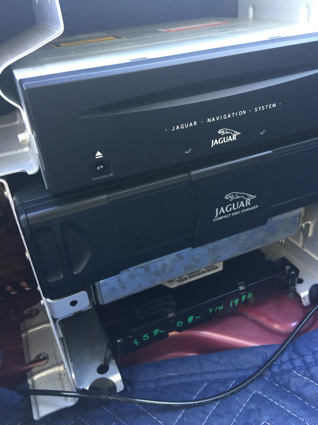

Next steps
Release all taped connectors and loosen entertainment stack from car.
-mag

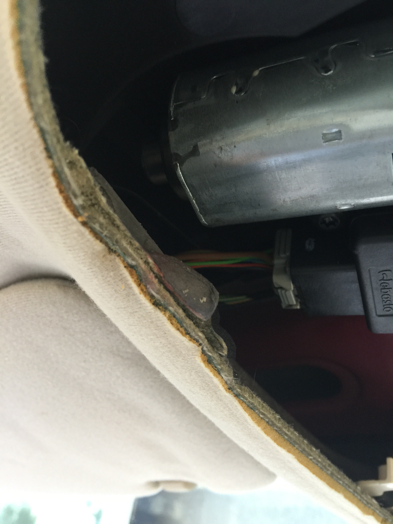

Added microphone to the center roof console.
Removed OEM microphone from its case and 'hid' it behind one of the circular vents in the console.
Needed to trim a bit of insulation from the opening to ease the upper console back in.
Also, fished the Bluetooth antenna behind the am and up and into the rear parcel shelf.
Thank you-
Mag

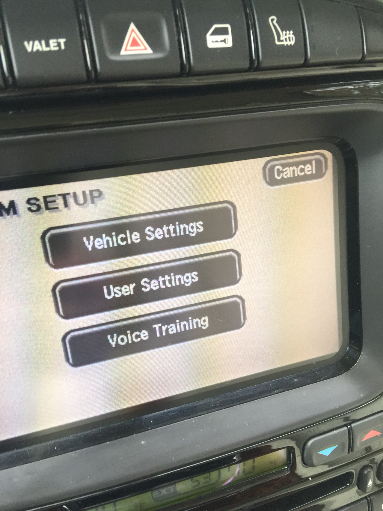

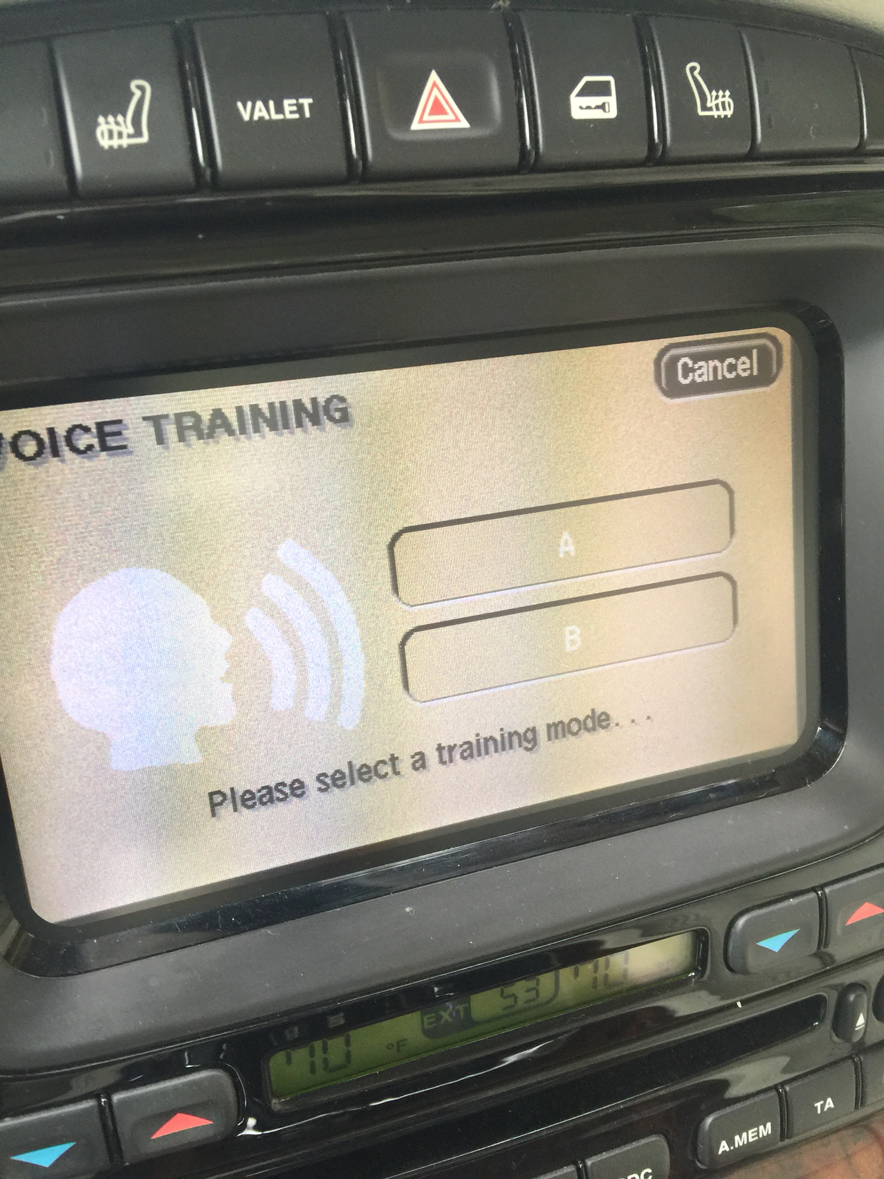

Attached Thumbnails Adding Jaguar Voice and Bluetooth Telephone-photo337.jpg   Adding Jaguar Voice and Bluetooth Telephone-photo232.jpg
