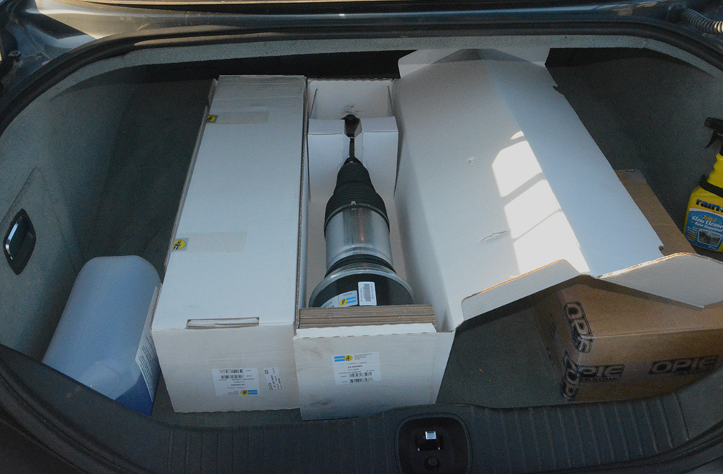

I spent some time searching thevarious types and manufacturers for Air Suspension Shocks for the X350 and soon discovered the choice is severely limited.
  • Bilstein B3 or B4 £540 - £850 each UK
  • Arnott AS-2888 £440 each from US or £650 each from UK
  • Reconditioned units from China £350 - £500 each
  • Second-hand with probably more miles and wear on them than your ones.
  • If you are rich then say hello to your dealer, £1200 each and upwards.
    I sent to US for a set of Arnott’s for the X350 and including post were a total of £430 each.
    Got money returned as were out of stock from company so searched the UK.
    Rip-off prices as they tried to charge £5-800 each for the Arnott unit in the UK.
    I opted for a pair of B3 Bilsteins for the X350.
    Total cost £1070 delivered. (£535 each).

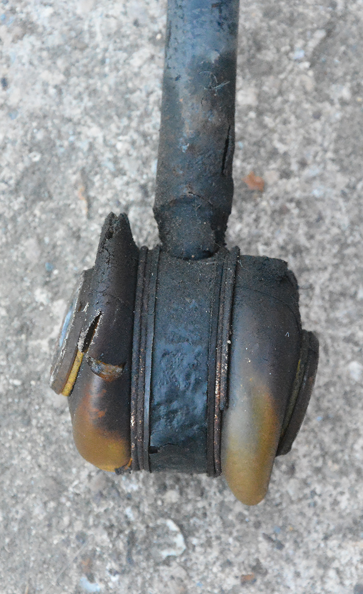

    I also had an MOT this week which needed two sets of rear linkages changed.
    Anti-roll bar linkages and both tracking/sway bar linkages.
    Rubbers on ball-joints were solid and cracked so past it.
  • Jaguar price for and including fitting all 4 bars £860, and my price, £140 for all 4 bars and zero fitting costs.

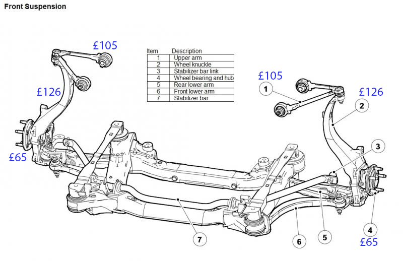

This is the bits I've bought so far for the front suspension in the picture below.
I started out hoping for about £1000 but this soon turned to wishful thinking.
The four shocks have only all done 58,000 and are totally knackered. Teach me for buying a car from a big city with severely ruined roads, London. I have to drive on some bad roads around here at 30 lately, instead of 60 as the shocks are bouncing constantly on springs.
I see Milton Keynes is the nearest Garage ramp rental to me so will go one day soon and get the front shocks swapped over. I do not want to do these with the car on the floor as I want to use the ramp to start letting them activate before I start to put full weight on the new units as is meant to be done.
I still have to make up my mind whether to replace entire arms for bottom new or swap out the bushes. I am leaning more to swapping out the three on the rear straight arm as the new arm is a lot of money compared to the other bits.

I bought new upper wishbones which have new bushes and ball-joints fitted.
The wheel knuckles I tracked down are new original jaguar ones which have new ball-joints. I don't know if I was lucky to get them at £126 each side as I'm sure Jaguar would try to charge £400 each no doubt.

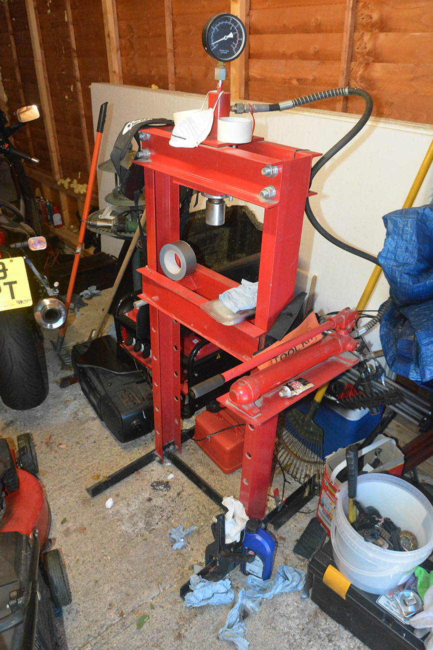

I bought a 12 tonne Hydraulic bench press very cheap from a friend who owns a classic car restoration garage not far from me so this steered me in the direction of may-be just swapping out the three bushes on the lower rear front arm that the wheel knuckle sits on.
He has refused every time to take my car and do the work I want as he knows I'm severely disabled with brain damage and he forces me to get angry so as I force myself to do the work. He does this deliberately to get me to try to do things that are getting beyond me. I was a qualified mechanic along with a few other things in life but recently suffered a severe accident that has restricted me entirely in what I can do movement wise now.
