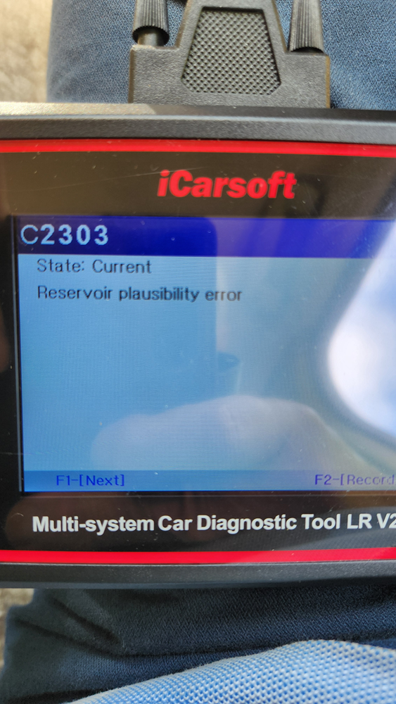

Continuing on my journey to saneness with my Jag the Air Suspension Fault pops up sporadically. My iCarsoft tells me It is the RESERVOIR PLAUSIBILTY ERROR. I have checked all the air connections around the tank and manifold with soapy water but no indications of an air leak.
What do I do next ?

That error is so vague as to be nearly useless. All it tells you is that pressure is not coming up as expected, but no indication of why. Bad compressor, a leak, bad valve somewhere, I don't know if there's a way to test the compressor outside the car, just to see how much pressure it can build into an attached tank, but it could well be simply a bad compressor. Replacing it and still having the problem because the cause is something else would be frustrating, and expensive.
You're at the point that I was when I said *BLEEP it* and ordered coilovers. The air system is nice, if it works, but it's O-L-D, and well past its design lifetime.

I am stubborn and would not ditch the system yet. I also do not agree to the statement that the system is past its design lifetime.
Unfortunately,same as the error code itself is vague, also the description and possible causes for the fault code are very vague in the manual:
So, I would suggest to widen the search for a leak to the parts that you have not checked yet.
