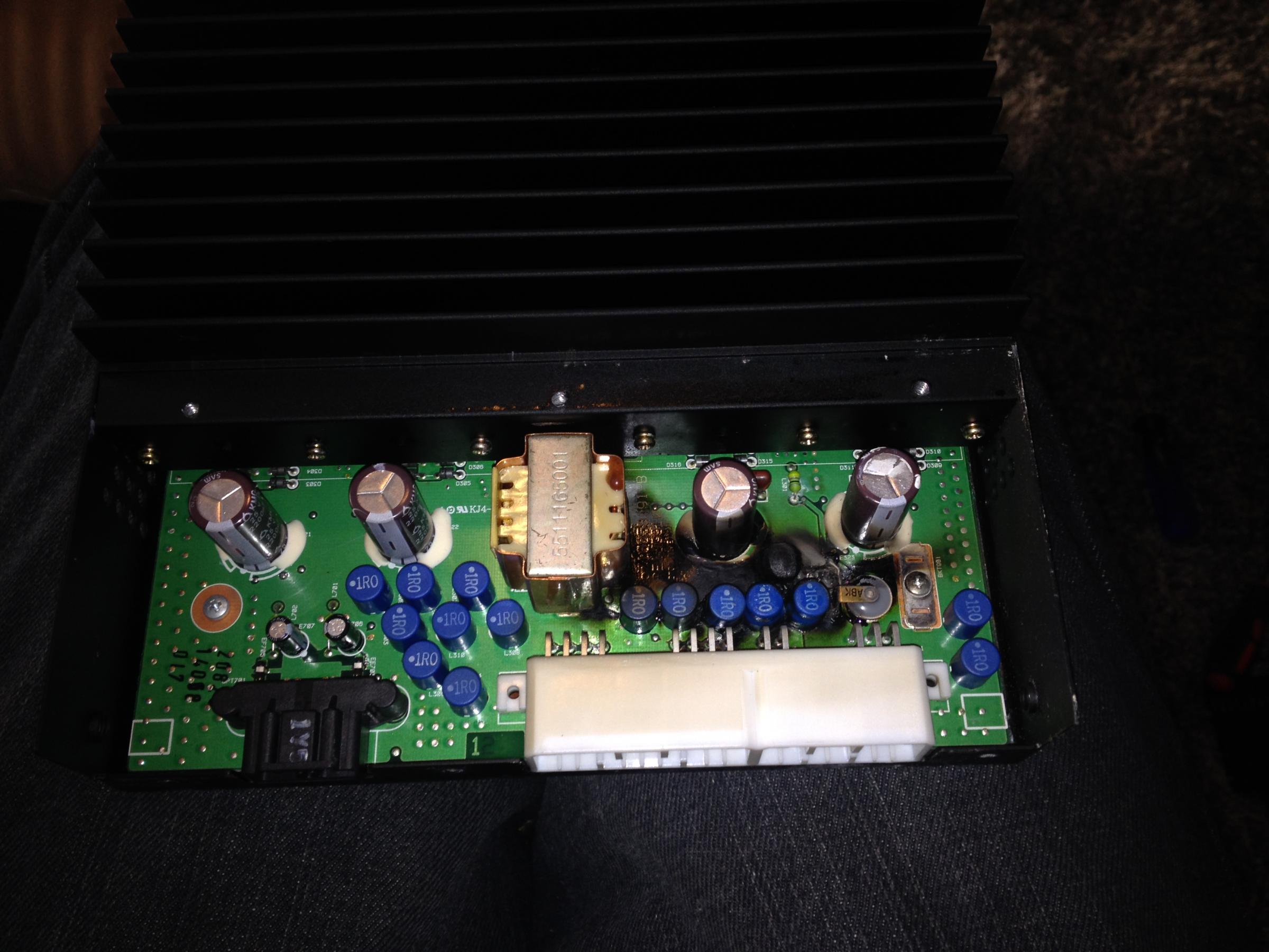

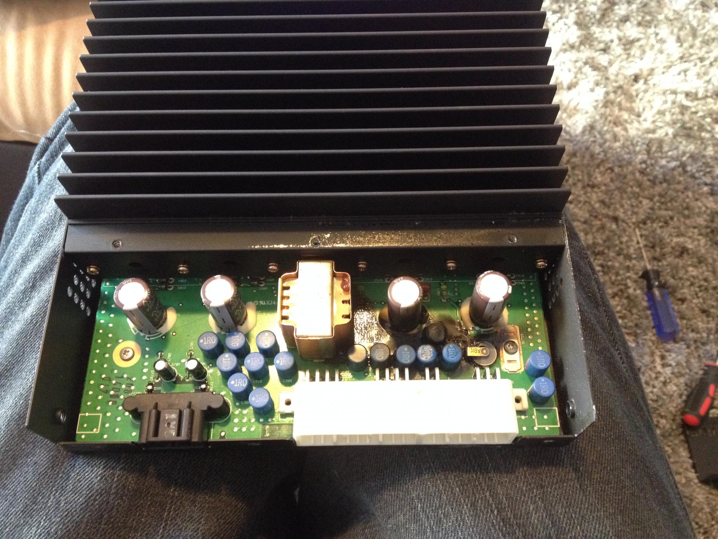

I think I found the culprit and source of the melted plasticky smell. See pics of the amp below. Is there an easy way to convert to standard audio without the amp? Don't know how long I can last without the radio.

Converting to standard audio, means re-routing the speaker cables to the front unit, which is PITA.
Cheaper to get a used amp off eBay:

Yeah, just checked out the schematics between standard and premium. Oh well. On the flip side I now have an itch to upgrade the system. Maybe a poor boys version of H2Oboy's setup. Christmas and Tax season are around the corner!
