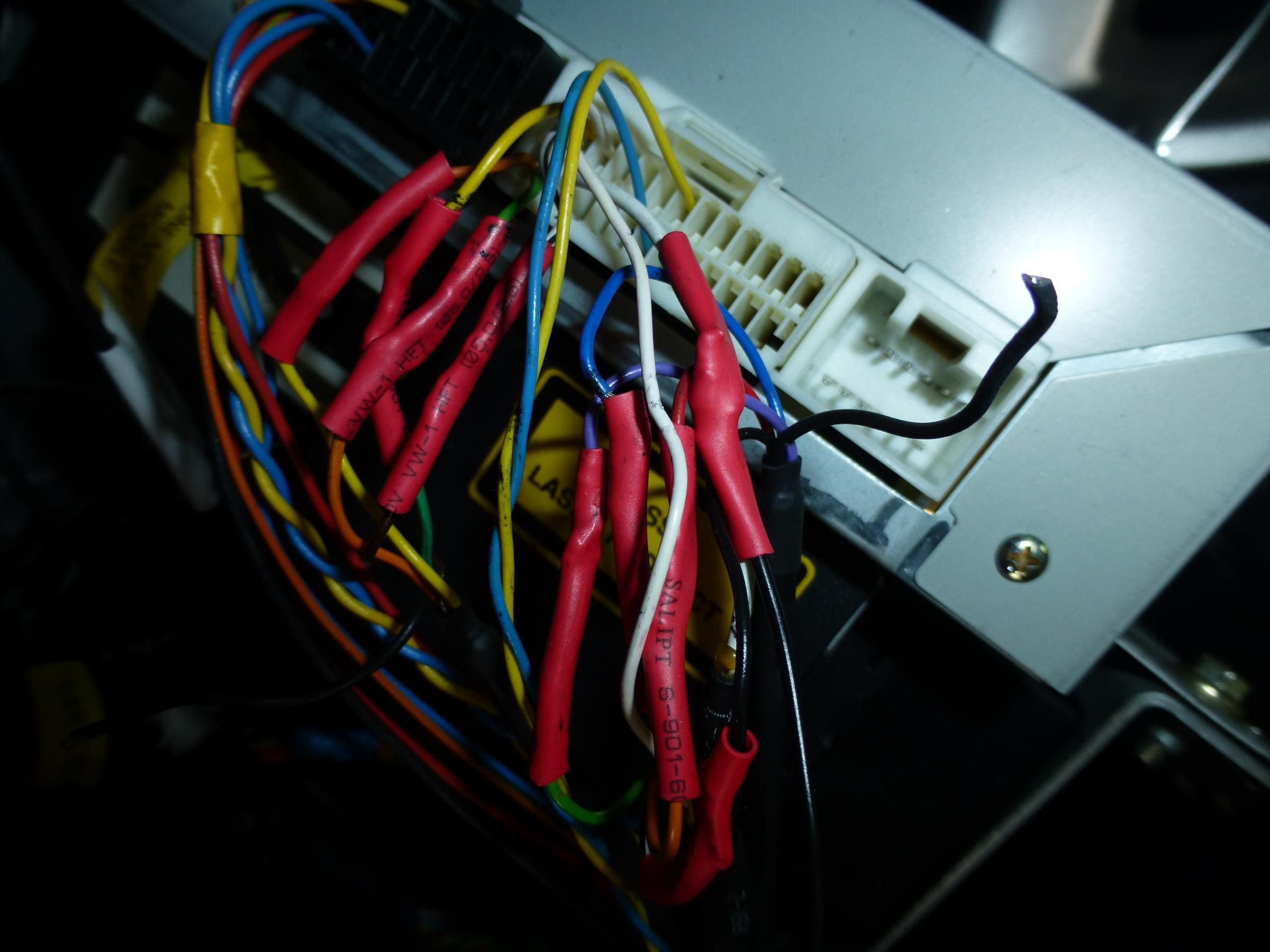

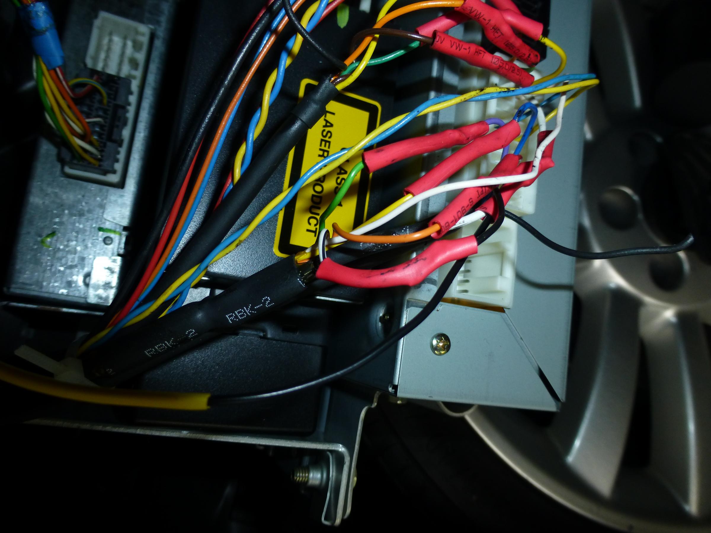

Have a look at these pics I took. Maybe they will help. The two THIN black wires I did not connect at all.
I found a switched positive wire on the right hand side of the boot/trunk in a connector that was spare.
Attached Thumbnails Backup Camera installation-p1060558.jpg   Backup Camera installation-p1060559.jpg   Backup Camera installation-p1060560.jpg   Backup Camera installation-p1060561.jpg   Backup Camera installation-p1060562.jpg

Default One last pic
If you look at the white multi pin connector at the back of the DVD player with the release tab on top then:
From one Navtool bundle of wires the Yellow goes to lower pin position 1, the green to upper position 1, the brown to lower position 2.
In lower position 3 the Jaguar white lead I spliced into with the separate Navtool black wire not part of the bundles.
From the 2nd Navtool bundle I wired the Blue to the yellow, green to purple, black and white striped to black, red to orange. The 2nd black I did not connect. I found out which black to connect by trial and error.

HELLO I DID THIS PICTURE, am i right ? i surely forgot something
Old May 21, 2015 | 05:16 PM
  #53
jackra_1's Avatar
Joined: Aug 2014
Posts: 6,264
Likes: 1,764
If the yellow rectangle in your pic is where the release tab is located. The following colors I mention are the Navtool wire colors.
Then the lower position 1 is where you have the yellow connected correctly.
The upper position 1 is where you have the brown wire connected which should be where the green wire is connected. The brown wire should go to lower position 2. So this bundle is wired into the DVD player.
The second bundle is wired into the wires that were cut going to the head unit.
From the 2nd Navtool bundle I wired the Navtool Blue to the cut yellow, Navtool purple to cut green , Navtool black to cut white/ black striped , RED to cut orange( ****RED from the bundle you have marked accessory***) The 2nd black I did not connect. I found out which black to connect by trial and error.
