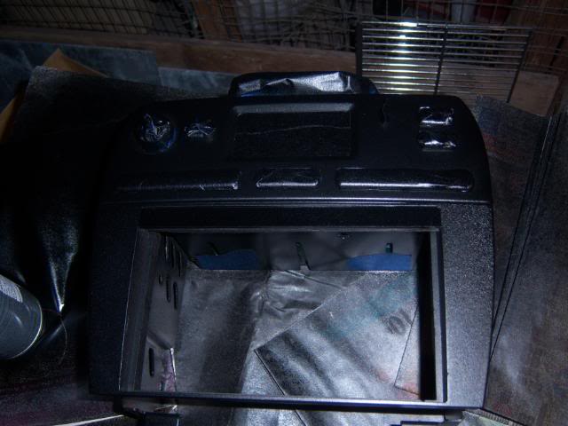

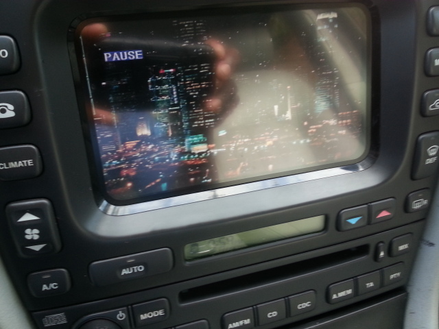

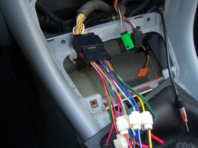

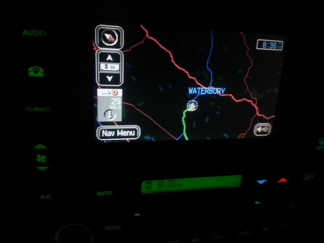

well i first installed a doubledin, which was cool it had all the bells and whistle
but then someone tried to break in and take it ,they had no such luck everthing is bolted down,
so now i thought let me try the stock touchsreen sat nav and add movie play back,and a backup camera, usb ETC,
so my first task was to locate all the parts and shematics heres some pic of what i had to get
i posted some of my past projects also
i hope i dont blind you guys with all these pics

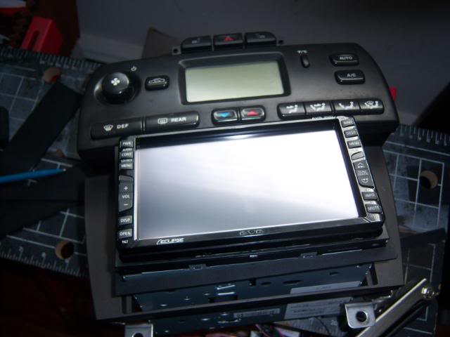

what you see is the touch sreen,
harness ,
remote climate controll unit,
dvd rom drive,
gps antenna
optical link
the piece above is the remote climate controll unit the hardest part to get,i got lucky i have 2
it fit perfect in the side

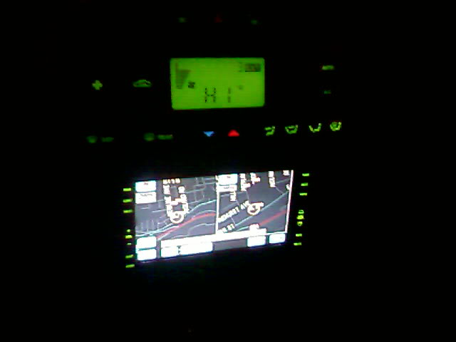

heres some pics of install
started wiring things up

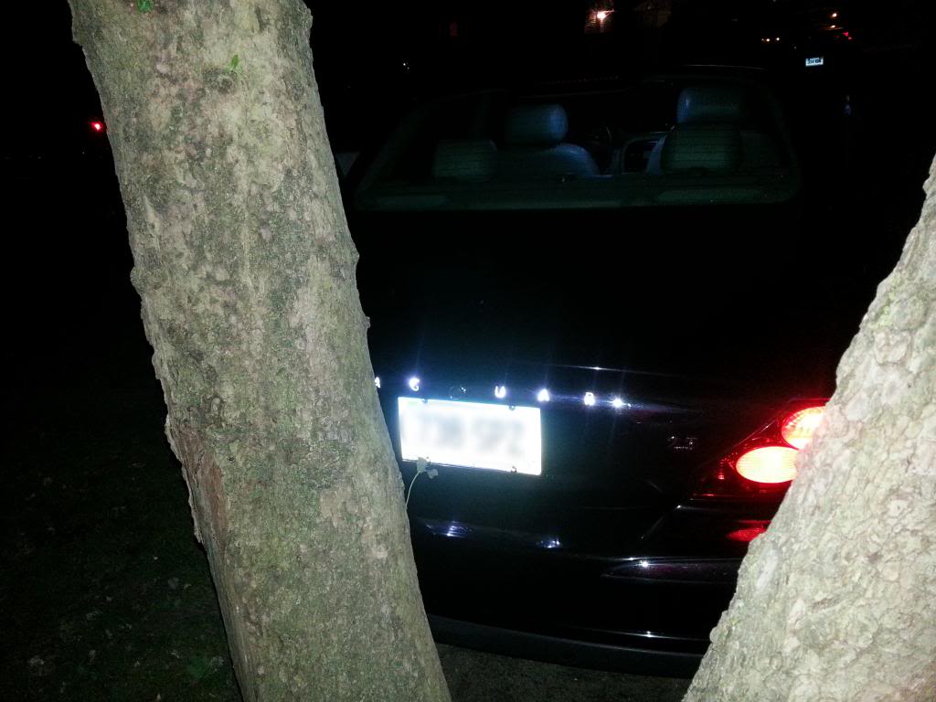

backup camera at night

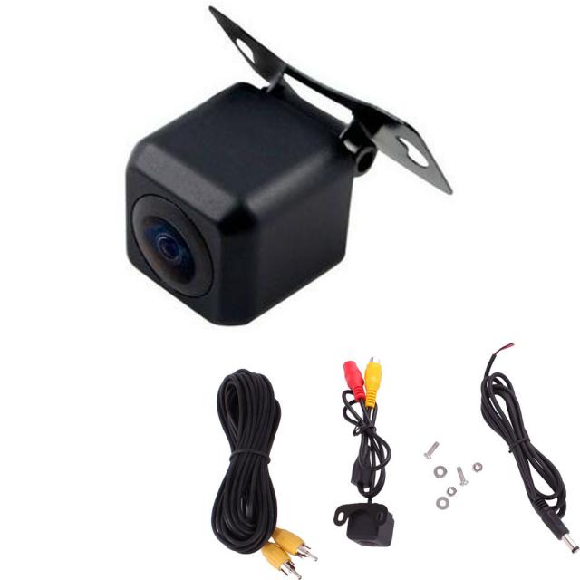

for the backup camera you tap into our rear light plug the grean and black wire
phone btooth working

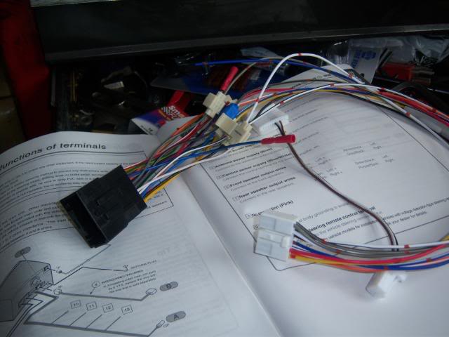

heres some of te plugs i orded

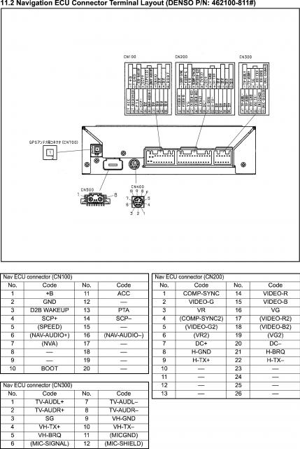

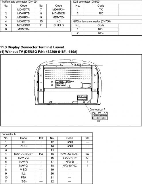

heres some of the schematics if you want to try it yourself
this diagram is from dave x thanks bud
look in that mess of wires is the navtool thats what you need to play movies and backup camera of course i straightened up the wiring neatly
heres the button i switch between movies and navigation
heres the audio modulator

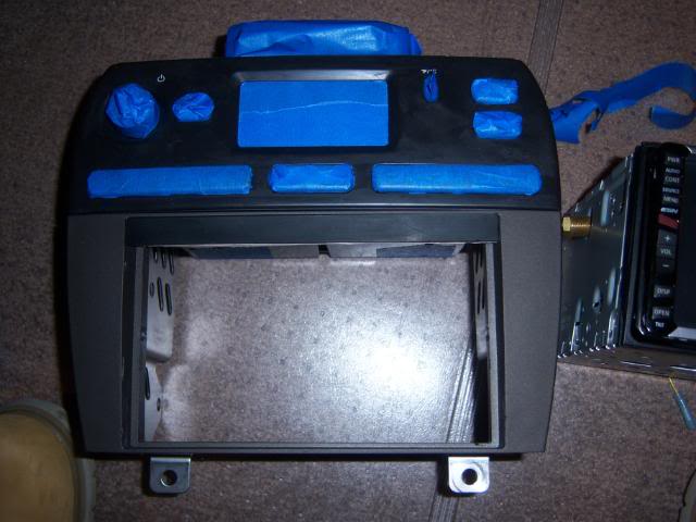

this was my double din install youve seen before
WRITE UP TO ADD BACK UP CAMERA AND MOVIES TO SAT NAV
PARTS NEEDED
NAVTOOL i paid $150 on ebay
BACKUP CAMERA i paid $12 ebay
DVD PLAYER i paid $79 for a soundstream one ,i changed the boss one i had
in the diagram all you have to do is cut the four wires in the diagram
on the navtool theres also a acc wire to be hooked up and the backup camera
i made these diagrams to help you guys out when you get the navtool you will see all the wires matchup to my diagram
the diagram they give you is no good , i figured it out for you guys

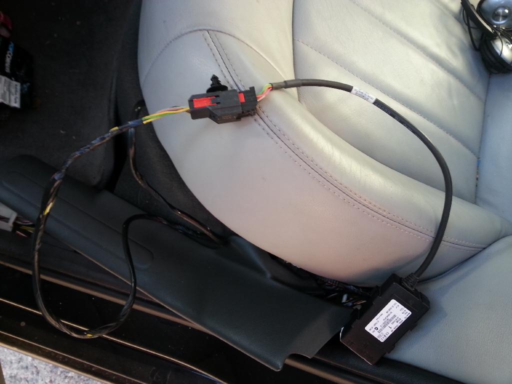

heres the bluetooth and voice modules connected
heres the harness
running the bluetooth module under the carpet
putting the harness under the carpet is a bitch
PLUS I FOUND SOME M&MS under the console lol
this is what you need for bluetooth and voice intergration

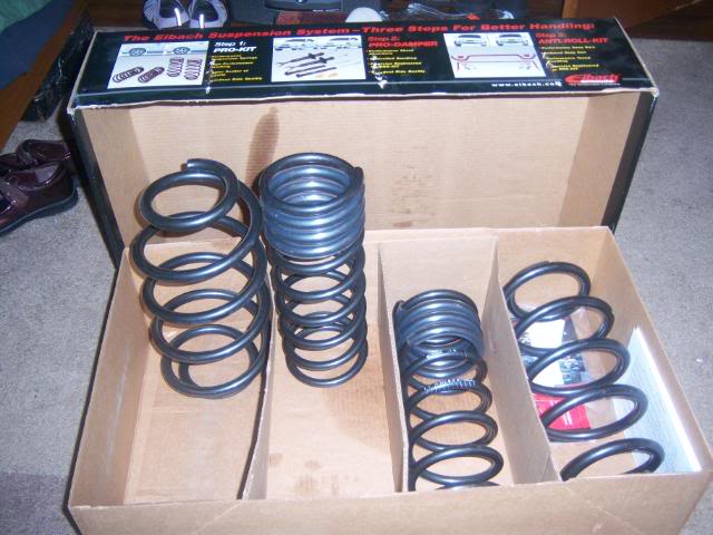

lowering springs

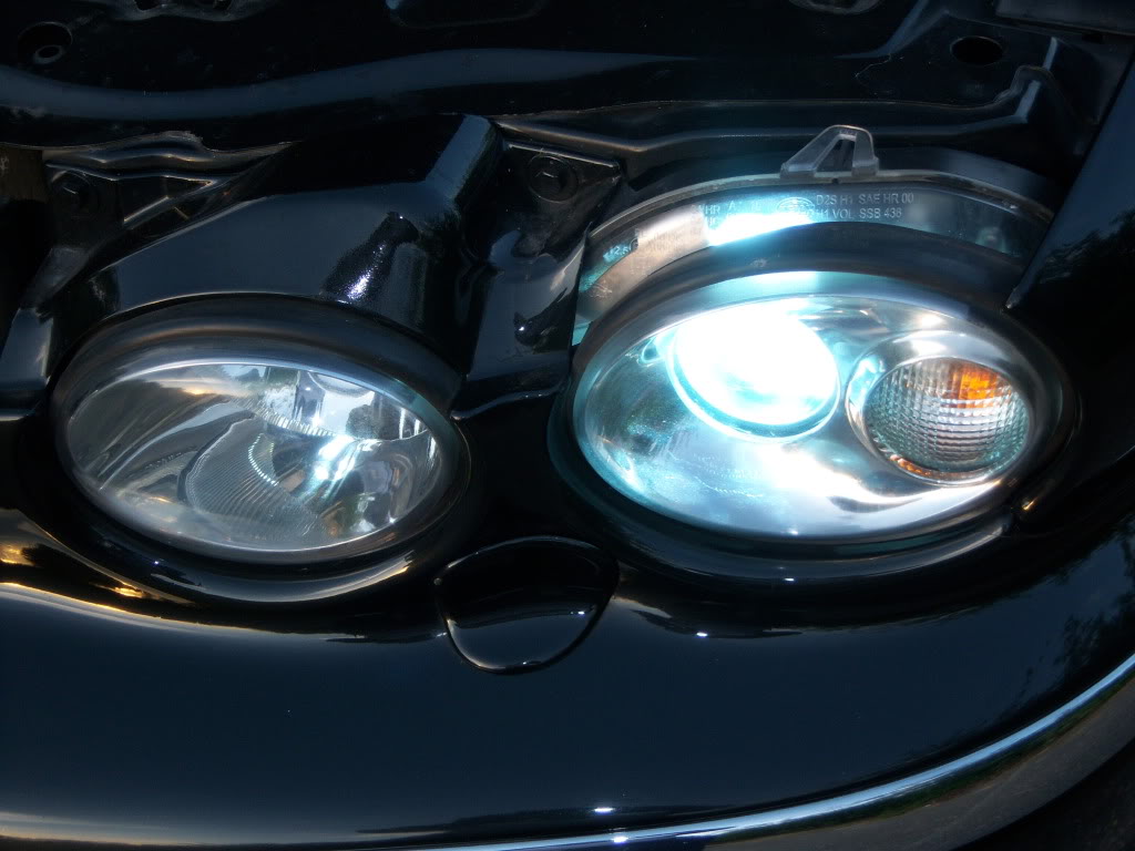

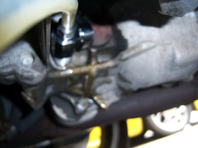

Default painted armrest remover cracked one
hid conversion
transfer case fluid change

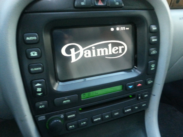

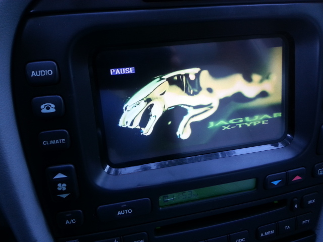

Default to get daimler logo
to get the daimler log first hold the menu and phone buttons together dont let go untill you see this screen
punch in the code 1971
then you will see this screen
then hit the misc button
you will see this
now hit sytem options ,you will see this
now hit the daimler button then go back
to logo screen
thats it
beware never hit system update or any update you will have a black screen
i hope that helps skinny

Thank you very much Dennis. I've been to the settings menu several times, but using the "917" code. Turns out, it offers other options than "1971." Shame we can't use custom images for the logo screen.
