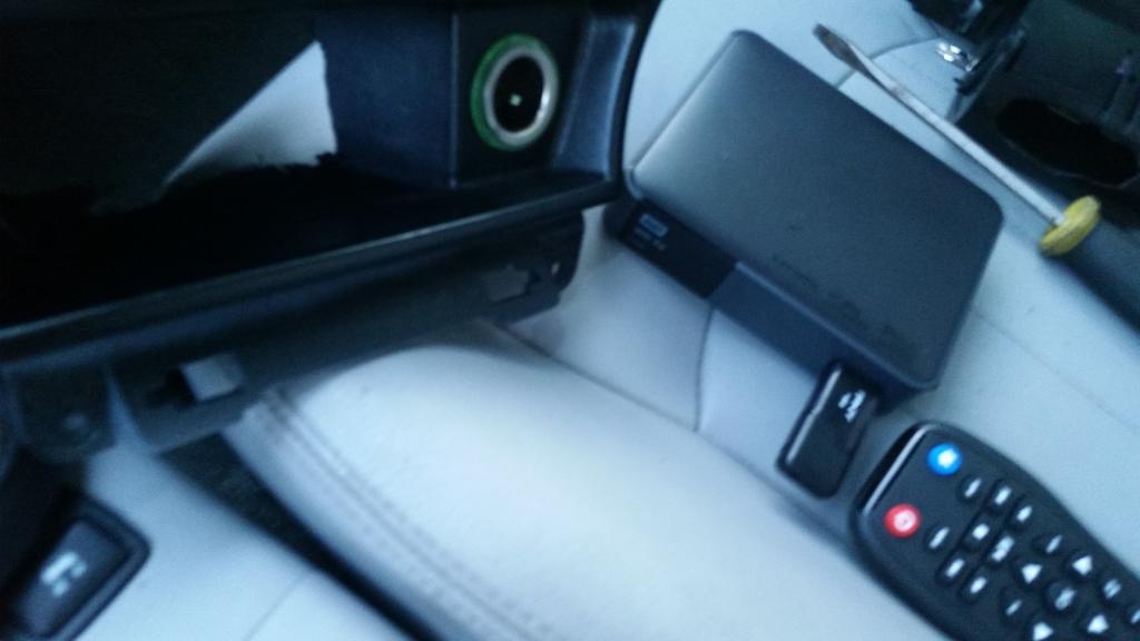

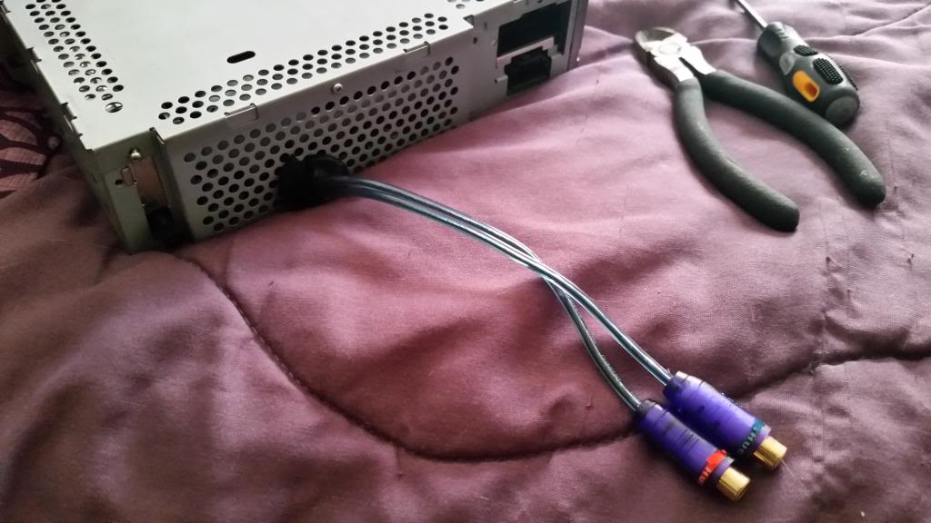

this is the box i used wdtv ,with screen mirroring
Size:  26.0 KBName:  20140712_201435_zpsxkyhsdac.jpg

nice,on my set up im able to swtch from android to wdtv
